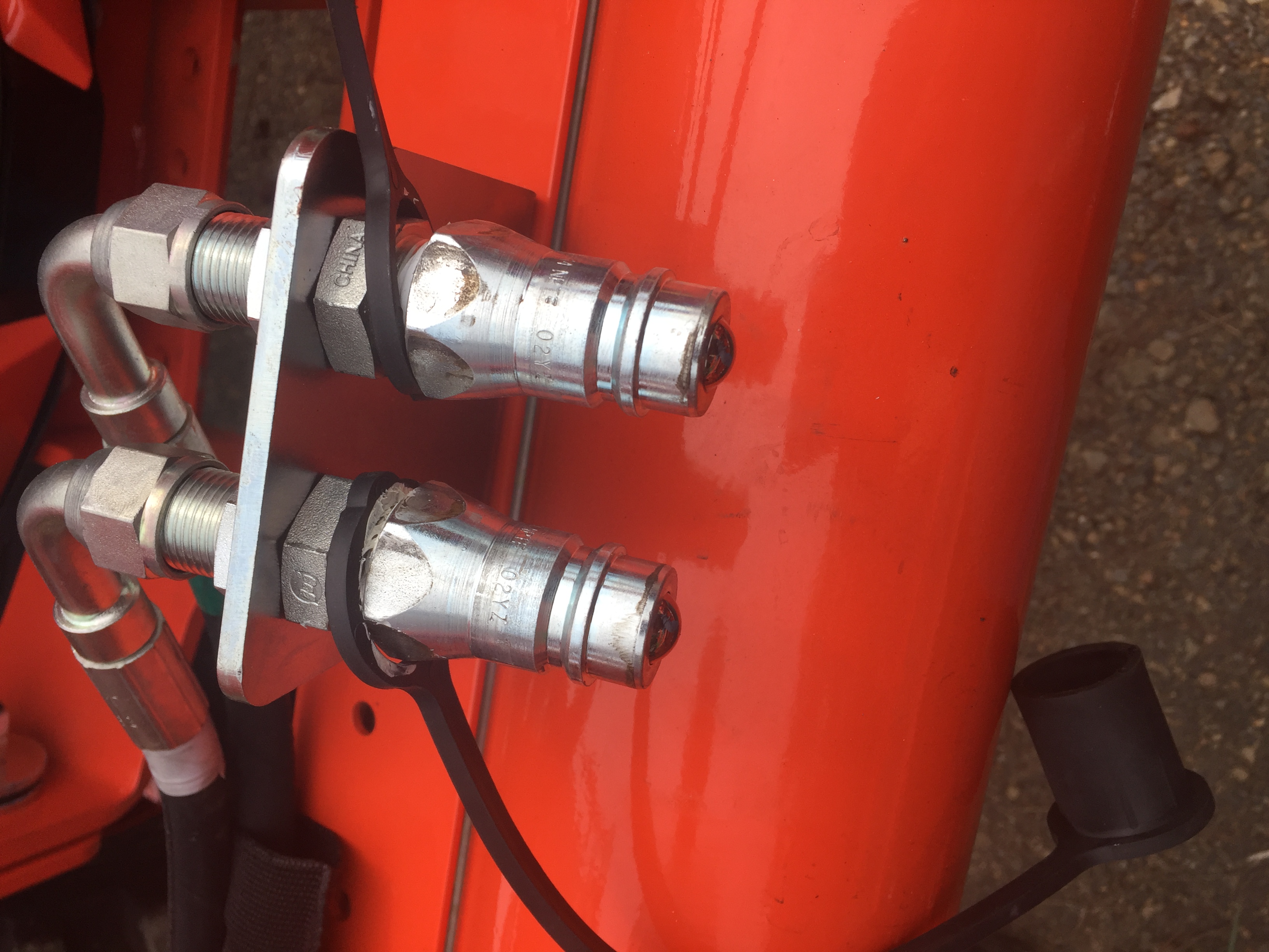

What does the Kubota 3rd function kit come with as far as adapters for the attachments..
My tractor came with these on the front,is this correct?

I honestly don't know if there is a "correct" way to terminate hydraulic hose from a third function install. I had my dealer install the third function(WR Long) for my grapple and the hydraulic hose terminates with male connectors, just like yours. The ends go thru and are held by a stand-off bracket and there are rubber caps to cover the ends when not in use. Obviously, since the dealer installed the grapple - the male & female ends are going to be compatible. Will the male fittings be compatible with any other "front end" implement I might purchase that needs third function abilities........it would seem obvious but unless one actually "made" physical connection there could be incompatibility. However, this would simply mean having new female connectors put on the new implement.
So... I think yours is correct. The bigger concern is trying to determine what size, type & "shape" those two male connectors are so you can get matching female connectors for whatever you want to connect to it. I would start by asking your dealer what type, size, etc, etc those male connectors are..............

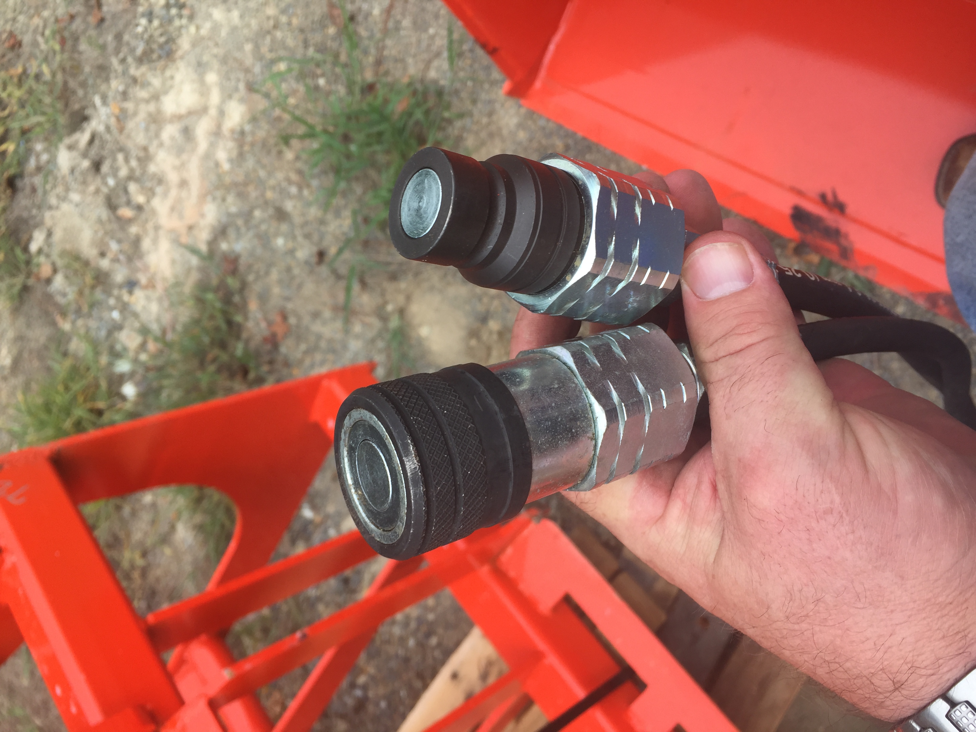

   / Kubota front loader 3rd function adapters for attachments on the front?
This is what came on my grapple..
Those look like they could be "connect under pressure". If you can predict which side of the circuit retains or builds more residual pressure, but the male connector on that side. For some reason the males work better.
