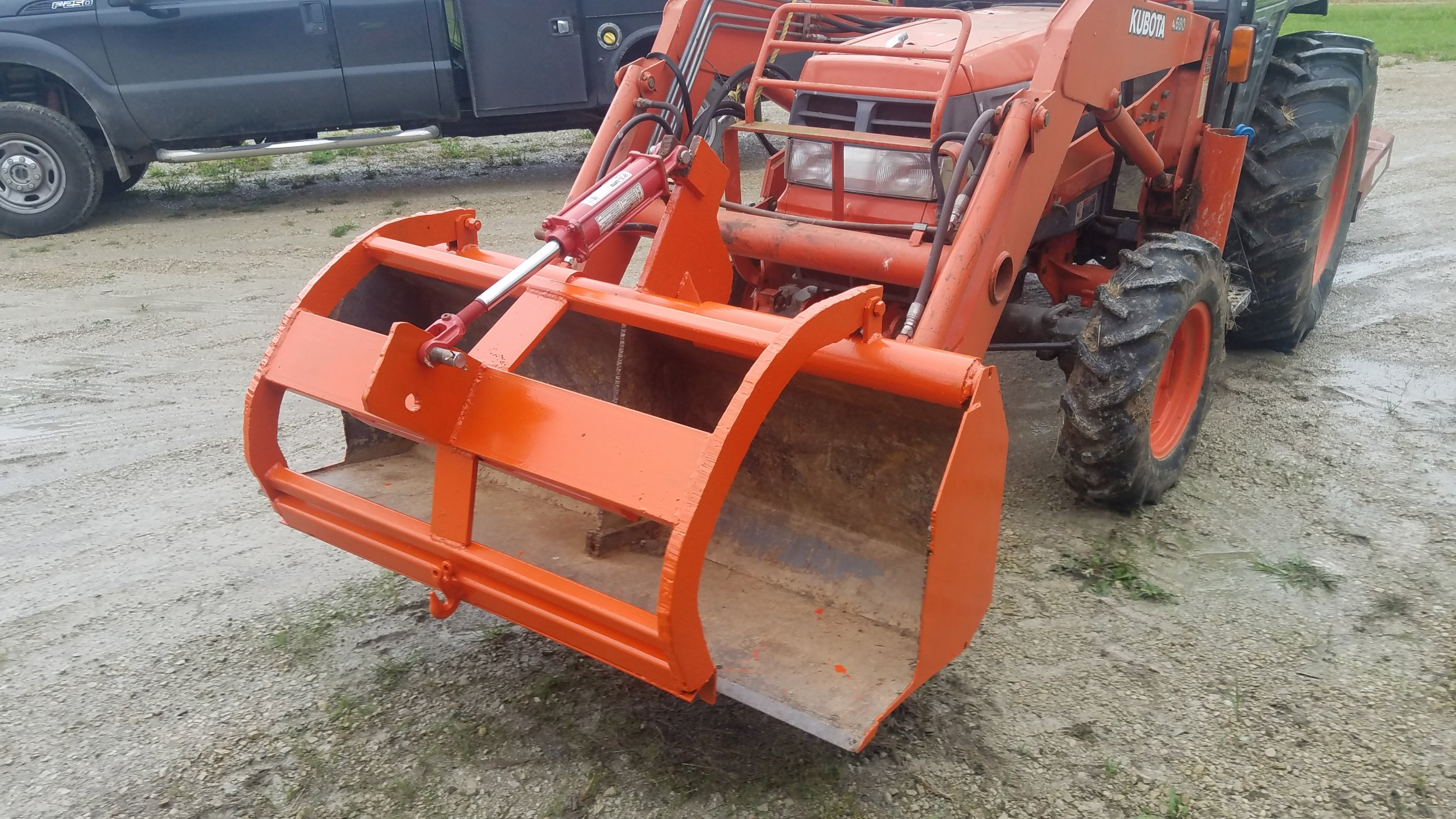

You will most likely need to beef up / extra support of the top lip of the bucket. Not sure if just a backer plate is enough.
/ Kubota front loader thumb DIY #6
Most light duty 'material buckets' lack sufficient material on the top edge to contain the clamping force without deforming. That also applies to bolt on or weld on bucket hooks. It's imperative that they be place in line with the bolsters that the loader arms attach to or you'll bend the top of the bucket with picking up anything with the bucket hooks.
All tractor manufacturers that I know of offer different buckets, from material handling (single bottom sheets and press brake bent tops) to heavy duty excavation style buckets with replaceable wear edges, double bottom sheets with reinforcing gussets that will accept bucket hooks just about anywhere without deforming. I have both and use them for their respective tasks.
When you buy a new unit, they usually come with a light duty material bucket but you can opt into a HD bucket instead.
/ Kubota front loader thumb DIY #7
I have a Kubota B3350 with a front bucket. I would like to attach a " Thumb " to the bucket for holding brush or ? in the bucket. Has anyone fabricated and installed the hydraulics for operating the " Thumb " ?
/ Kubota front loader thumb DIY #8
Heres one I built a few years ago before I got a factory grapple I had to beef up the top of the bucket where it mounted
/ Kubota front loader thumb DIY #11
I built one on my L2850 a few years back, the bucket needed several "upgrades" to the top of it as it kept bending/distorting with use. The biggest problem I found with the thumb on the bucket was you couldn't see what you were doing. I also added some short "forks" to the inside corners of the bucket, they stuck our about 10" and made a huge difference, they were just bolted in the corners.
