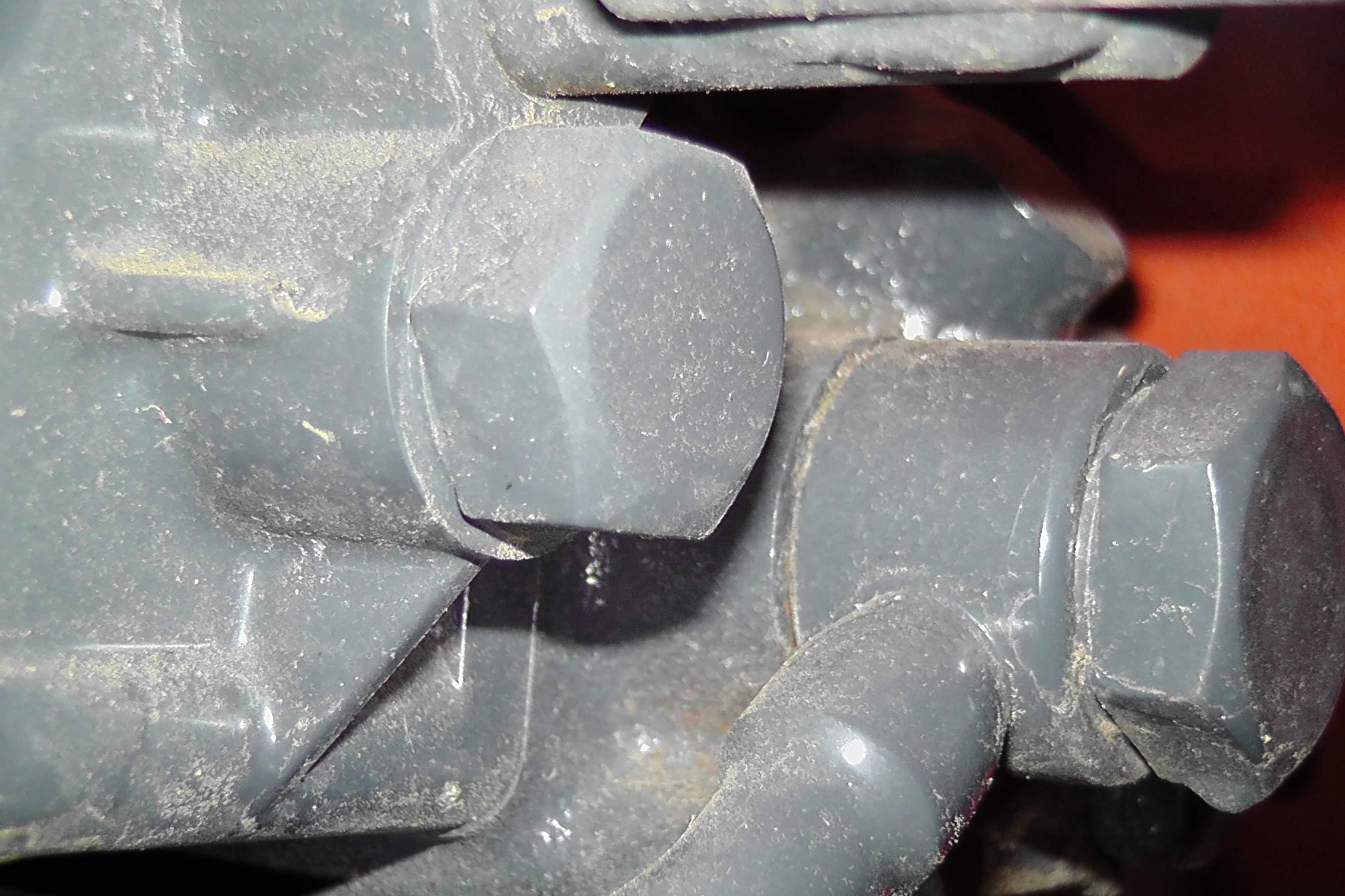

I would like to purchase a hydraulic cylinder and fabricate a 3 pt type hitch or sleeve hitch for the rear of my G1900. The 3 pt hitch option schematic shows a hydraulic line going to the inboard side of the hydraulic control valve and attaches to a cylinder on the frame. My question is.....If I can hook a line to the inboard side of the hyd. control and attach to a cylinder in the rear, could I run a second control lever to work the new cylinder independently? Note: pic shows the outboard side of hyd, control valve. thanks.

Thanks Guys, JJ, I guess SA cal would be fine since gravity would lower the attachment. I don't have a lot of expierence with hydraulics, I was hoping to remove a few bolts and add some lines and be good to go, is this realistic? P.S. sorry about the pic. S1340031.jpg
