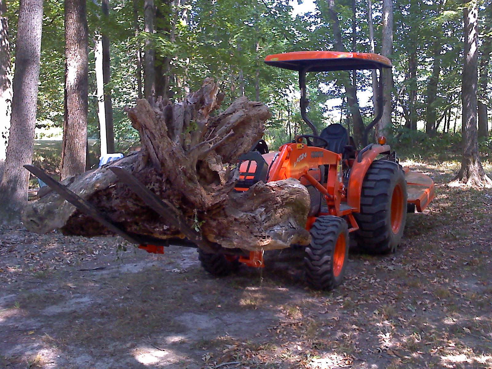

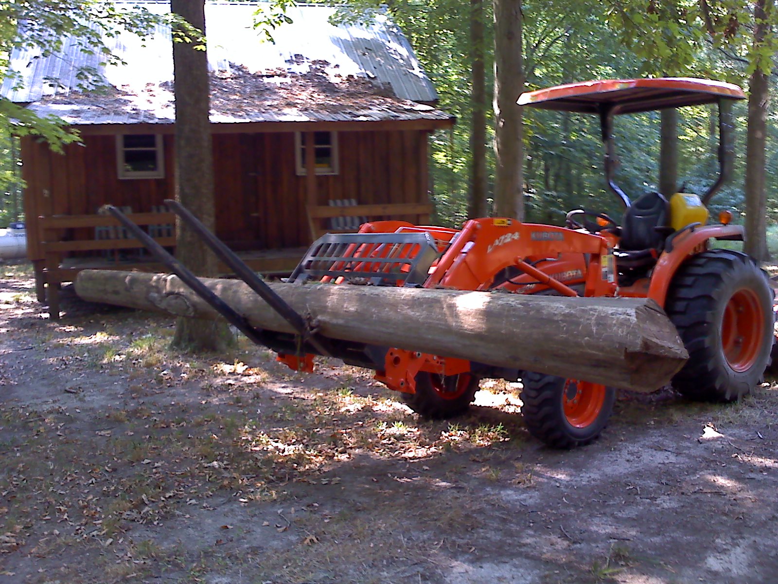

Don't know if you made a decision or not but thought I would show you a couple of pics from today. I can push over smaller trees and clean up rootwads and get rid of plenty of fallen trees with my 3540. So far I have loved mine in tight quarters and it has worked flawless. I worked my tractor hard pushing/clearing/mowing for 6 hours today and used a little less than 3 gallons of fuel. I contribute this mostly to the HST+ tranny. It is absolutley awesome and see several maufacturers following suite.

Thanks for the pictures...sure couldn't do that with a BX :) TMR
