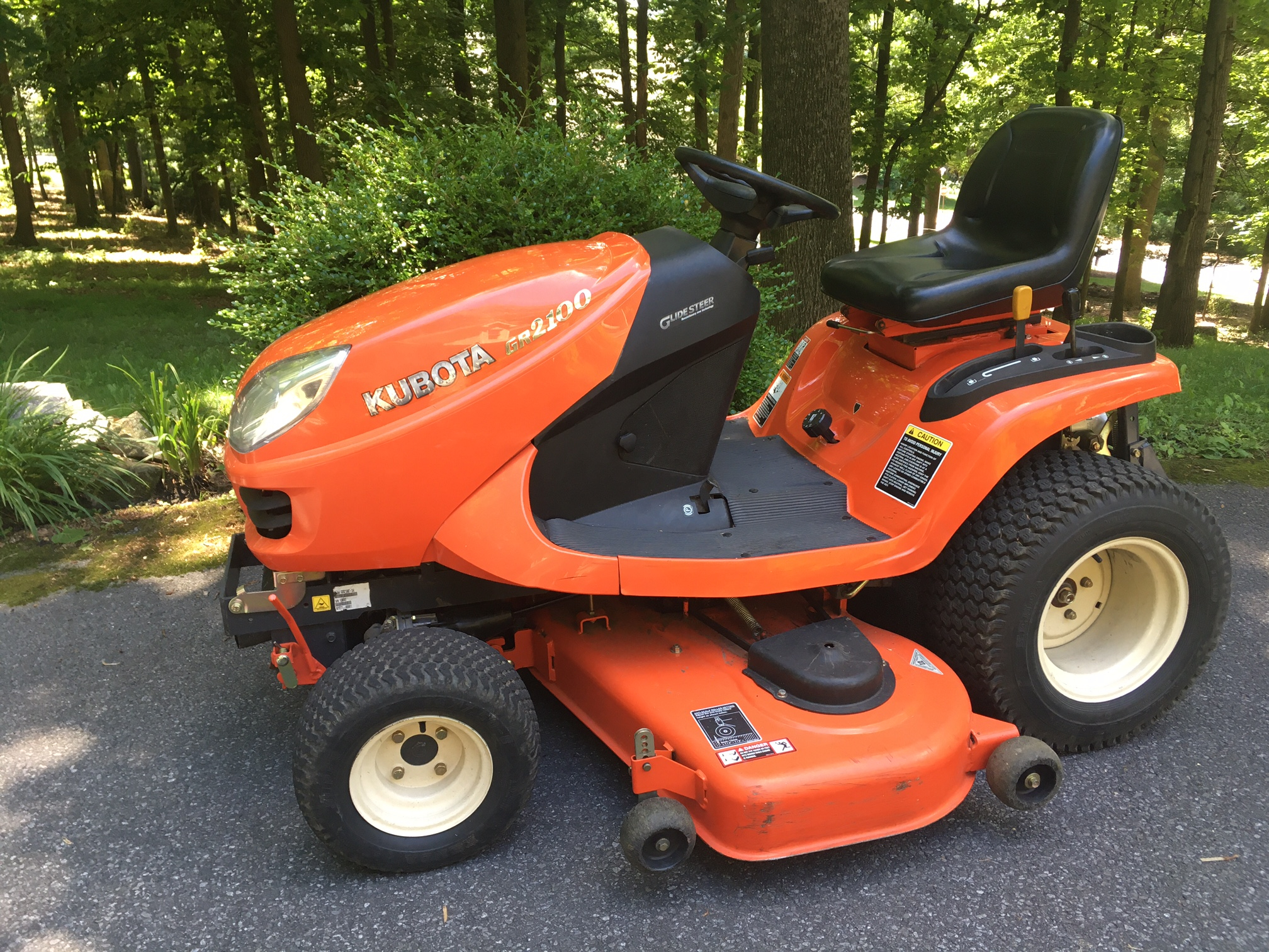

GR2100

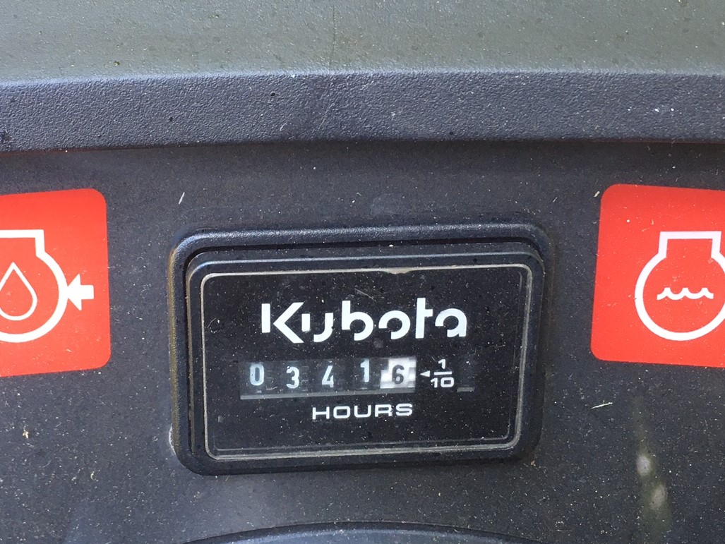

Our farm has 4 Kubota tractors and the smallest, this GR2100 Diesel 4WD, was purchased new in 2005 for $8200 at Messick Farm Supply. At only 326 Hours the rear axle assembly has failed, making it a front wheel drive only. The dealer diagnosed the failure.
Rather then repair an inferior design, a completely new rear axle assembly is recommended by the Kubota dealer, because there was a redesign for a shortcoming in the first generation.
Let's see...the new axle assembly installed is quoted by the dealer at near $5,000 - for a tractor with only 326 hours. So I inquired about trading it in for a new Kubota, and that results in a trade-in credit of $6,000 (once the $5,000 is invested), a $1,000 present value parts tractor for a Kubota with 326 hours. I loaded the unit onto my trailer and departed for other options.
A writing to Kubota Customer Satisfaction in Grapevine, TX with all documentation, resulted in an "out of warranty" form letter. If my options remains as is, unloading the defective tractor for parts and buying a new "non-Kubota" seems like the only responsible option. I suspect there may be rebuilders of the original axle, but who wants to rebuild a faulty design.
I'm open for suggestions!

Any good auto or truck mechanic should have no problem rebuilding it. You need to buy a shop manual for that tractor, to provide to whomever does the work. If you are mechanically inclined, that should not be out of the realm of you doing it, perhaps with a friend.
Buy a shop manual, which should show every detail of the entire assembly including parts breakdown with part numbers.

Do not mess with the old tranny. Haggle with your dealer to replace it with a new one or find another dealer for a quote. I replaced one recently for 3800 installed. 3200 for the unit and 600 labor. This is your least expensive option.

17 years may sound impressive, but is pretty meaningless - it actually lasted only 326 hour of use!
