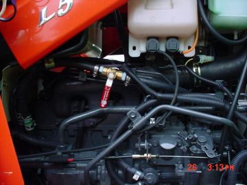

Patrick:
Here is what I did. I added shrouds per se' on each side of the evap, extending back to the radiator screen. I also added the WOG valve. It's about 90 and VERY humid here today. With the tractor idiling in the sun, the temperature got down to 61 degrees in the cab. The condenser in the roof is putting out water like nobody's business. It's uncomfortable to hold your hand in front of the windshield vents for longer than a few minutes. I had to back the temperature control down a bit to even the temp at 72 degrees and the compressor is NOT cycling very much, it just stays engaged. It looks a bit cobbly in the pictures, but it WORKS FINE. I had to be careful where I drilled the holes in the brackets on the sides of the oil cooler so as not to interfere with the hoses. Other than that, it's a snap. It's obvious that the concentrated airflow through the evaporator does the trick. I must have been leaking a little coolant through the control valve too. With the WOG valve on the input line, no coolant gets to the heater core. Just like my big truck now.

   / Kubota Grand L 4610HSTC A/C #30
Here is a picture of the WOG valve. It's a 3/8 inch, 1/4 turn. I used nylon barbs with 3/8 pipe thread ends threaded into the valve. The line in the picture is the feed line for the heater core in the cab.
This setup really concentrates the air through the evaporator. It also increases the airflow through the oil cooler too. That's an added benefit as the 5030 generates alot of heat in the UDT fluid with the hydro.
