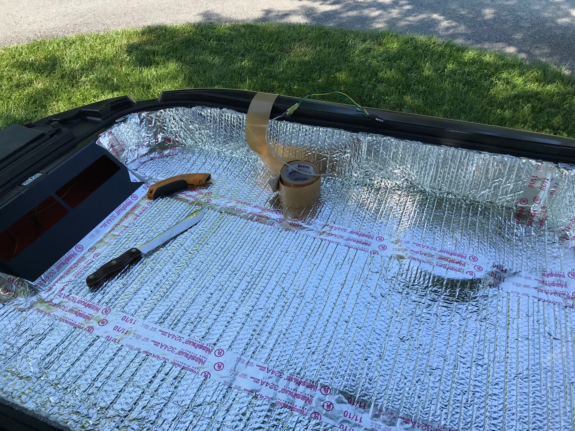

The thermometer shows the discharge temp in the L4240 before lining the roof. It didn't change following the lining, but it seems to have made a difference. Best comfort on really hot days is had by keeping the fresh air closed and running the fan on medium. It's also possible I'm imagining it:)
EDIT TO ADD - When I bought the 4240 it had a band of tint at the top of the windshield and doors. First thing I did was remove it. The factory tint is sufficient for me, and I doubt that added tint would be welcome at night. I'm not aware of any aftermarket tint that doesn't eventually get scratched up.
