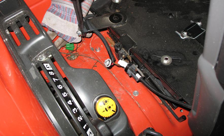

I have the little yellow knob you turn to the right for "on" (see below). It feels like a switch that can't be feathered ... just on or off. Maybe I'm wrong?
Yours must be a different yeat than my '10, if you have PTO "lever"?
(Ignore my un-plugged seat switch; I would "never" knowingly bypass a safety switch. Or would I?!? :confused2: ...:laughing:)
attachment.php
I do have a cab but it is hard to believe the PTO would be any different.
Mine has a cable down to a lever on the trans to engage.
Have you looked to be sure yours is an electric switch?
Mine is in the same are but a lever that moves fore & aft, on a 2007 model.
No, I haven't ... but I just looked at my manual, & the section is called "PTO Clutch Control Switch", & it says "The PTO clutch control switch engages or disengages the PTO clutch which gives the PTO independent control." Also "Turn the switch to "ON" to engage the PTO clutch. Turn the switch "OFF" to disengage the PTO clutch."

To answer the first question about why you can not turn the shaft 360 degrees with the engine dead is, yes, there is a brake on the PTO shaft. It is spring applied and the 120 degrees or so that you can turn it is so you can hook up a PTO shaft with the engine dead.
You would never want to work on a running tractor and attempt to hook up a PTO shaft or you should pick out your headstone now.
The PTO engagement control on the new Grand L40s (-3) are now electrohydraulic meaning the yellow knob really is a switch that fires a coil to open the hydraulic flow to the PTO pack instead of a manual controlled valve doing the same thing.
