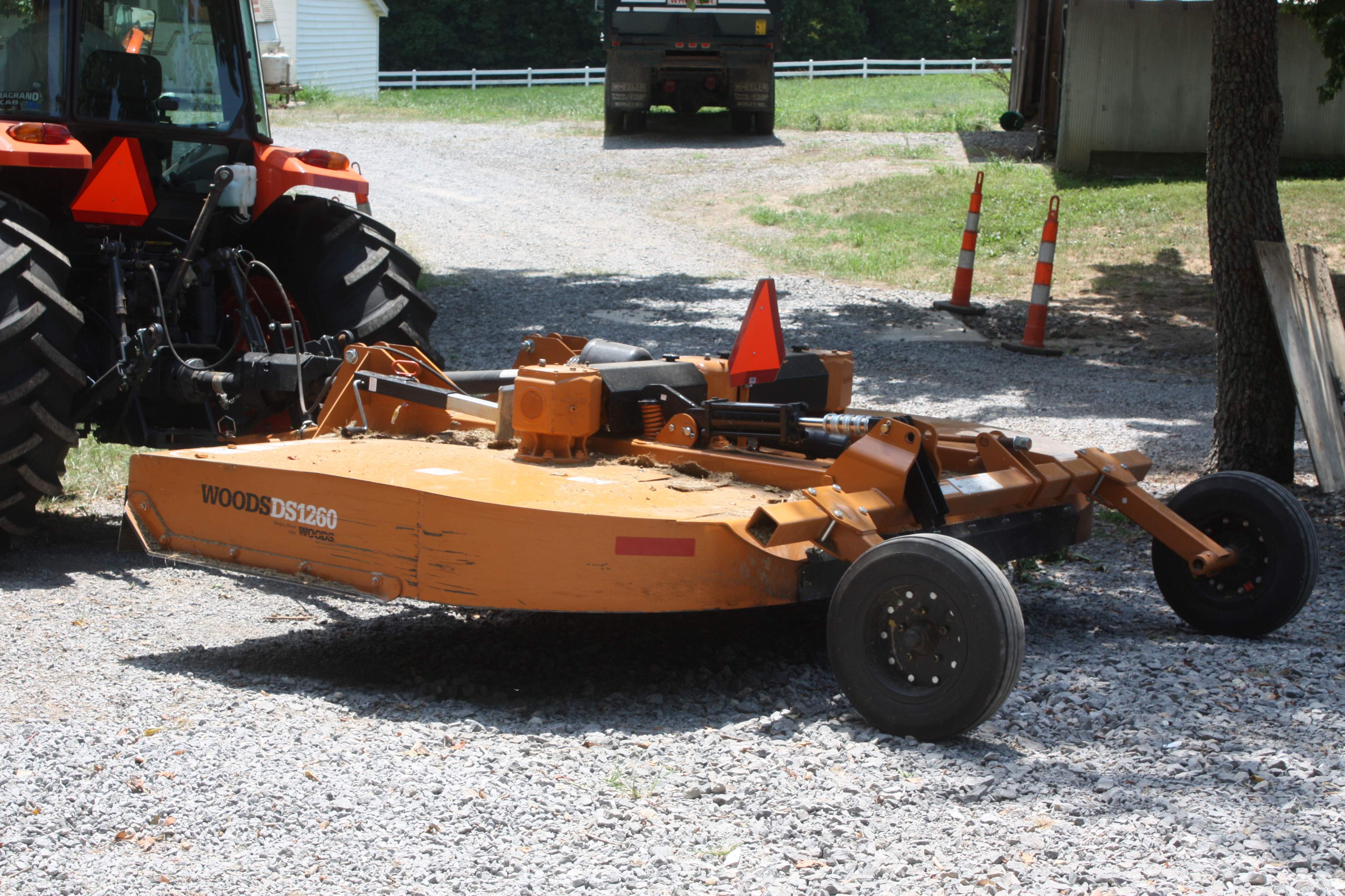

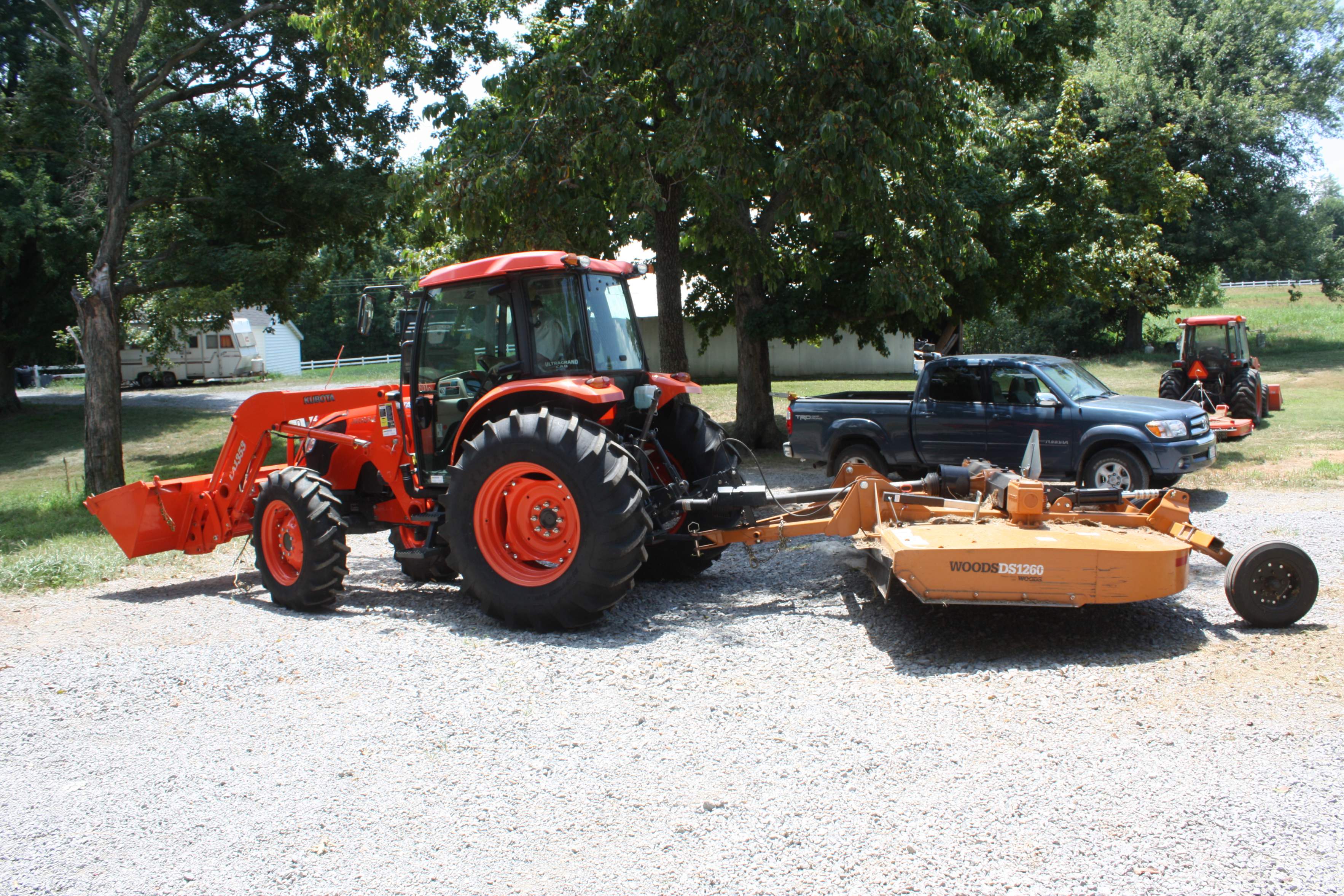

We have an L5740HSTC and M8540HDC 12/12 hydraulic shuttle shift. I am a bit slower moving rock, dirt etc. with the M8540, (bad left arm and leg) but my sons and brother can go bucket for bucket on either.
If you can swing it financially, I'd forget the 7' and go with a 8' twin spindle at a minimum, we use a Woods DS1260 on ours.
