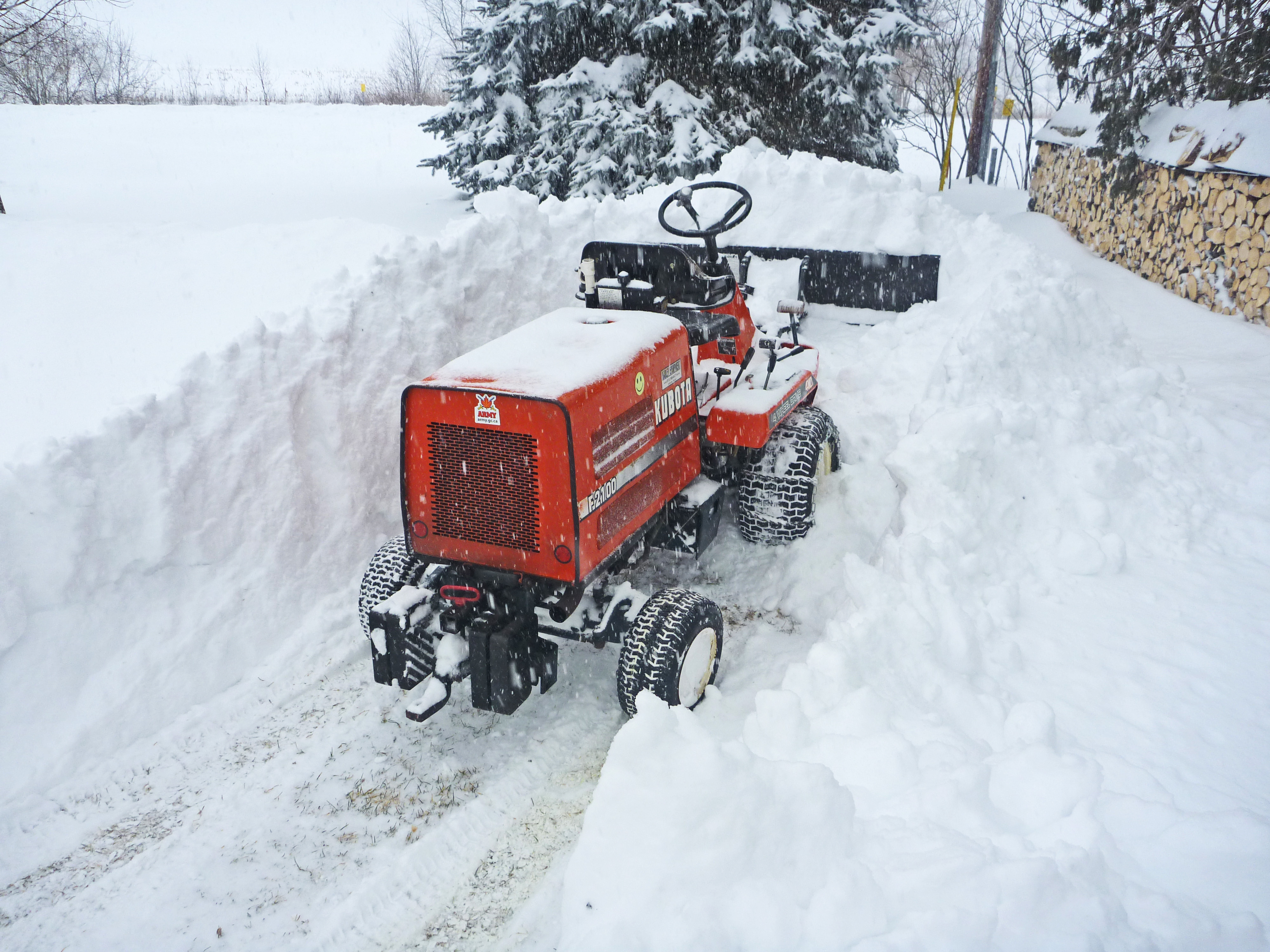

I'm shocked you get along with those turf tires in that terrain and envirnoment. Snow, maybe not so bad, but turfs and mud don't get along.
I had a pretty heavy duty Gravely walk behind. It too wore out the wheel hubs, that went on splined axle shafts. I guess castings are pretty soft by comparison to the hardened shaft.
4Wd, a diff lock, and occasionally chains on the front tires, really helps.
