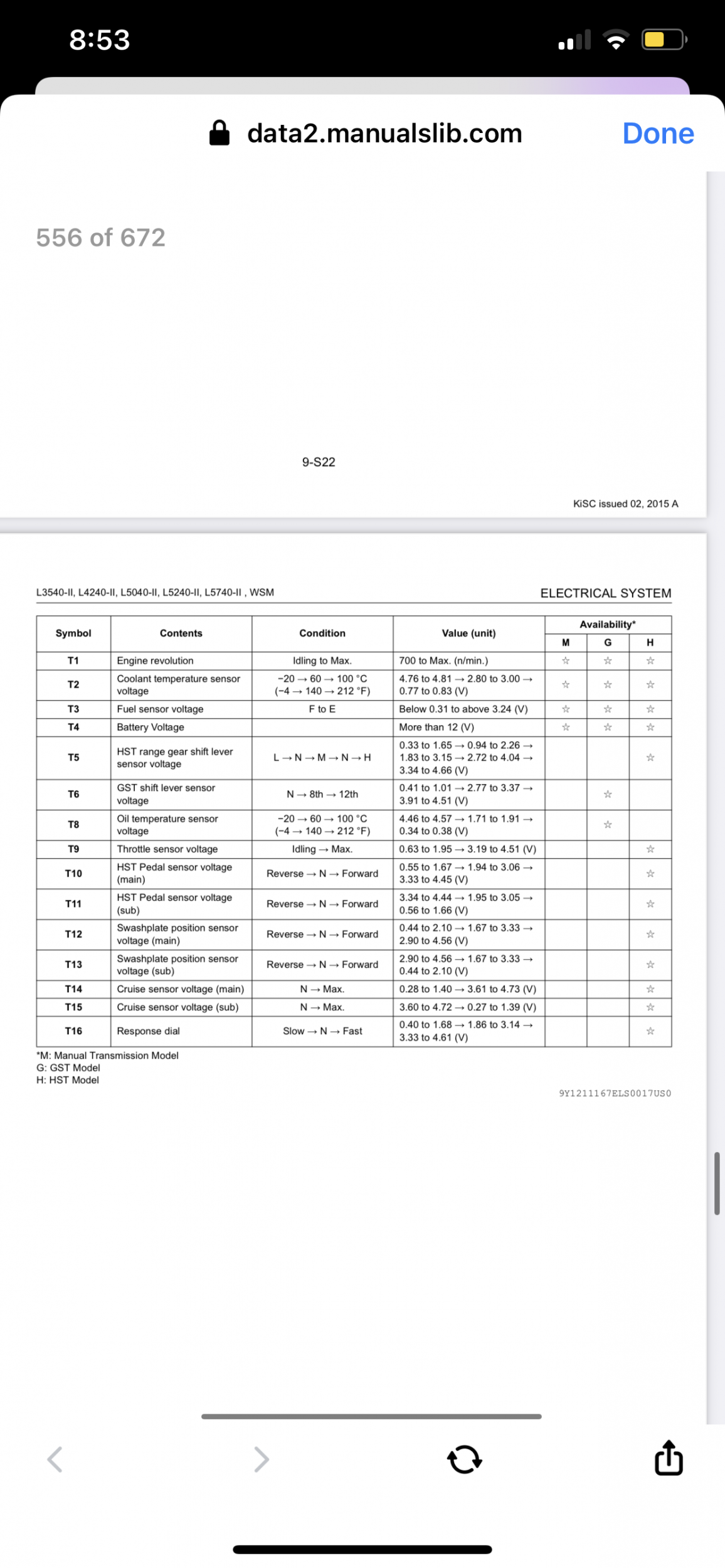

Okey, now trying to fix the high/low range i ran into a bigger problem! The machine would not move forward or reverse… it ran fine up untill i parked it by the side of the house so i can look into the high/ low switch (the thread i made)

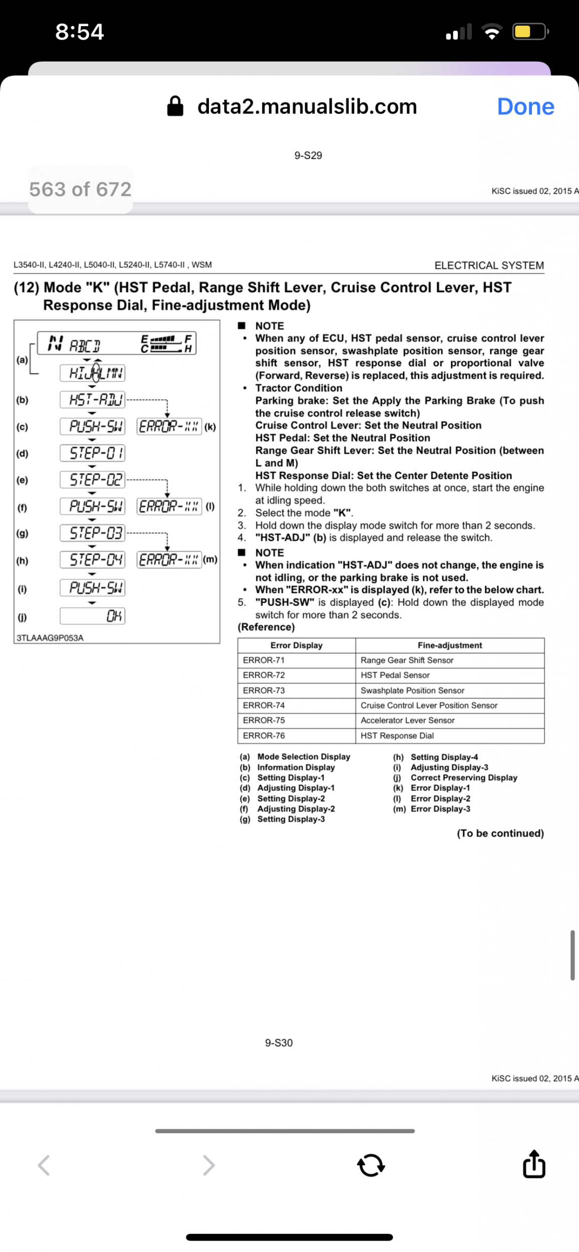

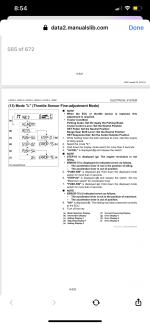

It starts up, it revs up all hydroulics work (loader backhoe) but it wont move, it seems like the hst pedal is not responding when pressed… went to maissicks picked up a forward, reverse solenoids, picked up an Hst pedal sensor but still no solution…. I checked all the trasmission sensors with the multimeter everything is fine! When i installed the new parts i went into the menue and tried adjasting everything by mode k and l no luck ….
T5 and t9-t16 im not geting any readings
Mode k im getting all these errors it wont let me move forward error 71.72.73.74 and 76
mode l give me an error 75 accelerator leveler is not in a position of idle
I am completely lost
Could it be possible that the ecu is toast? Any help with much be apriciated
