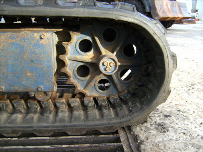

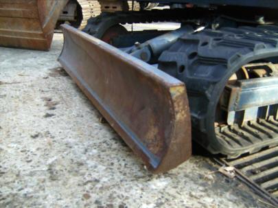

I found this KH-191 in Europe with rubber tracks, The sprocket and undercarriage is stock. can anyone recognize the brand of track?

   / Kubota KH-191 excavator track questions. #15
Don't push that too far, the stuff Europe has can be very different than the USA, especialy with excavators.

Maybe so, but I am running out of resources.
I can confirm that is the same drive sprocket and undercarriage... Worth a shot if I can find the manufacturer of that track.
