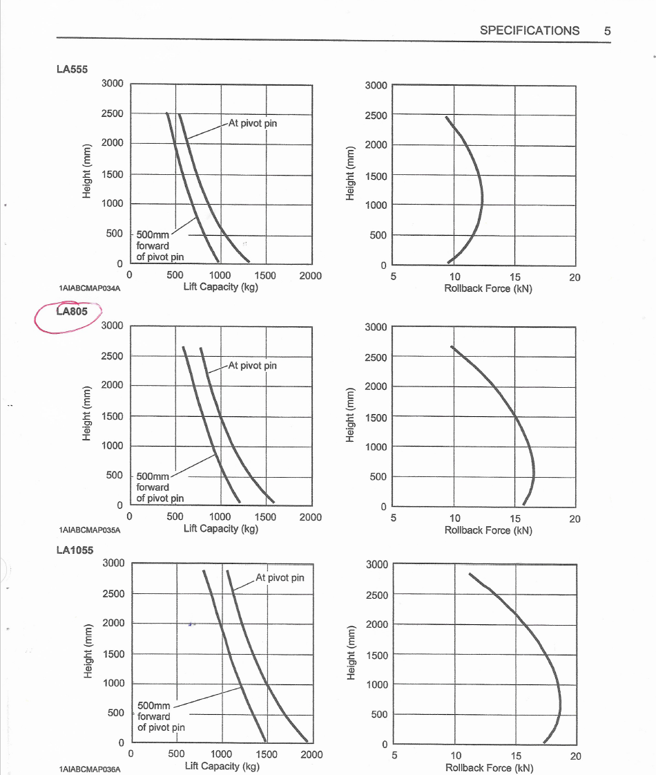

My 2010 Kioti DK45 cab unit was spaced to lift 2700 pounds. With rear ballast I have indeed lifted this much weight many, many times. I lift bags of concrete on pallets so I know exactly how much I am lifting.
   / kubota/ kioti specs and experience #32
This is a bit of a misunderstanding, along with what PEJ5 said earlier:
"It weighed 1300+ lbs.* When I went to remove it from my trailer with my tractor pallet forks I could only reach such that it was 3' out on the 4' forks.* I raised my forks and the rear end of my supposedly 2600lb capable tractor (with loaded tires) came off the ground."
When you lift a pallet, you know the weight that you are lifting, but you don't know the center of mass (necessarily) that you are lifting. The location of the center of mass relative to the pivot pin will make a HUGE difference in what you are able to lift. This is precisely why PEJ5 said he couldn't lift 1300 lb on his 2600 lb. The tractor is rated for 2600 lb at the pivot pins As you move away from the pivot pins, this capacity decreases precipitously because of the additional moment that you are introducing. Any loader lift capacity decreases as the center of mass moves away from the pivot pin. This is why Kubota (again, kudos for doing this) provides curves for lift capacity at the pivot pins, as well as 500 mm in front of the pivot pins. The capacity at 500 mm is a more realistic amount you will actually be able to lift, as most loads will have a center of mass in roughly this location. You'll notice there is a significant difference between the two curves.
Having said that, any loader will experience a similar percentage decrease in lifting capacity as you move the load away from the pivot pin. So, comparing specs at the pivot pin between loaders allows you to see which will lift more, but the number that is spec'd is not an accurate representation of what you will actually be able to lift.
This seems to be a common misconception that comes up a lot, which is why I think you see a lot of tractor owners saying "specs aren't any good, real world experience is what matters." Yes, that is true, because lift capacity away from the pivot pin is what really matters. However, any loader that lifts more at the pivot pin when compared to another loader at the pivot pin, is still going to lift more further away from the pivot pin as well. Therefore, comparing specs at the pivot pin, which is what is usually provided, still allows you to assess which loader will ultimately have a higher real-world lift capacity.
