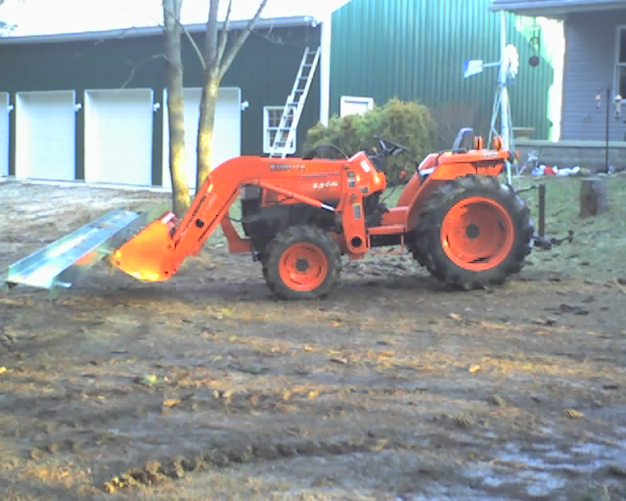

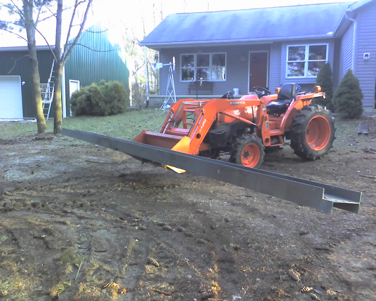

My LA463 says it can lift 853 Lbs at the bucket edge. I have loaded and unloaded 2 ibeams off my trailer that were 29' long @35lb per FT. Which is 1015 lbs. I did this with the forks in the bucket and the beam laying down. 12" beam puts the load center 6" in front of the bucket, and I had no problems at all moving them.
