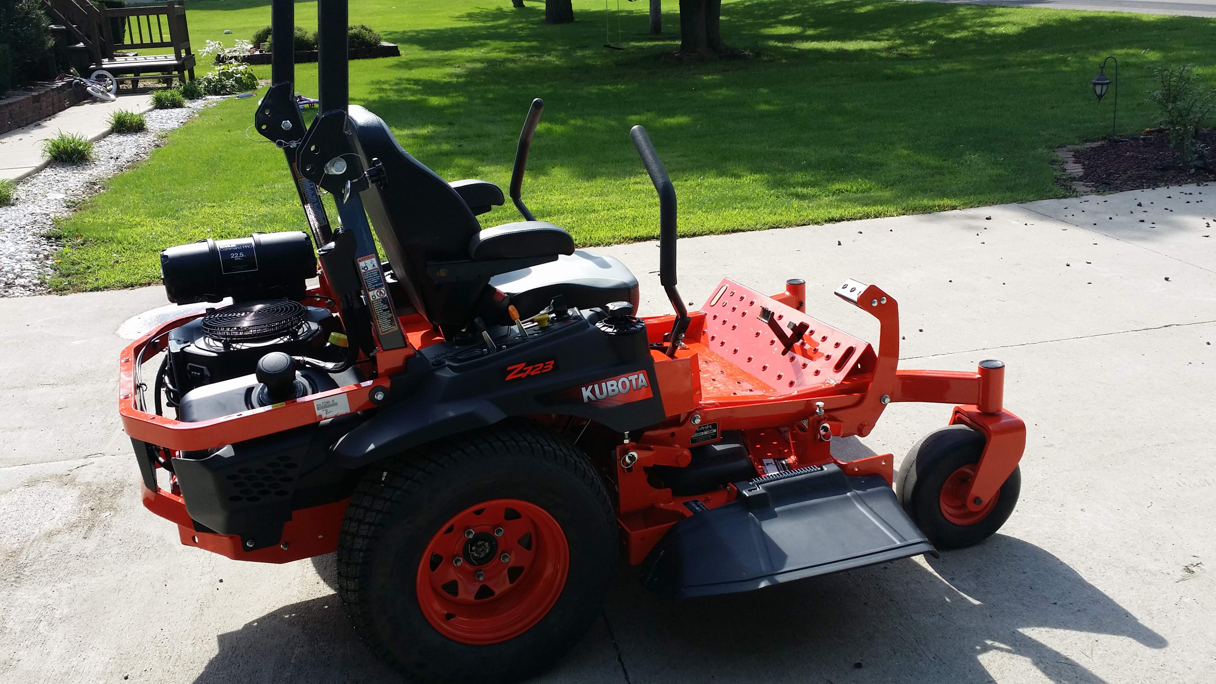

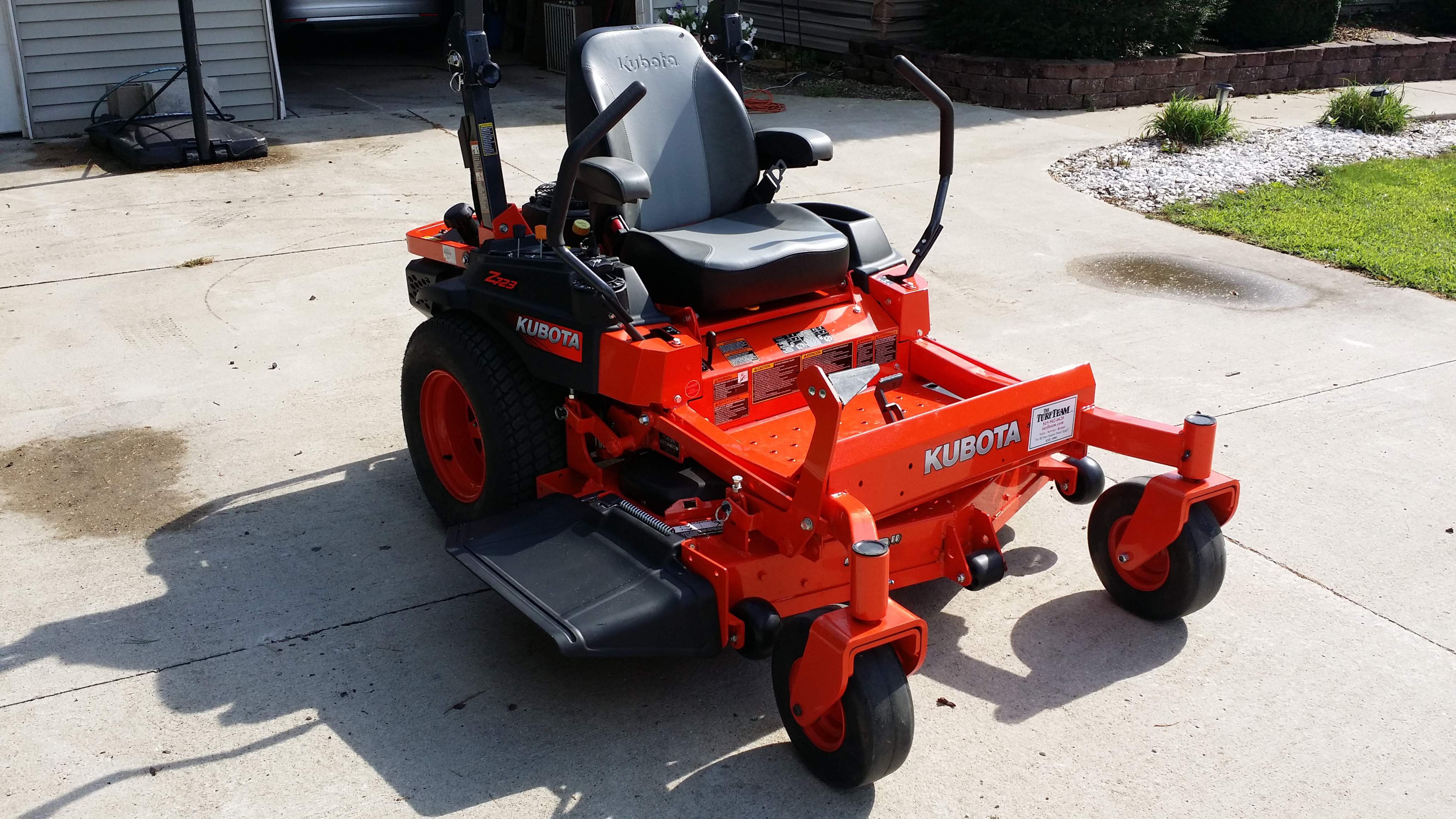

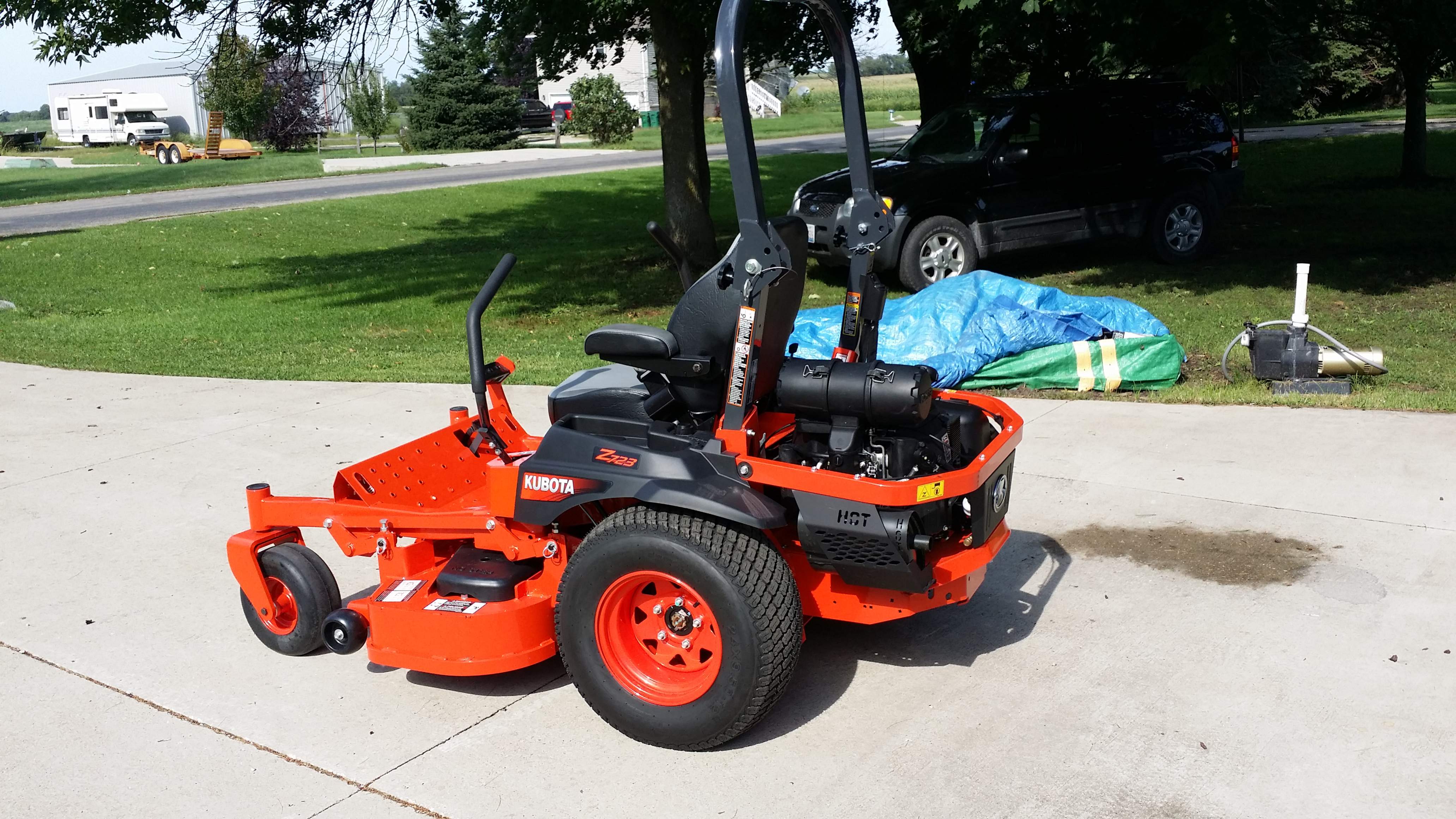

I was very close to pulling the trigger on a Kommander. But then on the 28th Kubota came out with new incentives on the 700 series. It worked out that for under $1400 more than the Kommander I could move up to a full commercial unit. My Z723 was delivered today. I think the Kommander is a good residential unit, but with the new incentives, anyone considering the Kommander should take a serious look at the 700 series.
