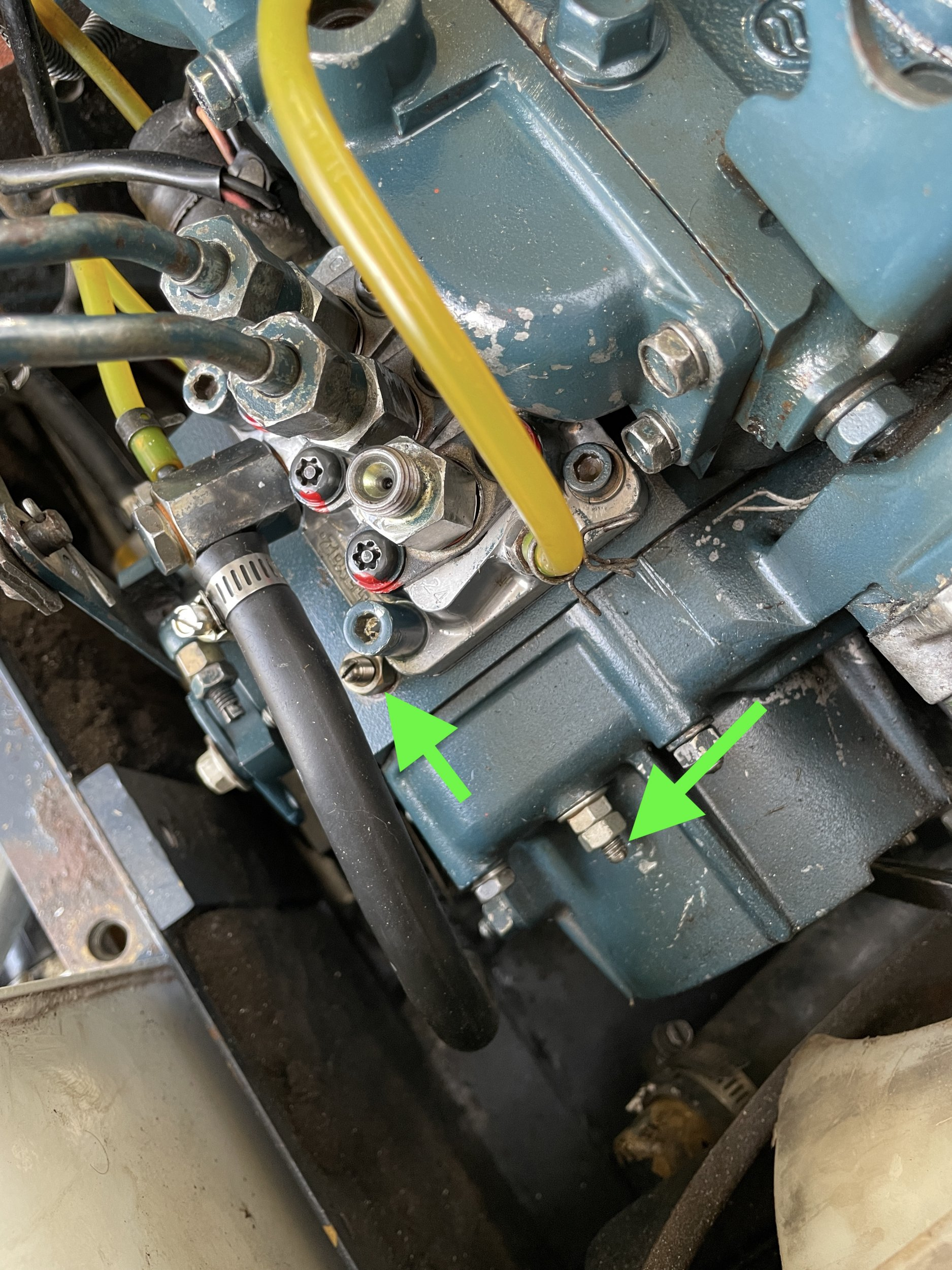

On adjustments, there's are a few that I'd like to figure out how to make sure they are at the original factory setting.
1. The one on the bottom side of the Injector Pump
2. The one on the front side of the Injector Pump
3. The number of shims that should be present under the Injector Pump (timing)
Regarding the shims, the KX41H exploded parts view shows three shims (0.2mm, 0.25mm and 0.3mm). How do I know what shims should be there? Mine has two shims. i haven't looked to see what sizes they are.
I assume that the parts view shows three shims because there are three possible sizes you can order? Not because you need all three on your machine?

Before i do that though, I would like to know that the two fuel adjustments are within factory range. Any directions on how to find their factory settings would be good.
There's nothing I can see about them in the Kubota KX41 WSM. I don't have the separate D1105-BH WSM. It may be more detailed in this regard.

I have no idea how to find the proper settings for the adjustments. It might be a starting point in the pump service manual. It would be nice if you had a pump technician that could tune it on the engine. That is about all I can think of. Maybe thepumpguysc has a suggestion?

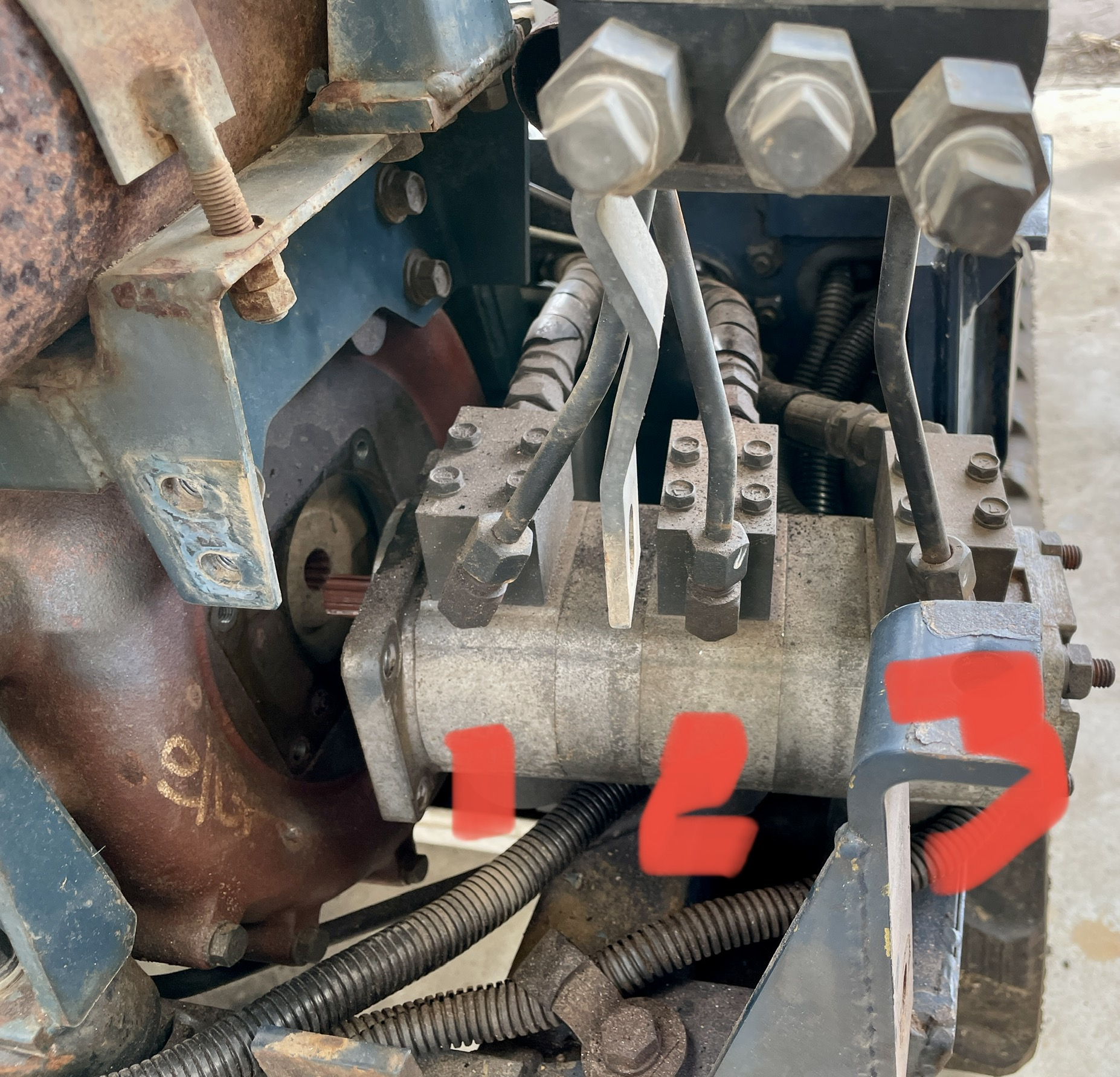

FINAL UPDATE - PROBLEM SOLVED
Ok. So after replacing the entire fuel system, the problem was where we first started - the governor flyweight sticking.
NB. For future reference, see my earlier video of the engine running with the throttle plate off so the governor fingers are visible.
My original questions in pursuing the governor were to see if anyone knew if the movement of the governor fingers should be noticeable. I wasn't sure if the governor adjusting the throttle slide would be big enough to see it move if it was just making very minor adjustments to the slide.
I would now suggest that if you don't see the fingers move under changing load conditions, you should head to the governor flyweight first.
Here's the difference between the old worn/faulty governor flyweight and the new one.
I have no regrets in replacing and repairing the entire fuel system along the way. Everything that was repaired or replaced was in terrible condition and I couldn't believe it was running at all in the condition they were in.
Thank you to all for your input along the way. It's been a great education.
Let me know if you have any questions about the process.

As far as the adjustments go, the fuel screw, I would back it out until it smoked at wide open throttle and then run it in a turn or two..
THEN, go put it under a load and check the smoke..
U WANT a puff of smoke at full throttle under a load but IT SHOULD clear up immediately..
