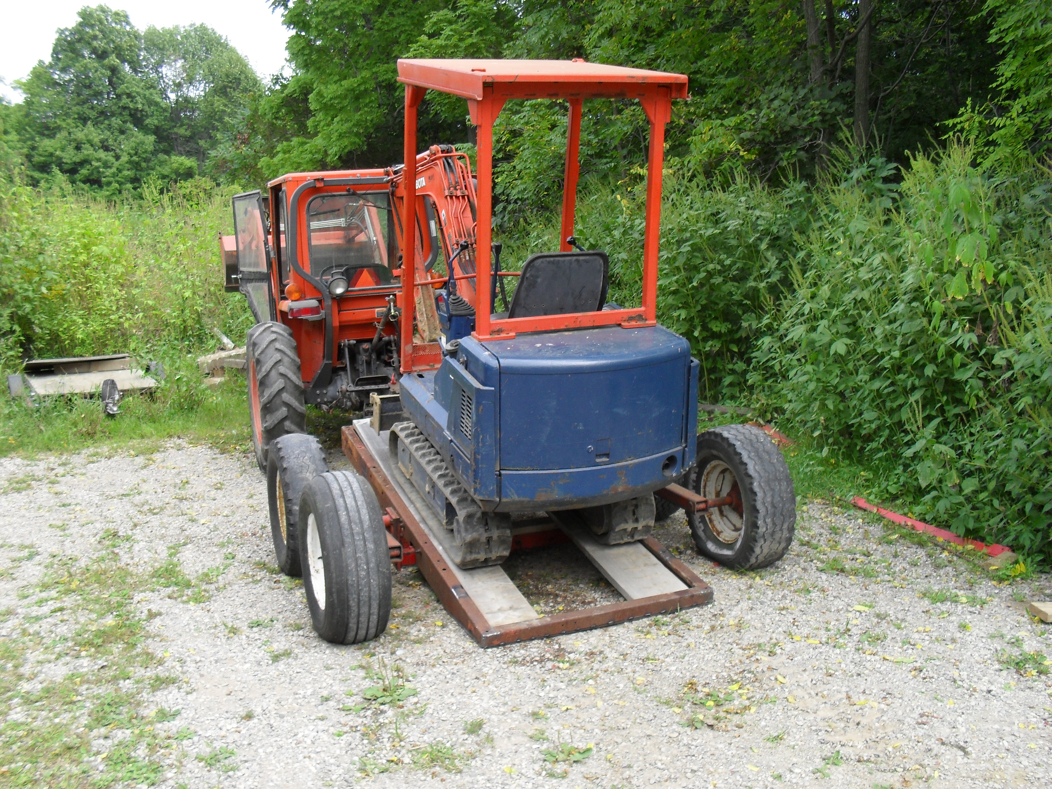

I have a old Kubota KX41H excavator that served me well for years but when I started to use it this morning I did not have hydraulic power on the arm, the left travel track and the auxiliary port. Everything else works fine. Hydraulic oil level is OK. Unfortunately I don't have the work shop manual.

The arm, the left track motor and the auxiliary quick coupler did't have pressure. They are all fed by the same one of the three pumps. I was thinking either pump not working or a failure in the main relief valve for this circuit. I found a plug on the valve were a poppet sits under. This was the easiest to get at so I opened it and let a little oil leak out and then put the plug back.
Everything works again.
