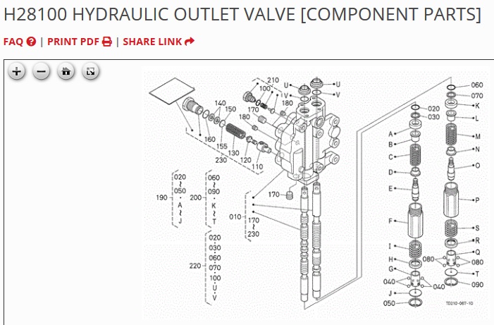

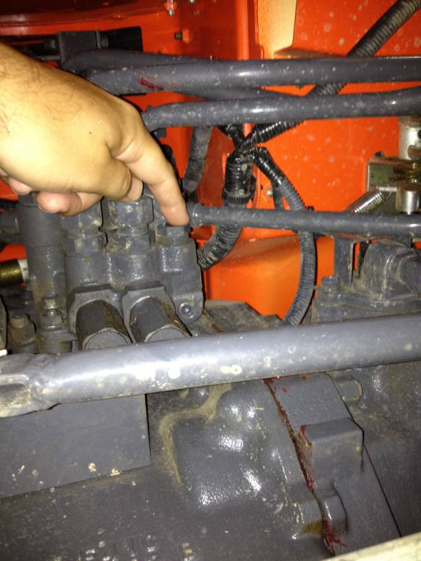

i have an L 3940 Kubota and want to increase hyd pressure i fully understand not to go over what the bucket is rated for on pressure. My question is where is the adjustment bolt at, i am thinking it is a bolt with spring and different size shims? But i need someone to tell me where that bolt is at thanks, Eddie

   / Kubota L 3940 hyd pressure adjustment #4
Shim #50-55 (depending on size). Make sure you know the pressure before and after... .

   / Kubota L 3940 hyd pressure adjustment #7
Here's one of the pictures from that thread I linked.tapatalk_1609718778678.jpeg

Eddie: You should try to get a pressure test on your hydraulic lines. Even taking it from rear remotes is a possible location. You can order from Amazon everything you need to build an AG hydraulic pressure tester for under $25. And it will last the life of your tractor.
