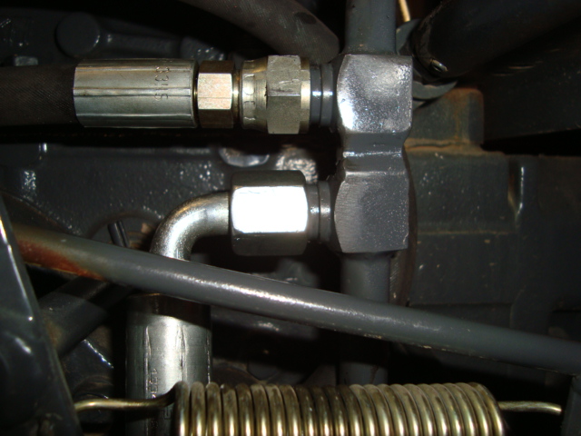

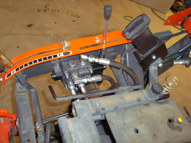

Thanks for the kind word guys. J.J., thanks for catching me on the power beyond, guess I forgot all about that, also thanks for posting the PDF on the prince valve, I saved a copy. I didnt figure that there would be very many people here that had the equipment to cut and braze their own fittings so thats why I mentioned about flared and flareless fittings. I simply used what I had on hand and it works fine. O.K., power beyond.
Yes I used the power beyond port, otherwise the whole thing wouldnt work. Looking at the first picture you can see a hose in the top of the valve. This is the power beyond that feeds the 3 point.
And this is the hard line that I butcher,,, I mean cut and spliced that feeds the 3 point. The bottom line is "power in" to the new valve
and the top line is "Power beyond" to the 3 point. I really couldnt get in close enough to take hose routing pictures so if any one needs to know something, let me know.

Very neat and clean install. Do you have the part # for the Prince valve ? I see a couple of different ones listed.

I will be ordering one of the valves for mine... I work on construction equipment and have come up with a used electric solenoid/valve set up I was going to use with a toggle switch control to make it a clean hidden install. But after seeing your with the handle using the existing draft slot I like it. I will probably save the electric set up and use it as a front aux for a grapple etc.

I like it too, very nice job. Mine is plumbed the traditional way, off the loader valve. I like the way you used the existing slot for the lever. I might do something like this with mine in the future, although I've got so much already in it I'll probably just leave it as is.
Thanks for posting the procedure pics, it's nice to see a different approach to the problem.
