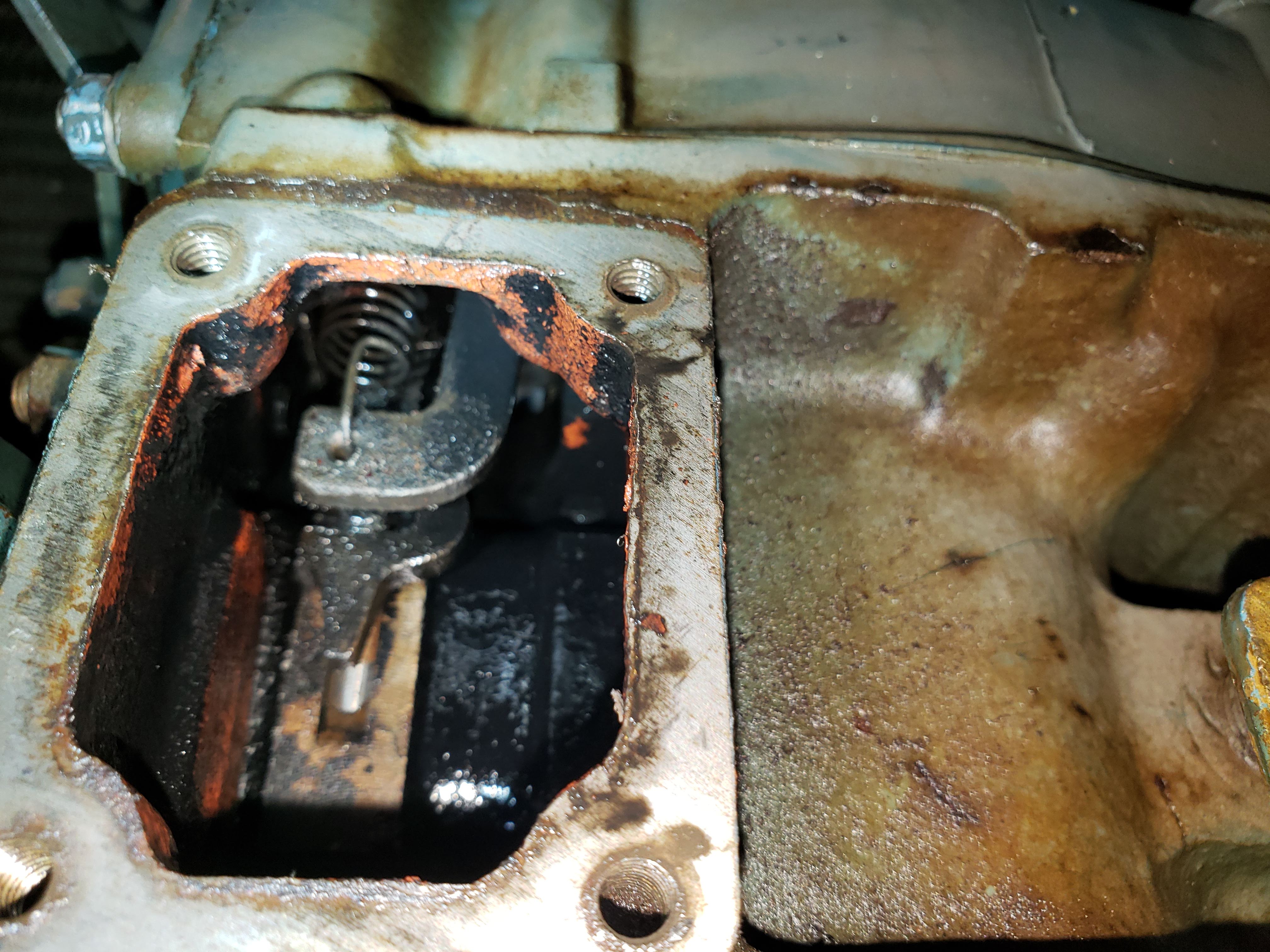

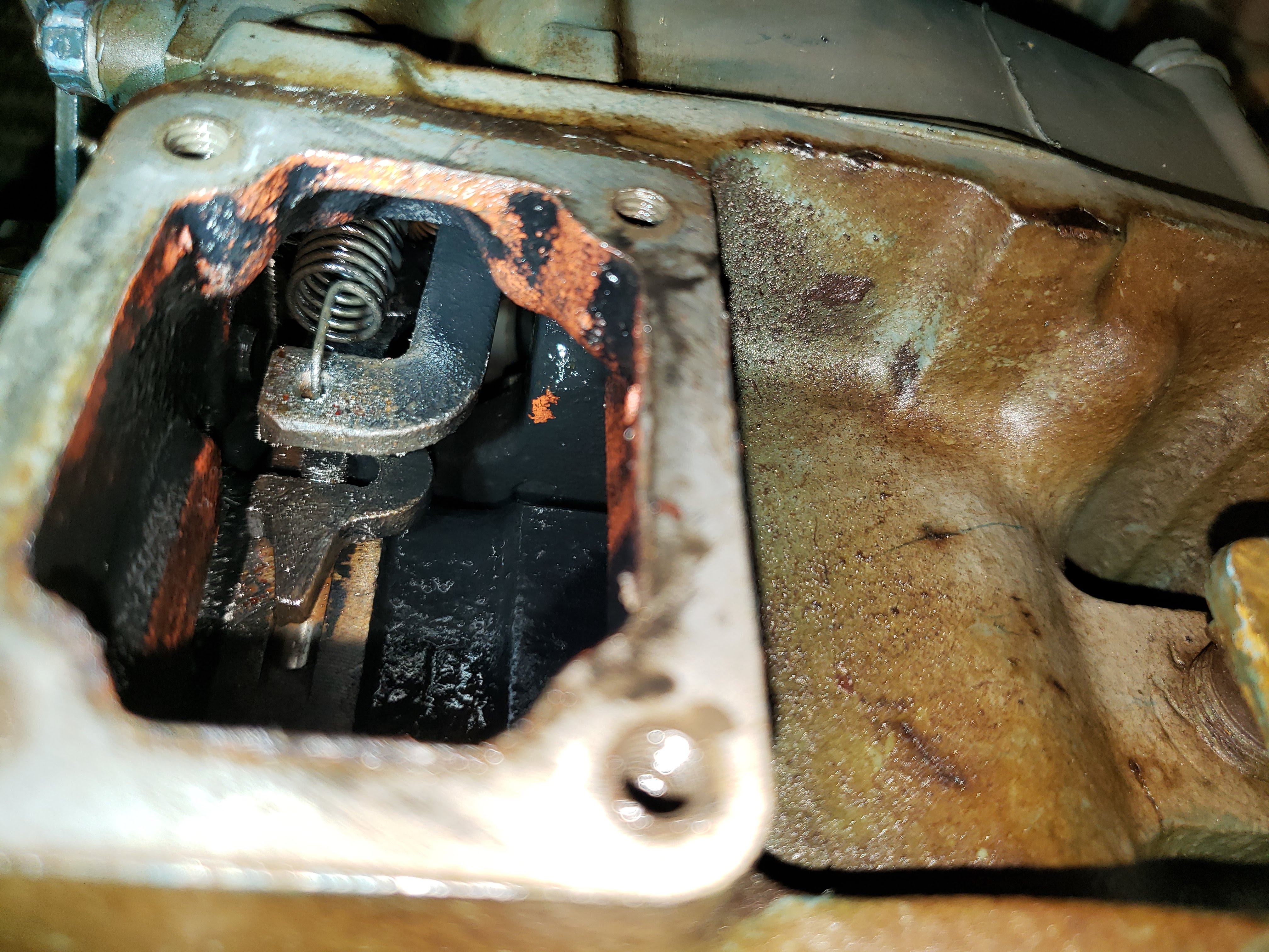

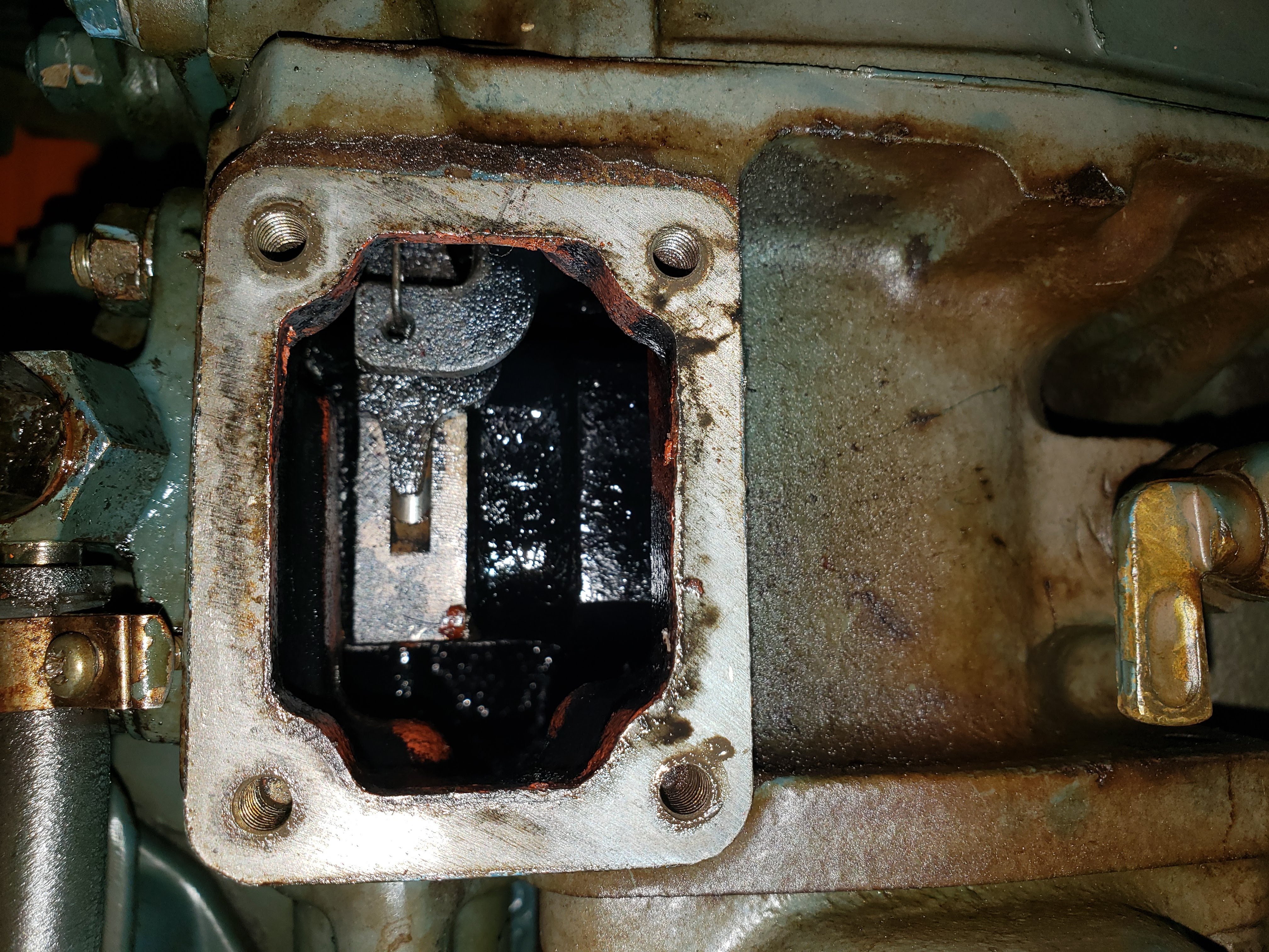

Attached to this reply is a few pictures of the pump internals and a short video of what I see when moving the throttle lever. The lever closest to the camera moves slightly when the spring tension increases and it can be manually pushed about 3/4" toward the rear of the tractor. The lever farthest from the camera won't budge even if I lightly pry on it in either direction. Is that lever supposed to move with the throttle?
