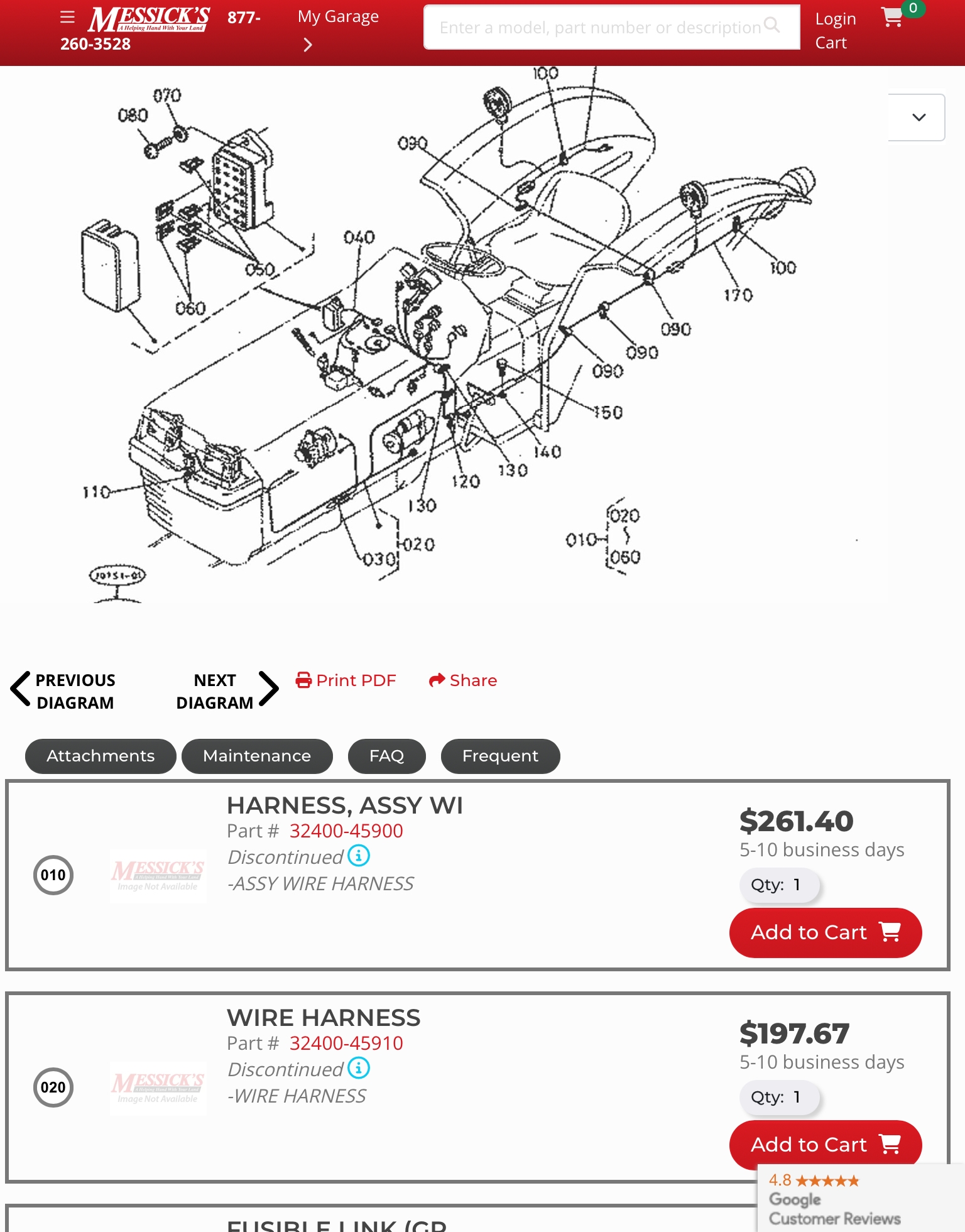

I am interested in replacing the electrical wiring on my tractor. Any advice/recommendations on how to do this?
Thanks
   / Kubota L2050 Wiring Harness #2

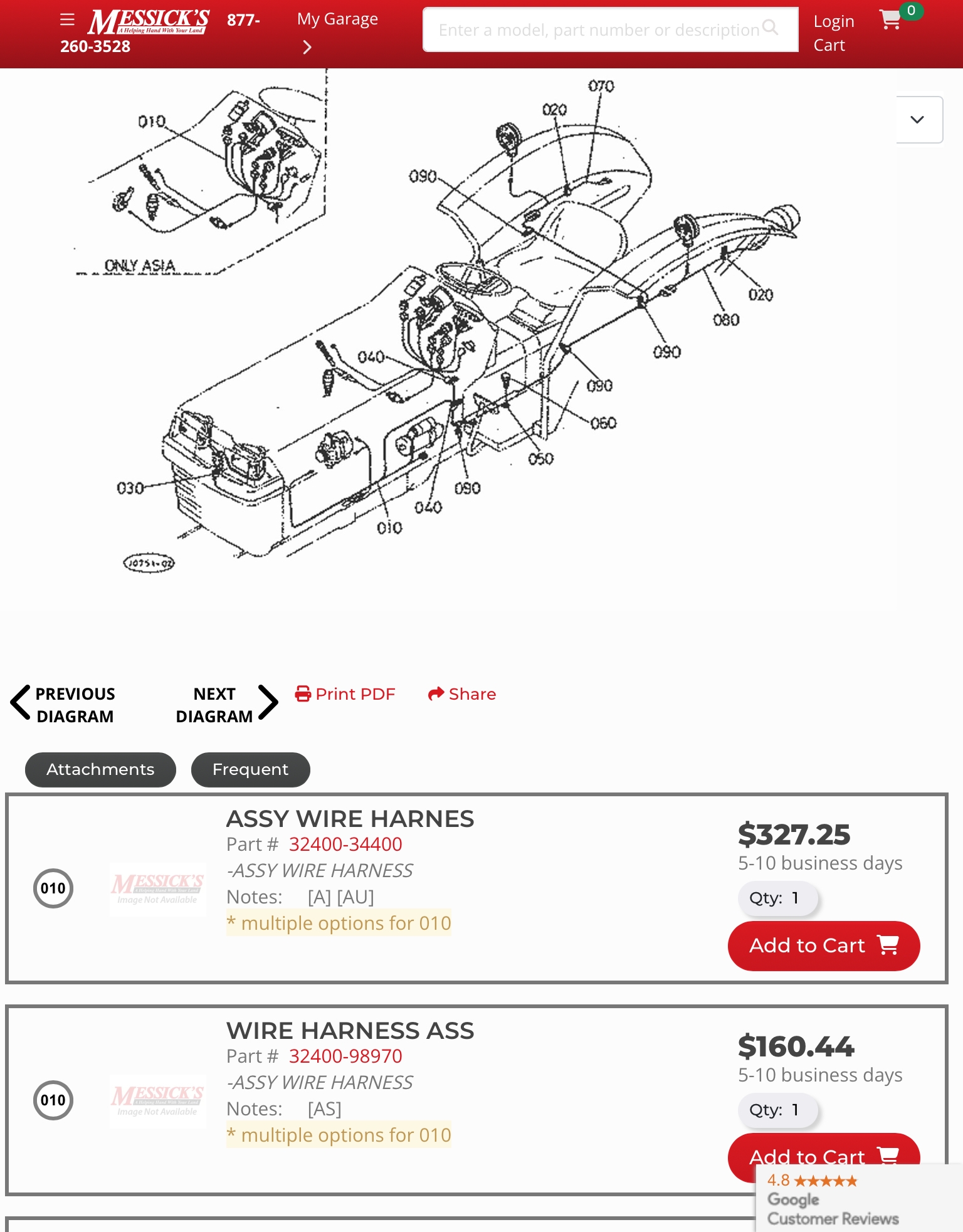

Your wiring looks pretty simple compared to todays machines. You can buy a harness or rewire it yourself if you are so inclined.
