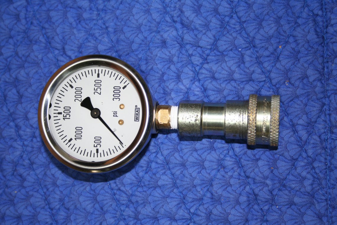

Its to bad there is not a good place on this tractor to leave the gauge plumbed in all the time.
   / kubota L235dt Hydraulic issue #32
Why not plumb it in at the input to the FEL valve. You can then observe it when working, or add it to the dash with a rear hose hook up.
The first one uses a QD to connect at different points on the tractor.
The second one can be connected out of the way but available.
https://www.surpluscenter.com/item.asp?item=21-1044& catname=hydraulic
HYDRAULIC LIQUID FILLED GAUGE 0-6000PSI BOTTOM MOUNT - on eBay!

installing it at the loader valve might work - I will need to weld up a cover for it. I take this tractor in the woods a lot to drag trees out for firewood - I would be afraid of hitting it on something.
Its a great idea and it would give me a heads up if anything was going wrong with the pump
