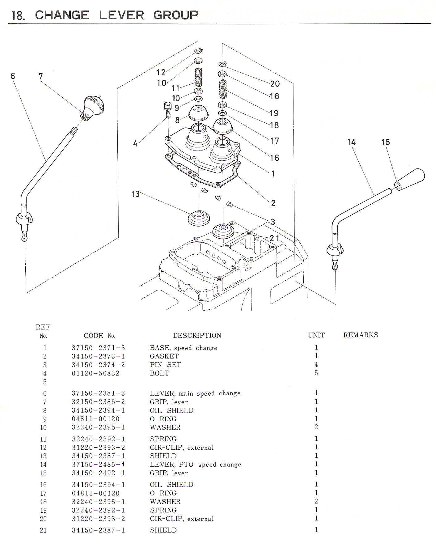

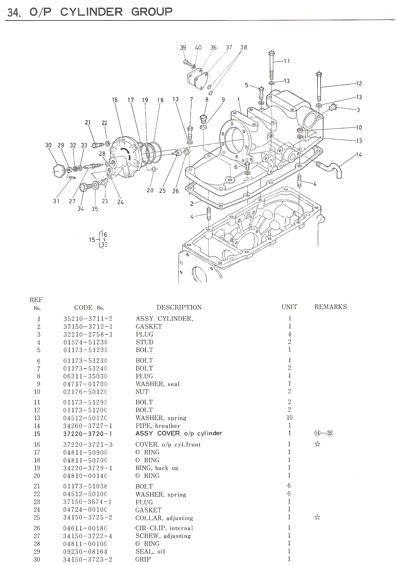

I have an older Kubota L245 that has just started leaking fluid around the gear shift. I read elsewhere on the internet that it could be caused by a clogged "weep hole" . I cannot locate a weep hole anywhere.... Anybody have any suggestions? PLEASE HELP....
   / Kubota L245 2-wd leaking around gear shift #2
I had this same leak years ago and I think I replaced #13,#21 Hope this page from my manual helps

Thanks, I'll give that a try.. Do you know where the Vent Tube is for this tractor.? I have read several post that suggest that this vent tube may be clogged but all the say is that it is under the seat... I sure can't find it.
   / Kubota L245 2-wd leaking around gear shift #4
Look under the left side of the seat #14

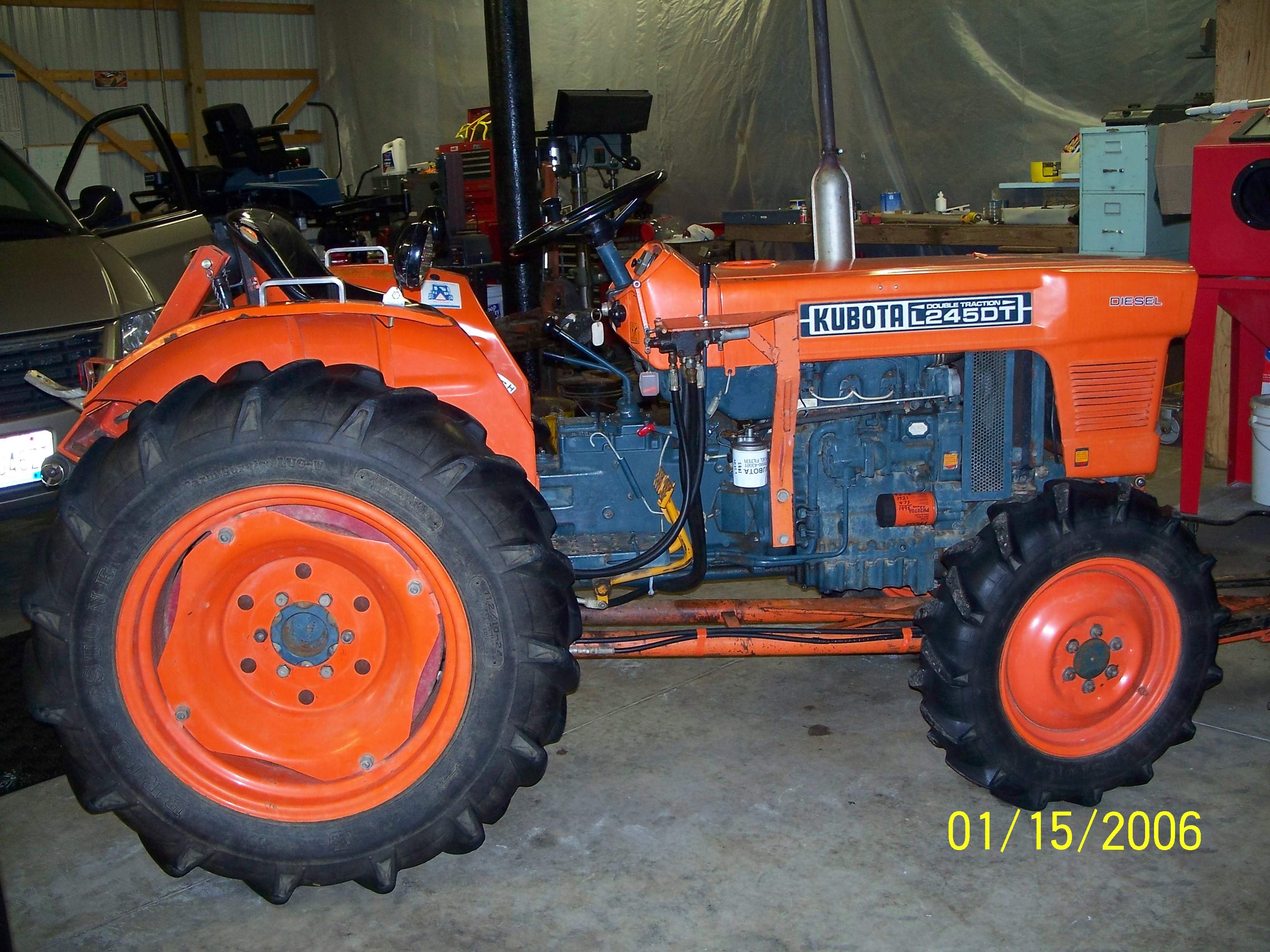

I had a L245DT exactly like yours -- even had a HD snow/dirt plow mounted on front with controls exactly the same as yours -- sure brings back some good old memories. Bought it new in late 70's and had it for 15 years. Never had a problem of any kind.
Regarding the leak, I'd check to make sure the transmission isn't way over full before getting too excited. It's a lot easier to fix that sort of problem and doesn't cost anything.

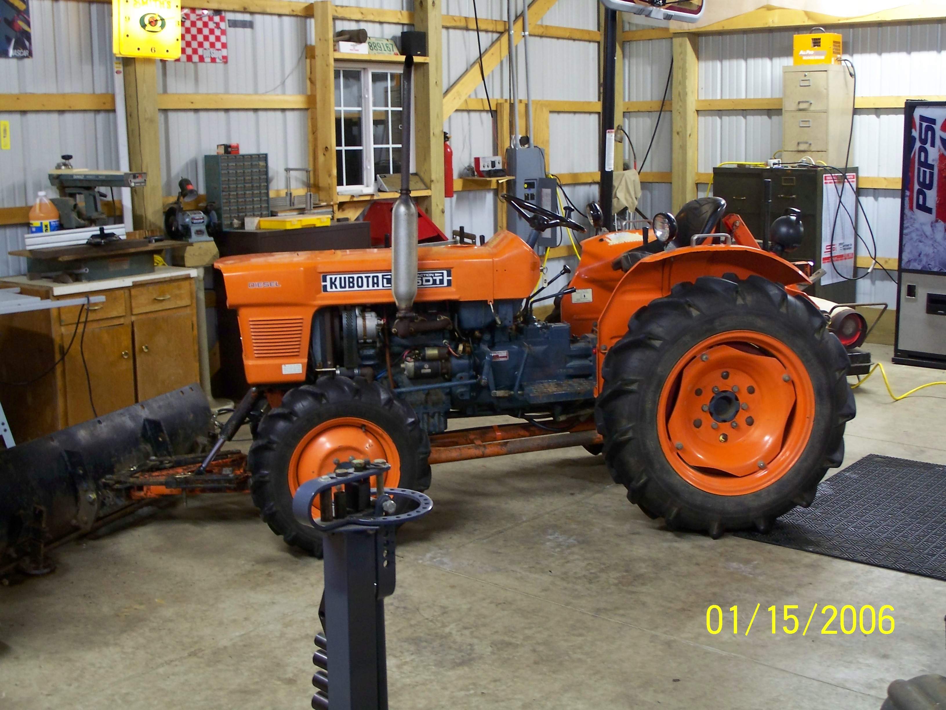

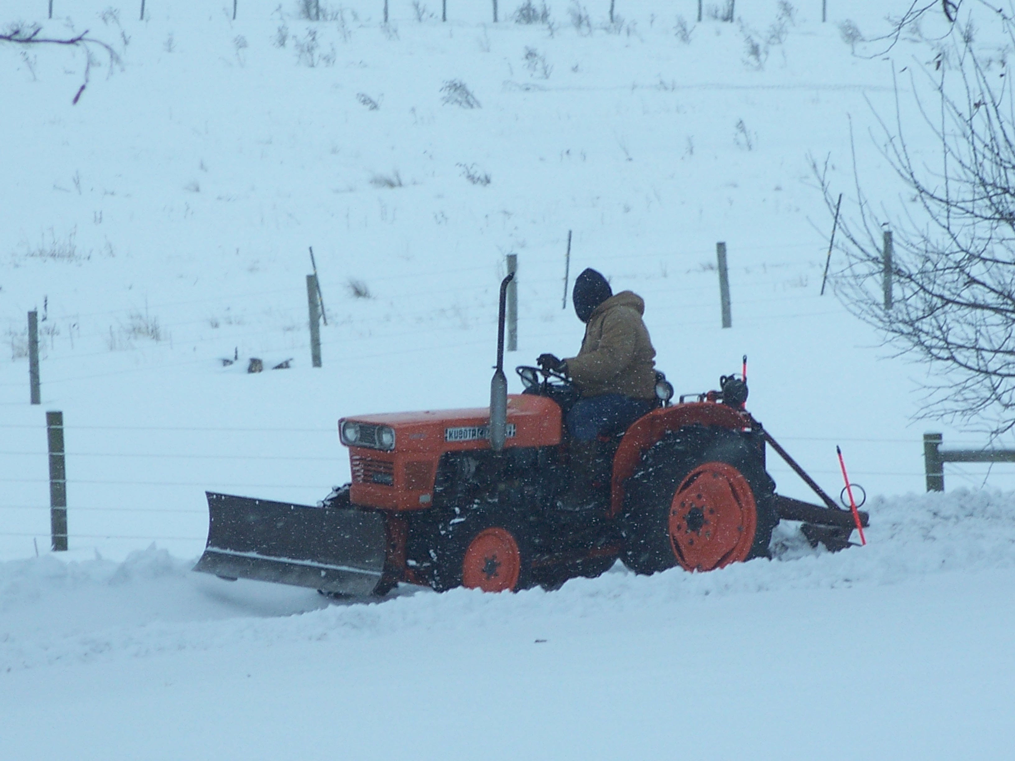

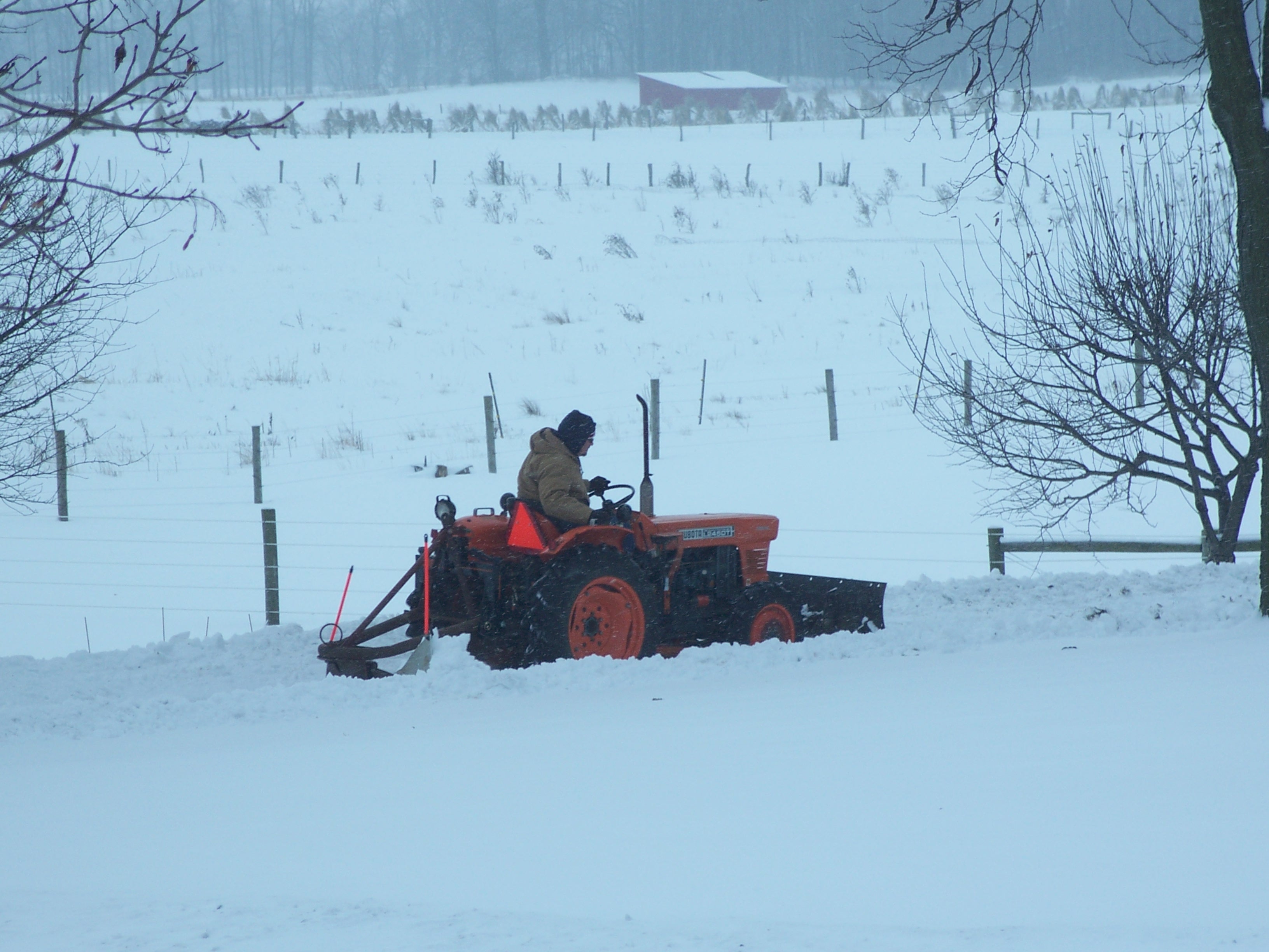

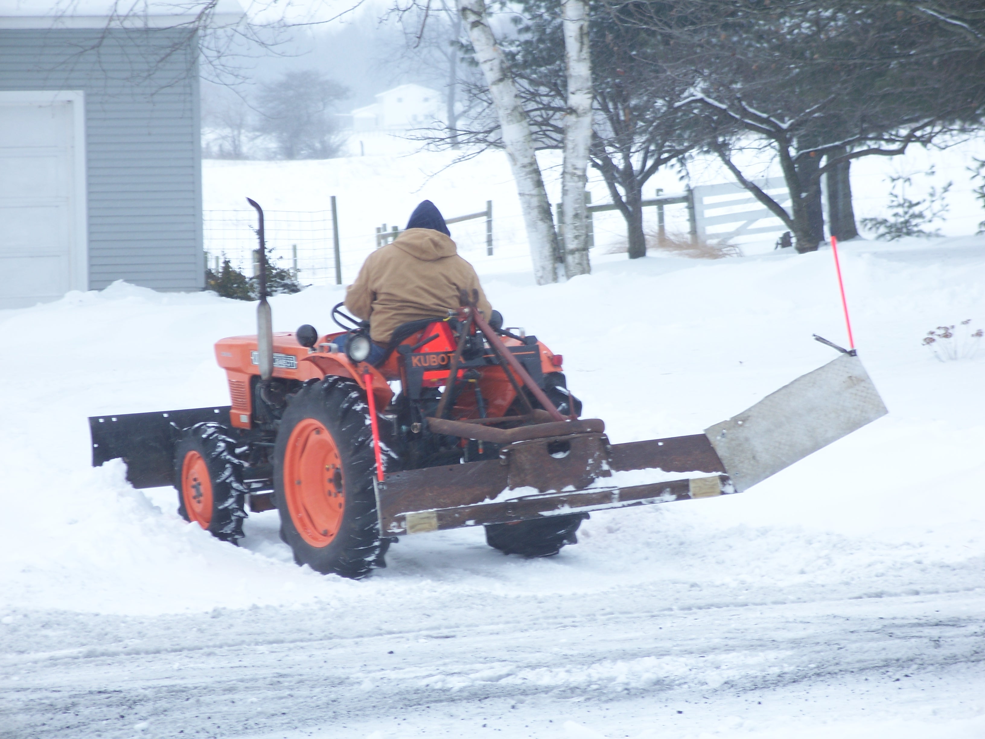

Got it from my brother about 5 years ago and have had little trouble with it :)Looking foward to plowing snow this winter.
