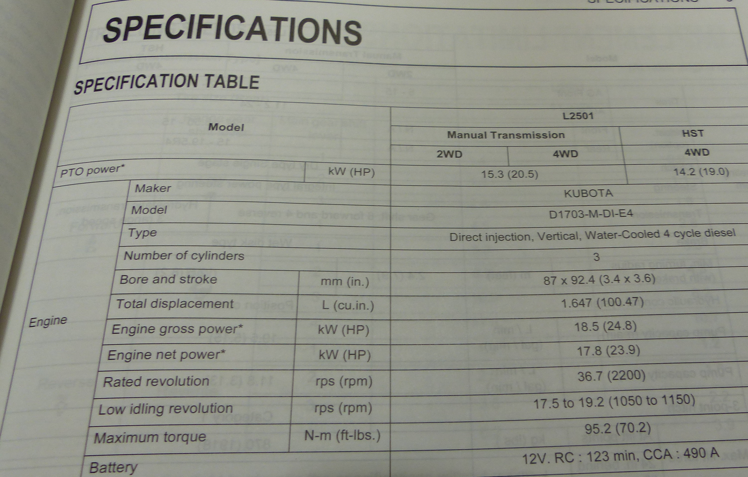

I was looking at a Kubota L2501 this week and have been trying to look up engine performance charts on this engine with no luck. Does anyone know where I can find this info on Kubota D-1703-M-E4B direct injection engine? I am curious what was changed from the E3B interim tier 4 engine that was rated at 2800 RPM.

OC3: I have attached a picture of the owner's manual for the L2501 engine. Click on it to expand it. One thing that stands out is that it has a lot of torque (70.2) compared to most other 25 horse engines. I have a L2501HST and find it has plenty of power for a 5 foot brush hog.

Personally I find it difficult to believe a 10 cu in larger engine has less power than the one in the L 3200. The peak power rating is at 2200 rpm but the "540 rpm" speed is still nearly 2,800 rpms. The other tractor ratings are at 2600 to 2900.
This seems a pure emissions dodge.
   / Kubota L2501 performance #6
The rated 540pto speed for the L2501 is 2105rpm for the hst and 1910rpm for the gear.
Think of it like the OTR trucks, big engine, lower rpm/hp=better longevity and lots of tq at a low engine speed.
I was looking at a ford 1920 the other day, 32hp with a 2.0L. It's nothing new.
