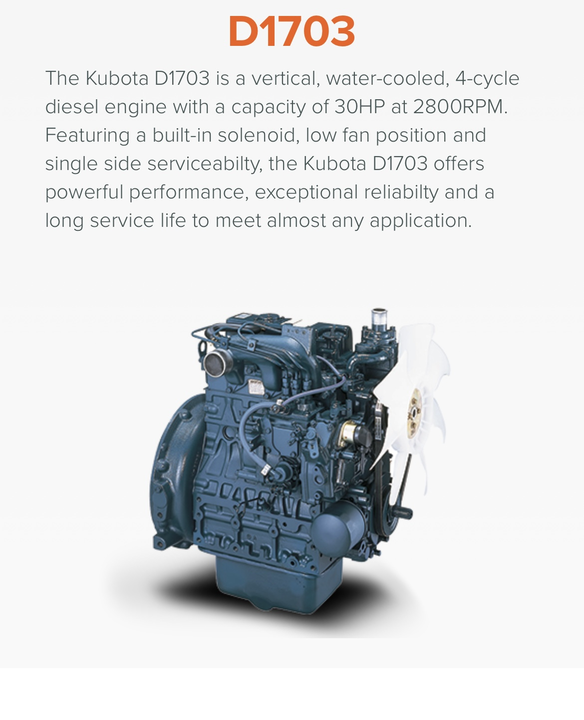

I'm wondering about injector timng: any need for? discussion? Results?
Maybe it is there and I missed it. I've just started started reading your incredible modification article & am bouncing around. I'll go back and read some more, but you have sure made my mechanical day.
Thanks,
rScotty
Thank you!
The injection pump timing on the L2501 is retarded from the factory to meet tier 4 emissions standards. Since the injection timing has already been retarded, it makes this engine a really good platform for turbocharging.
There is another turbocharged L2501 and that owner advanced the injection pump timing and increased the RPM limiter but, his tractor hasn’t been dyno’d so I can’t make a fair comparison.
Mike

It is? By how many degrees? What is normal? And how in the world would retarding the timing help make it meet tier 4 emissions standards?
I'm asking because in a gas engines, retarding the timing shortens the burn time which causes incomplete combustion and a more sooty exhaust - you can literally tell by the smell that the timing is retarded. I assume that retarding burn time causes more soot in diesels too.
BTW, it sounds like you sure put a lot of study into this. Congrats.
rScotty
I would need to dig into my notes to retrieve the actual figures….
Here are the D1703 Tier2 stats;
For the L2501 (25HP @ 2,400 RPM), Kubota restricts the D1703’s fuel consumption, limits the RPMs and retards the injection pump timing to meet Tier 4 emissions standards.
The injection pump timing is retarded to reduce power. On a diesel, retarding the injection timing is one of the best ways to reduce power and it actually improves fuel efficiency. So, for Kubota, it is a great method to meet Tier 4 emissions.
Indeed. Lots of study was required to put this package together.
Mike
