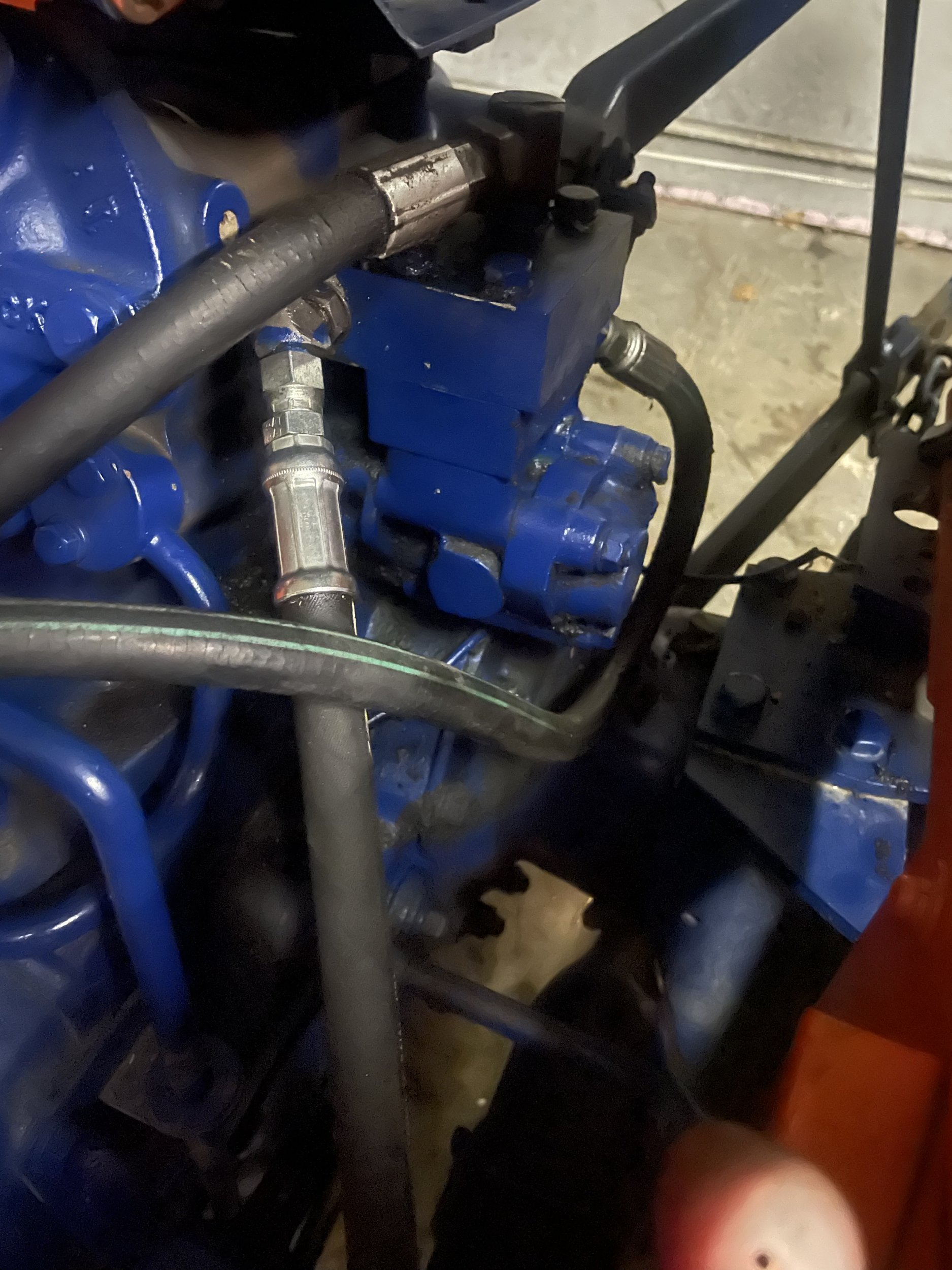

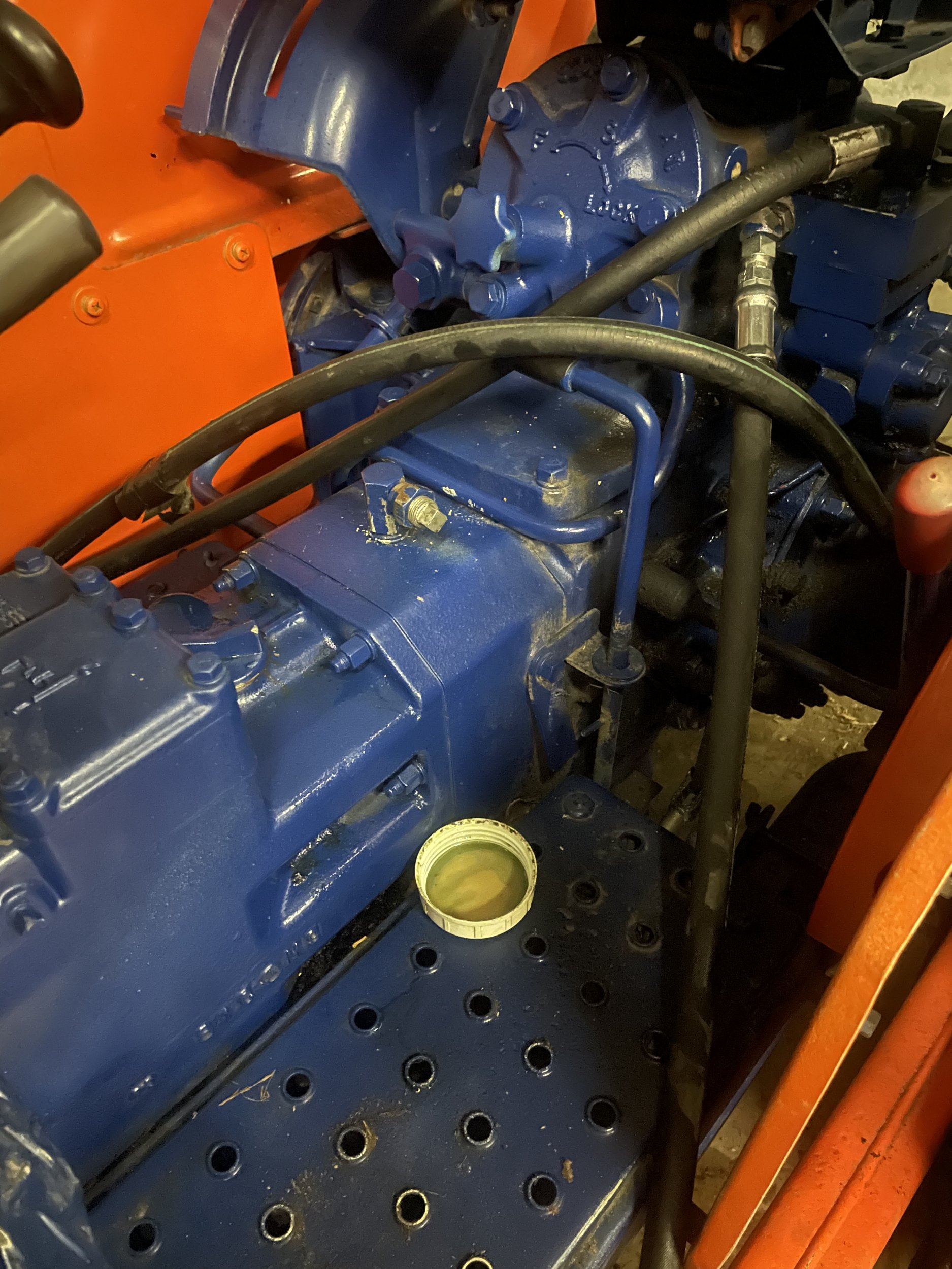

The bottoms picture with the 3 hoses the one in the middle was hooked up too the power steering. And the one fitting that looks like a elbow had a hose coming off it going too the power steering
/ Kubota l295dt loader issue #7
Your pictures help clear up most of it. The tractor looks to have 2 stacked hydraulic blocks - an unusual arrangement (there's usually just one - or none).

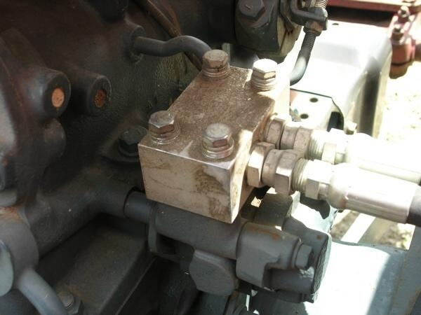

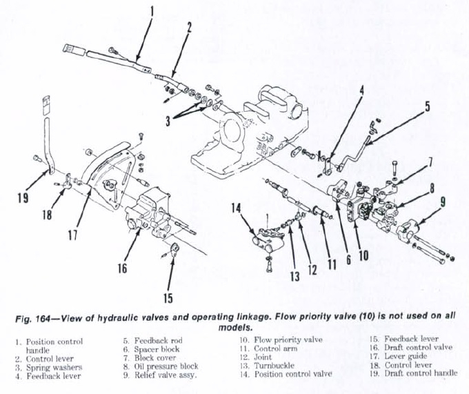

Looking at the layout below, when adding valves to these tractors, a one-piece hydraulic block bolts to part 8, replacing part 7, to provide ports for added valve(s). Your setup has 2 blocks - but accomplishes the same thing.
one-piece hydraulic block bolted to part 8
hydraulic block 4-bolt cap drawing.jpg Part 8
On part 8 the forward hole is "power out" and the rear hole is for the loader valve's power-beyond flow which comes back to power the 3-point hitch.
With the power steering removed, I think the loader valve's exhaust hose should be going to the fitting on top of the trans case instead - otherwise the system can't run open-center.
When the power steering was installed, it was likely powered from the loader's power-beyond hose, with the steering valve's exhaust going to the fitting on the trans.

Please post a picture of the loader valve and its hoses. And maybe another pic of the 2 hydraulic blocks from behind? We'll get to the bottom of this - as my son would say "it isn't science rocket!" :unsure:
