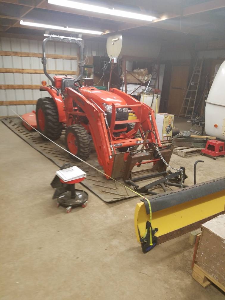

My home made plow for my former L3200. $100 plow from a garage sale that was probably for a small Jeep or something. $100 3pt Quick hitch welded to a $100 SSQA plate. A couple of pipes welded up to stick in the plow mount holes & catch the QH hooks along with a piece of chain. I love the float out at the blade. Really miss that on my new solid mount plow. It did stick out really far though, which face the blade leverage to push the machine sideways easier.
It was manual angle. Cheap & functional, but not nearly as nice as hydraulic angle on the new plow on the new machine.
