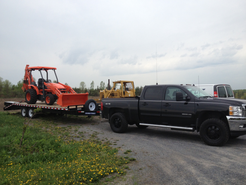

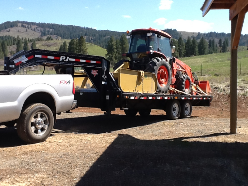

I tow a L5740 with a BH (or also this road boss) on this 20' 14K PJ pulled by an F350 and it fits and handles very well.

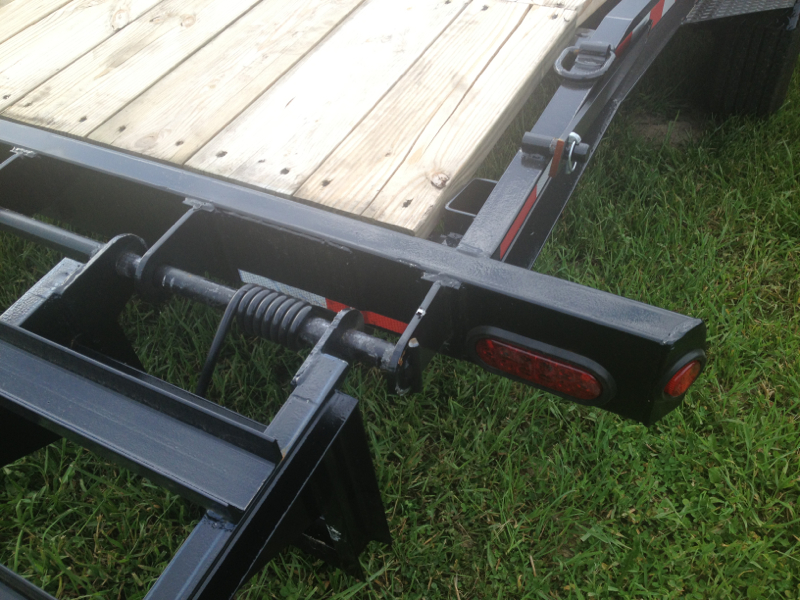

I just purchased a 20' 12,000 GVWR. With FEL and rear mower it fits like a glove. An 18' would simply be too short. Now if I had to borrow a trailer or only haul once in a great while, I'd make it work. If your going to purchase get 20' at least. Mine is actually 18+2. I searched on here and searched the market and received alot of good help. Although a 14,000 would be better, the 12,000 is plenty for my L3540 cab FEL and whatever implement I choose. Also, I chose bumper instead of gooseneck for a few simple reasons. If I need to haul my trailer with an SUV for some reason I can. #2 I still have the whole bed of my truck available for other items. Hand tools, implements, supplies etc.
I chose to have more options on my trailer than more weight. Welded in chain box, 10 D-rings welded on the sides, spring assist loading ramps, LED lights, electrical ran in conduit, drop foot jack, radial tires step on fenders, etc.

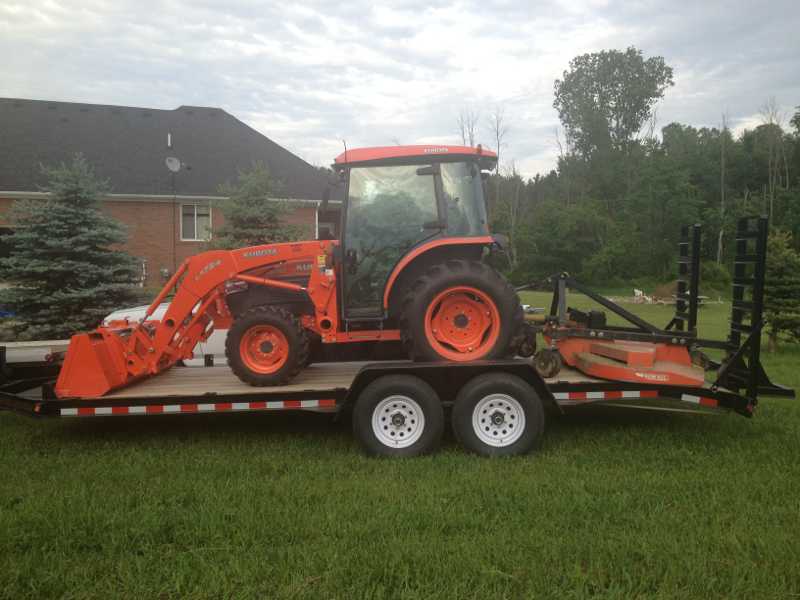

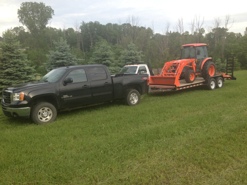

Here's a nice set up for a tlb 25 foot sure trac 14k Awesome trailer spring ramps and lots of room to put some implements on there to
   / Kubota L3240 TLB w/Cab towing it with F350 Crew cab 5.4L #19
<img src="http://www.tractorbynet.com/forums/attachment.php?attachmentid=322125"/>
I like your setup. It looks oddly similar
