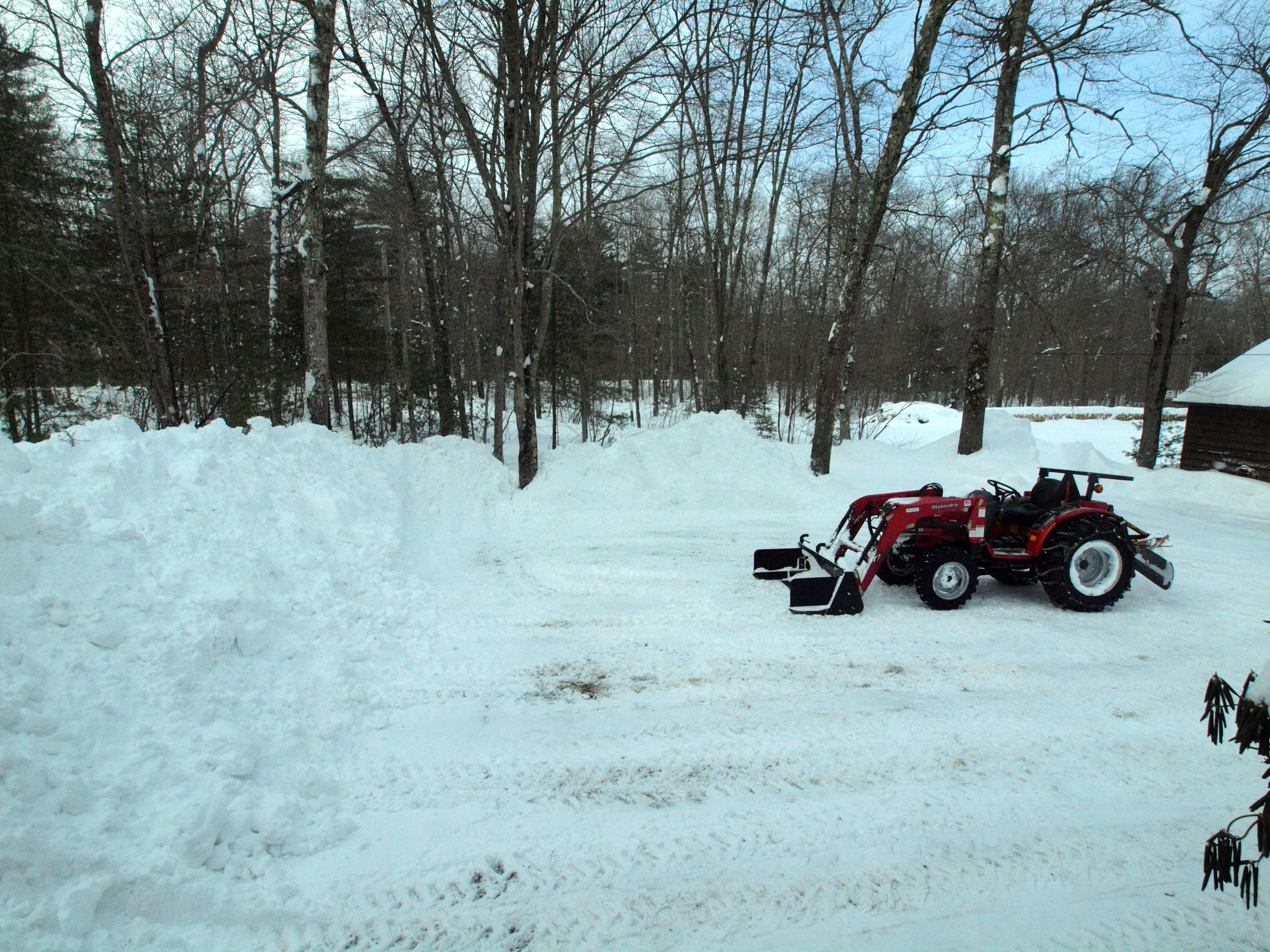

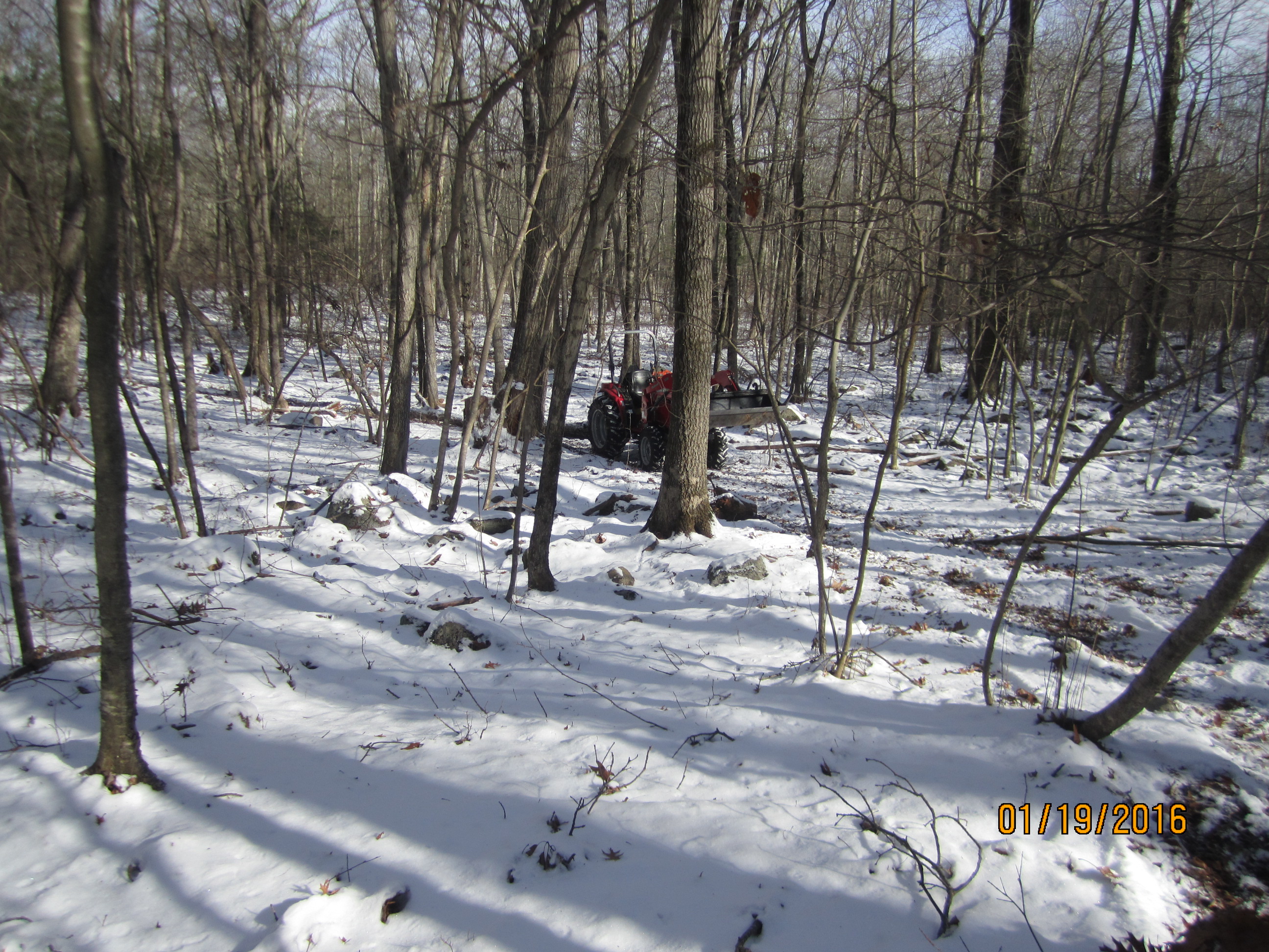

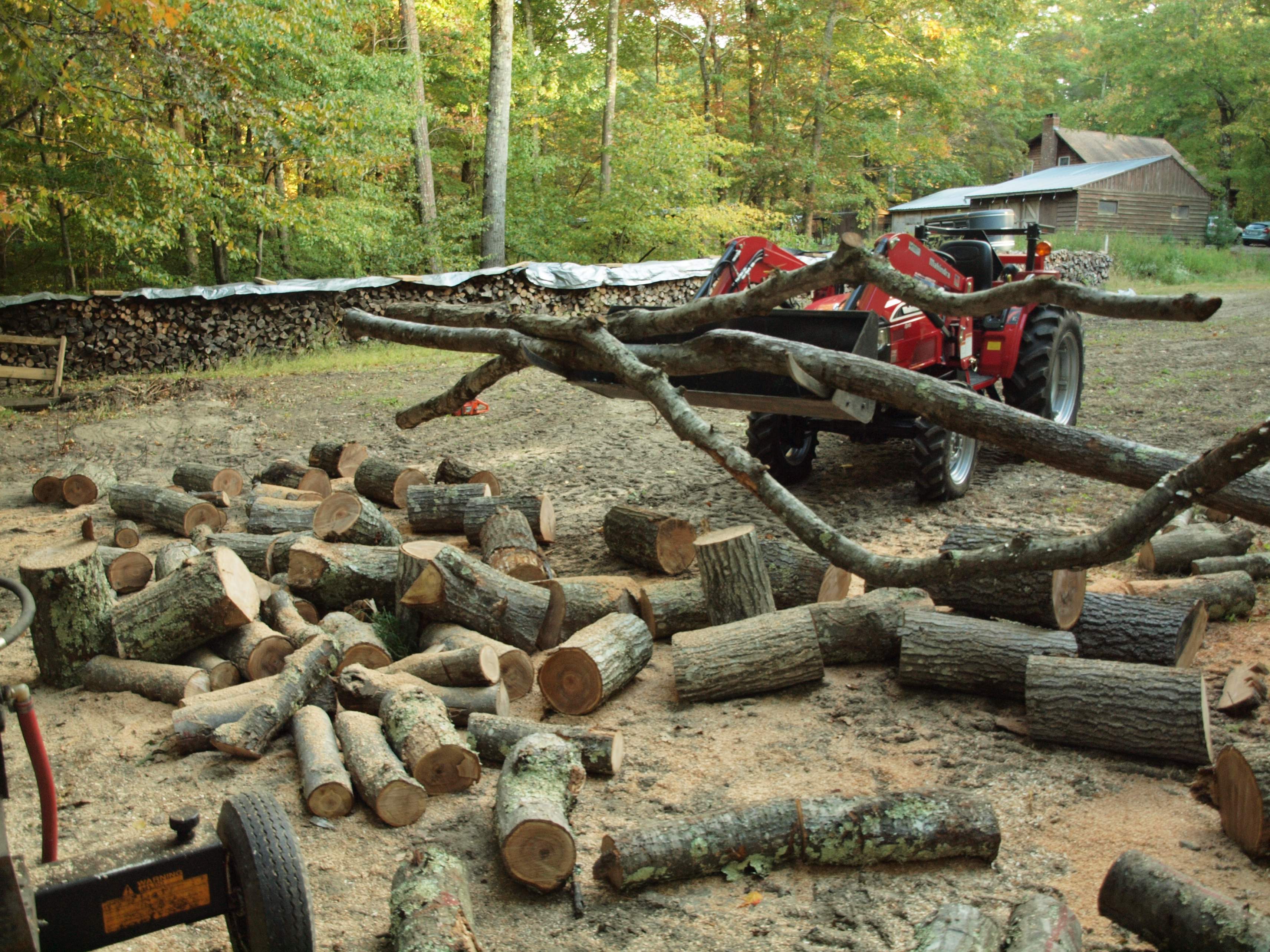

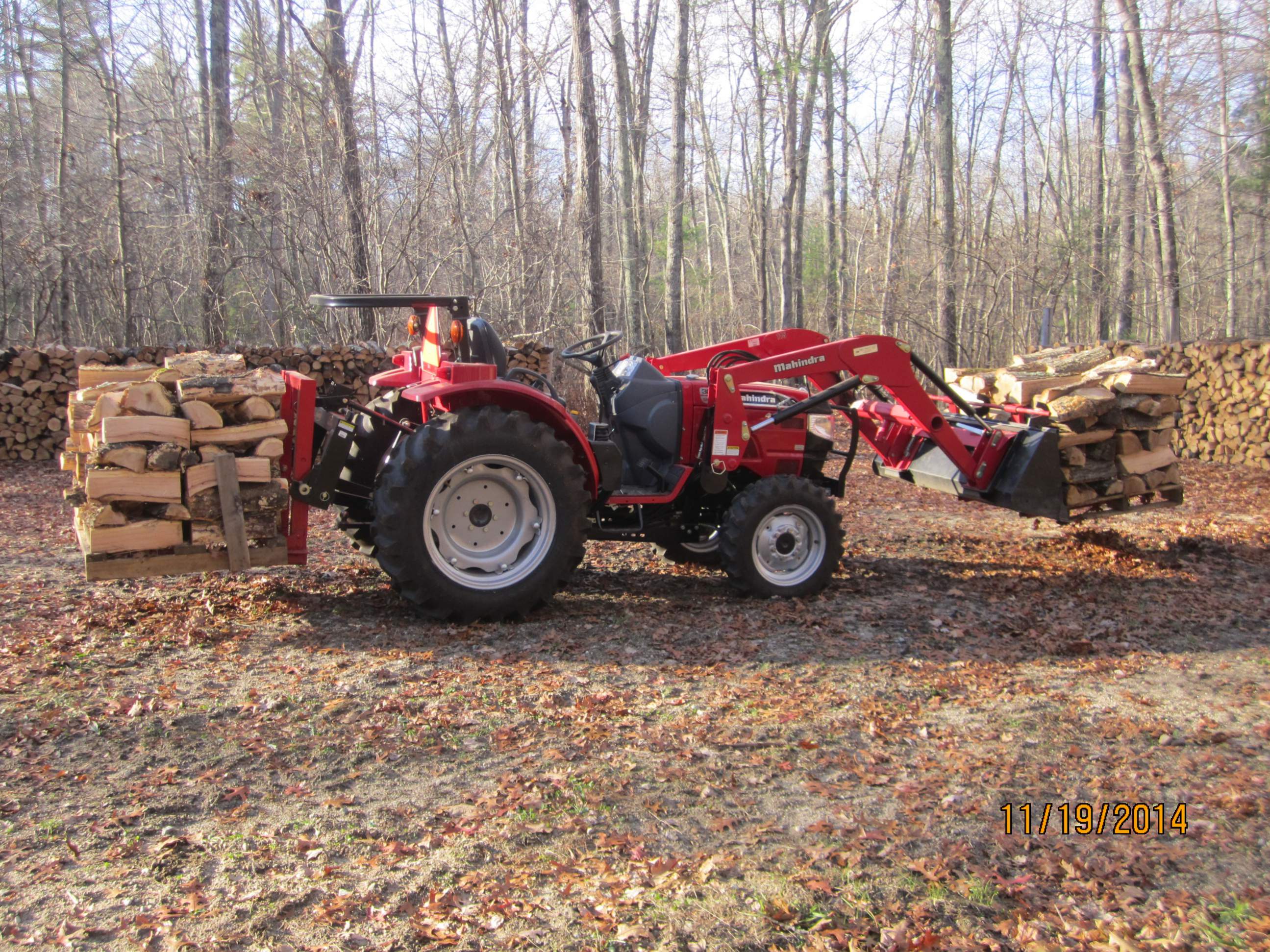

I have the Mahindra but through default. Yes, I thought there are better built machines but none of these suited me. 1. Kubota has their fel control in the way for a both side exit/entry tractor. This was important to me as I need egress from all sides as I log mostly with the tractor. My woods are tight so I need to be able to get on and off from left or right. Also, I did not like the way Kubota L3 series exposes their tie rods in front of the axle. With all the stick ups and ground obstructions in these woods, I would have made a shamble of these in short order if I did not construct some type of guard. 2. I traded in an old JD 750. The John Deere dealership was showing me $1800 because the thing was in showroom shape even after 28years. The Mahindra dealer was giving me $7000K.
Will the Mahindra 3016 hold up? Who knows but it has done everything I've asked and more. I think the gear selector is kind of clunky and I have seen thicker metal on other machines but this shuttle is easy to operate and provides great traction and strength for what it is so I'm tickled about that. The last thing is that the Mahindra can lift a lot for its size which comes in handy for how I use a tractor.
