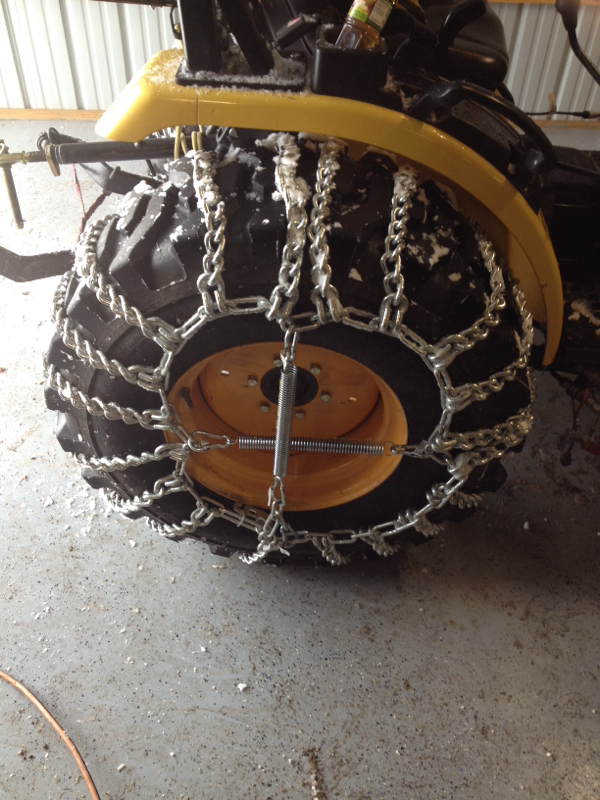

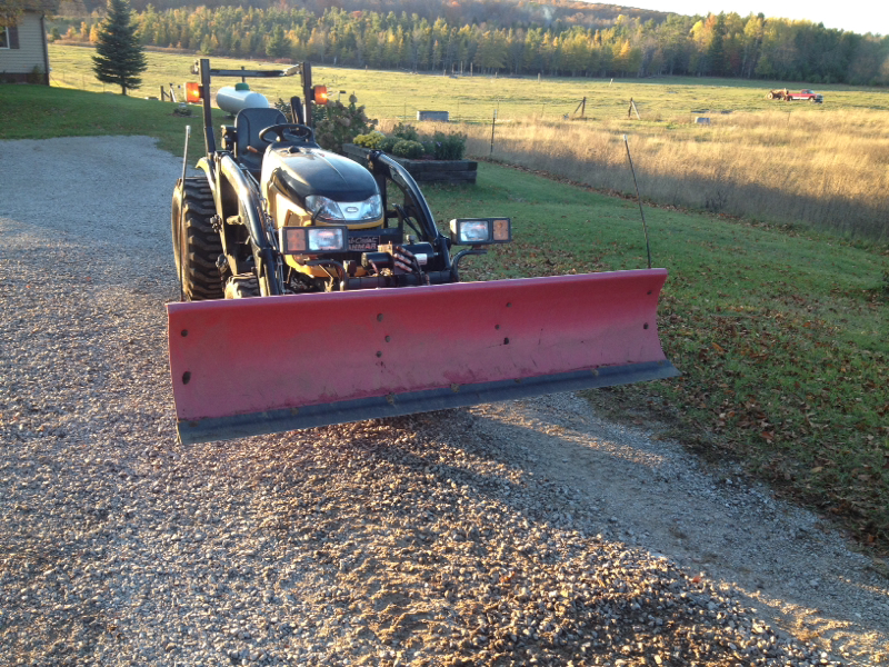

I live in the snow belt in northern michigan. In December alone we got about 60" this year. Our average winter snow fall is about 140". This is my first year with this setup. Here is a pic before I got the chains on. And one of my chains. Sent from my iPhone using TractorByNet

Looks like a nice set up. I think I have similar snowfall here. Thanks.

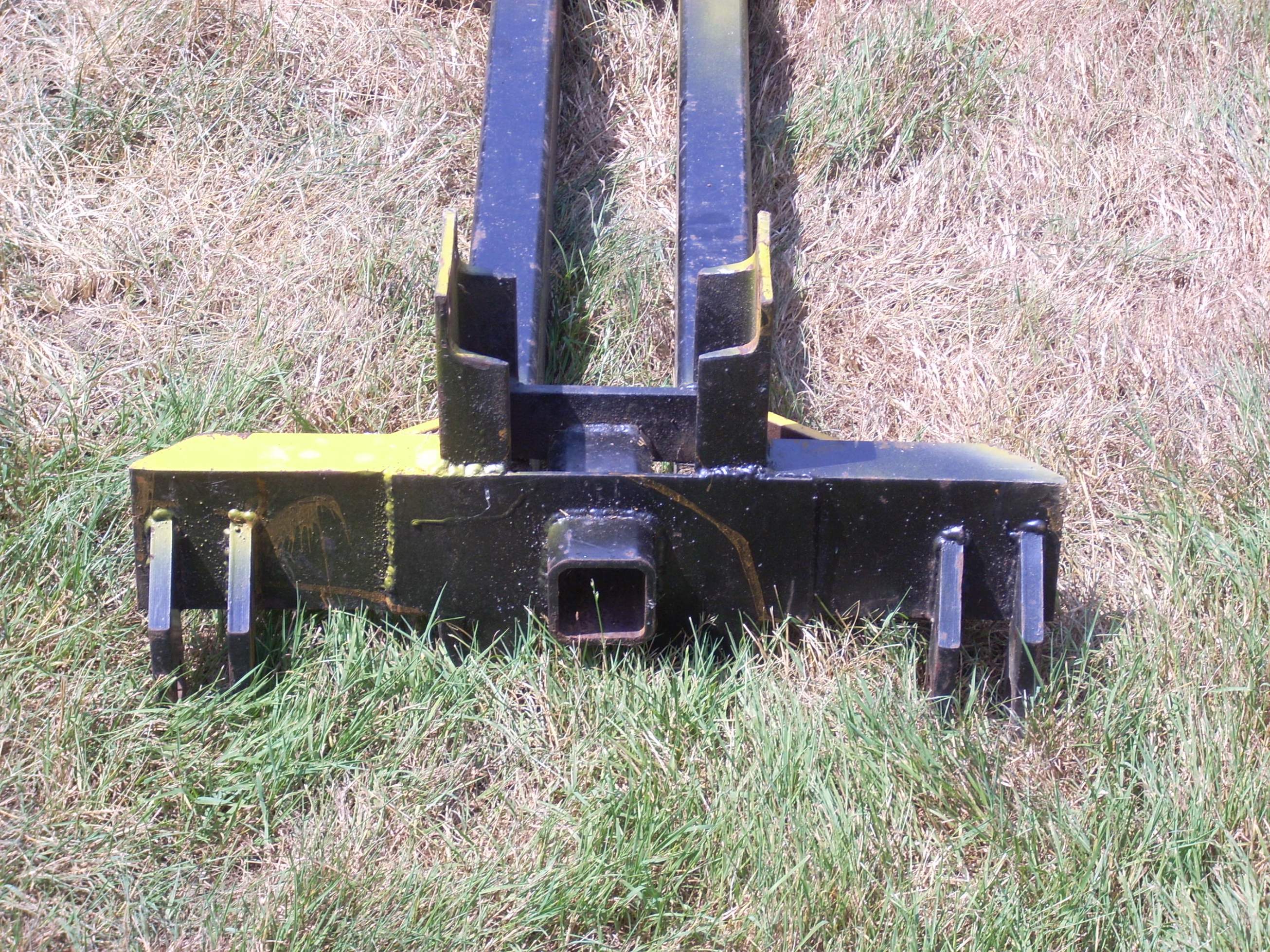

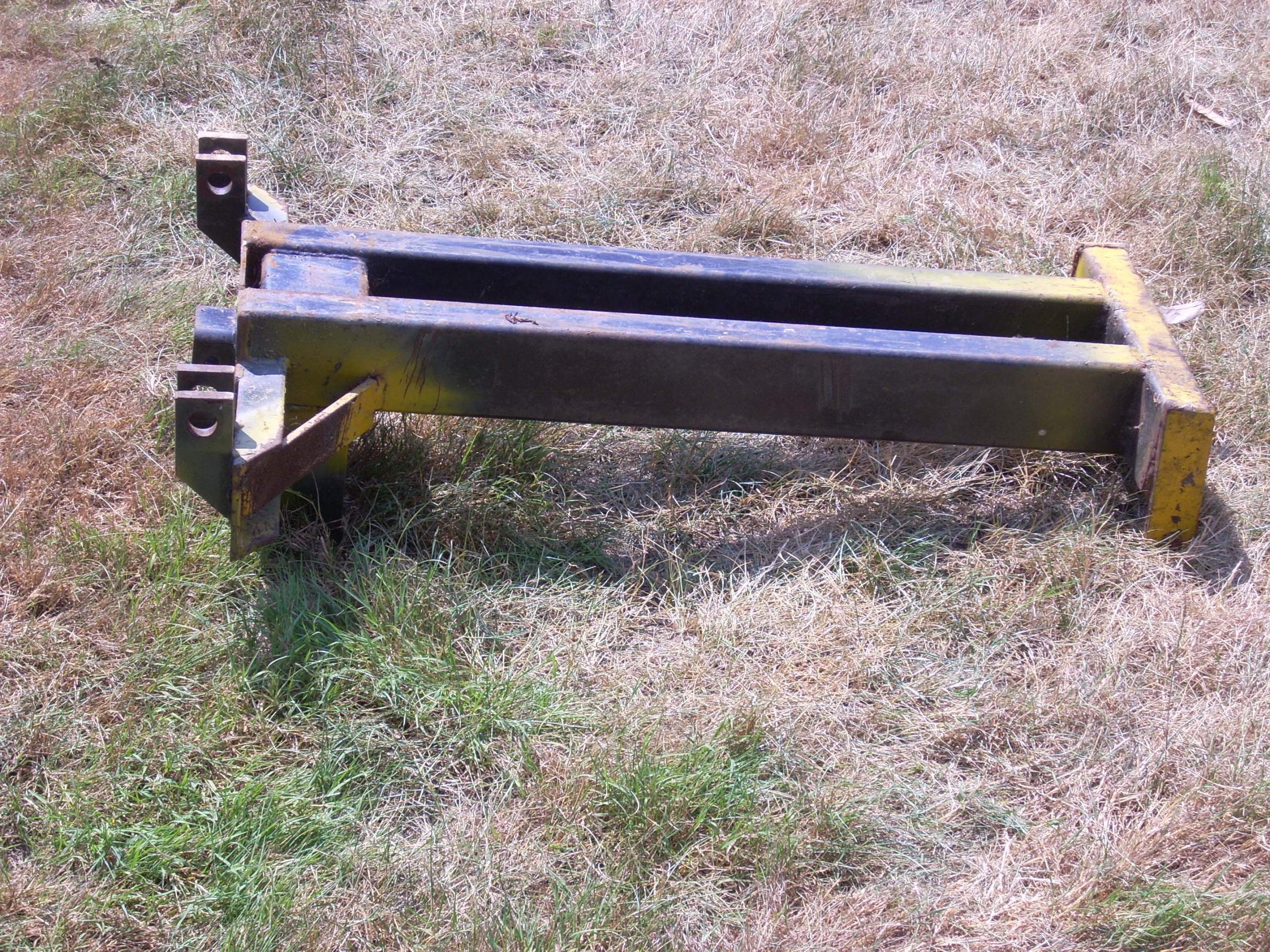

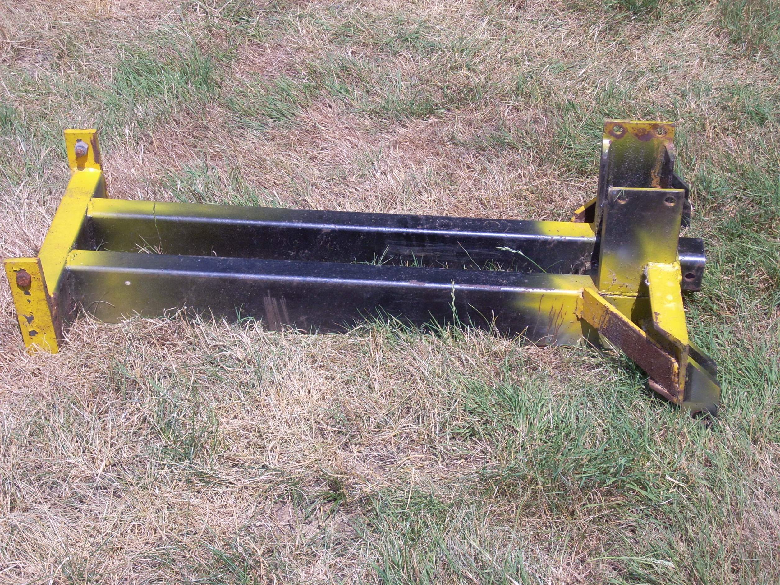

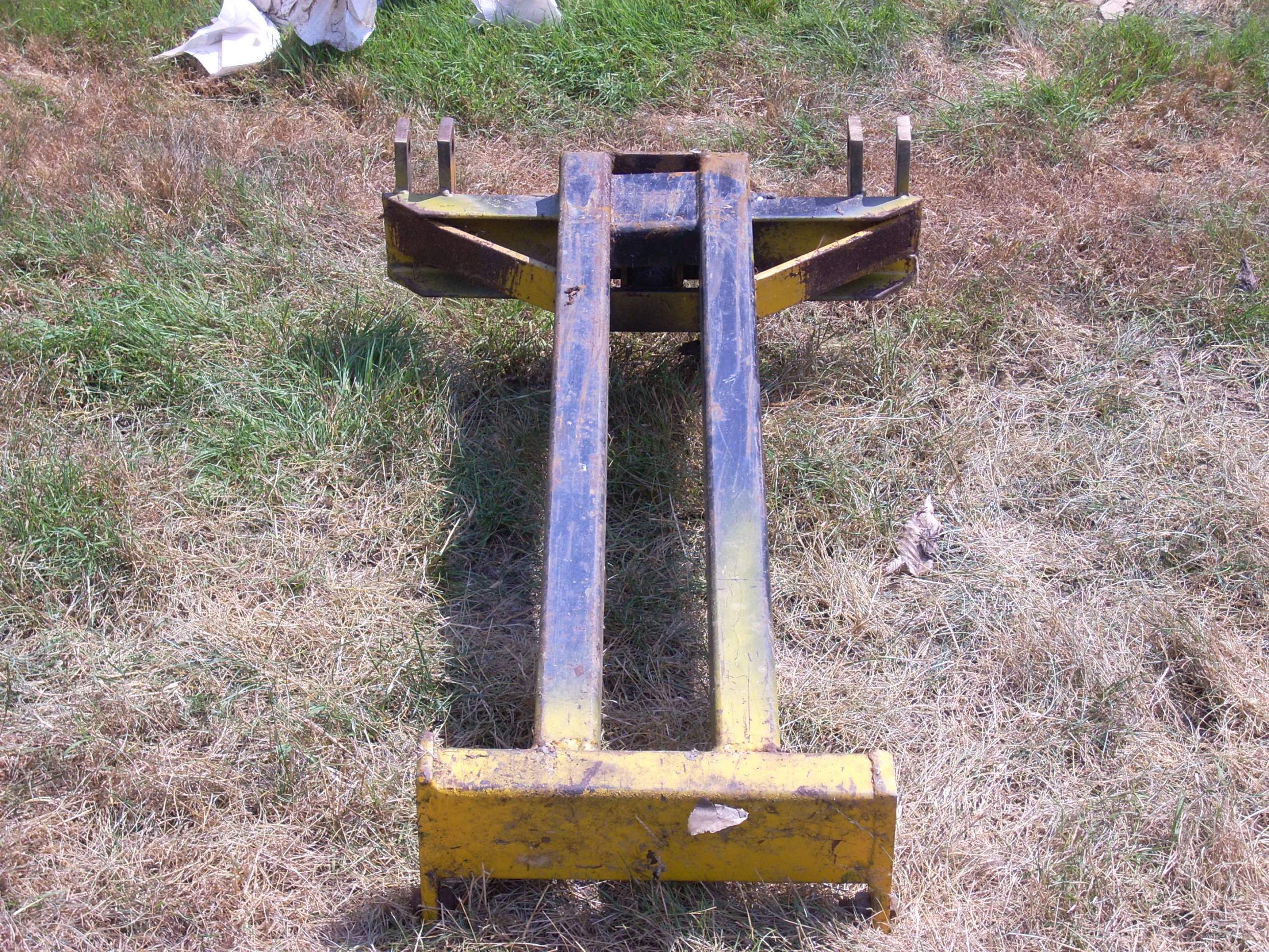

This is the Sub-frame from the b7510 we used to have. I think there are pictures still on here.
Plow Mount Build Thread
North- I'll have to get some of the L3400 though. I built it specifically so that I didn't have to mount it to the loader arms. I felt it was much strong connection and it made manuvering a little easier as well. I wouldn't ever put a plow on a Quick Attach unless it was on a skid loader. I have used the subframe for 3+ years now and It will easily push a 7.5' plow till snow is rolling over the top. I can still stack snow pretty high and I have no issues running into a solid bank and pushing it back with the way I have it mounted.
Let me know if you want any pictures. The only I would change is that I built the lift post out of 1"x1" tubing and I bent it one morning when I picked the plow up while it was frozen to the ground. :confused3: Lesson learned on that, bump it first to break it loose then lift it! lol
