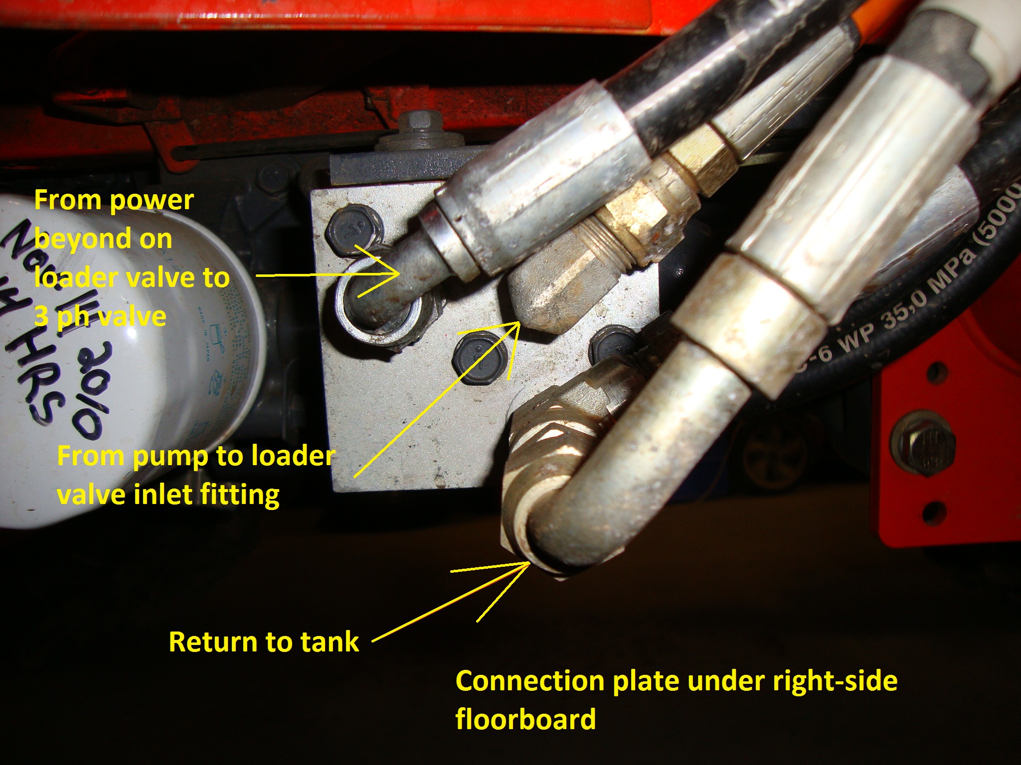

   / Kubota L3400HST 3-Point Lift Issues #18

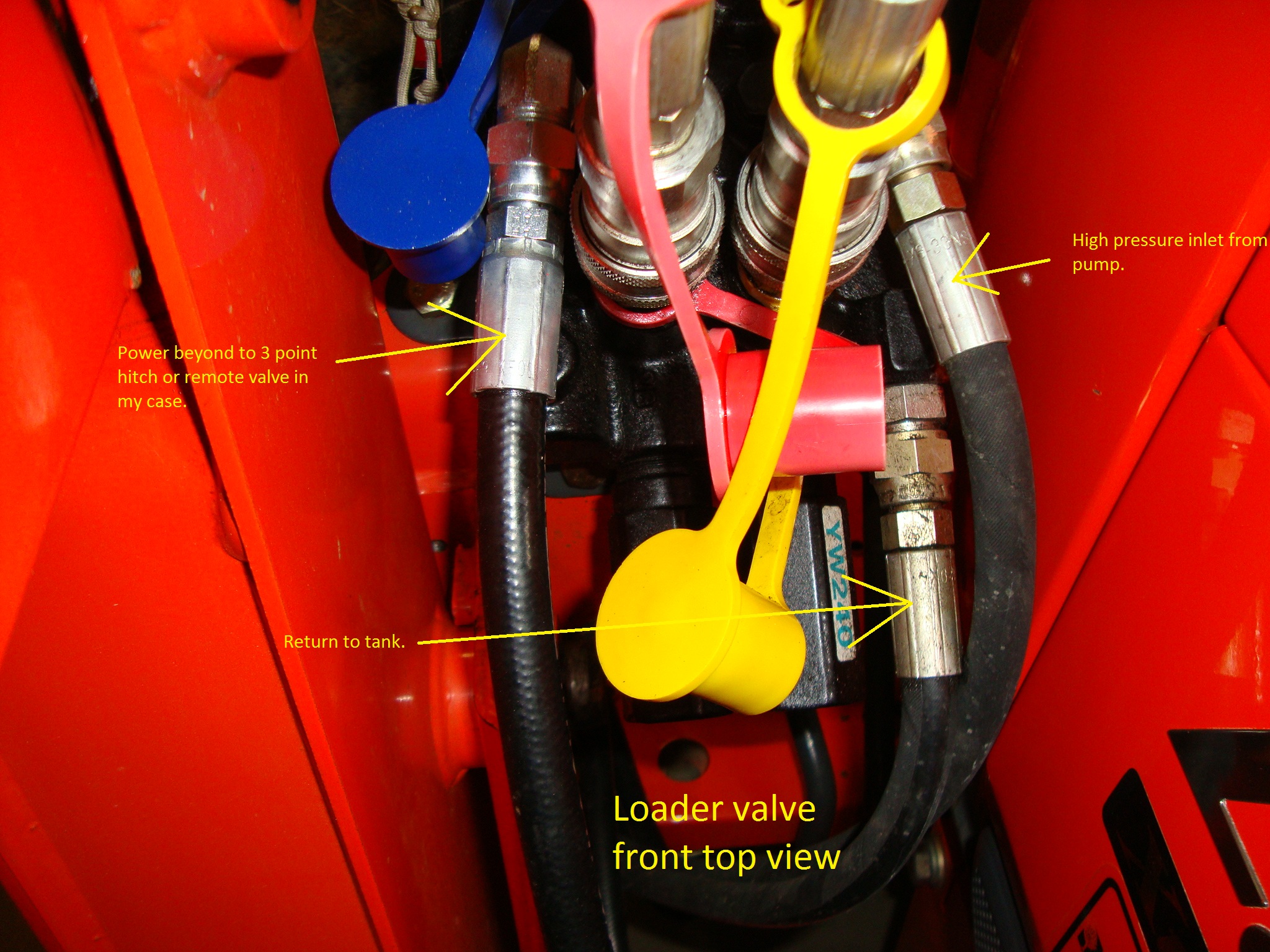

The attached pictures show where the connections should be for the loader and 3 point hitch. The three hoses shown terminate at the connection plate under the right side floorboard, and at the loader valve. The fourth hose (remote return) in the first picture is tee-d into the return line loader valve, and isn't a factor.
I have a rear remote connected between the loader valve and the 3 point, so the outlet from the power beyond on my loader valve goes to the inlet of the remote valve. Yours should go to the 3 point connection as shown in the pics.
Sean

   / Kubota L3400HST 3-Point Lift Issues #19
In these pics the green arrows indicate fluid flow direction.
It might be worth checking the system pressure, at idle it should be no more than a couple hundred psi, if that, as long as nothing is being operated hydraulically. If it's going over the relief valve all the time it'll be about 2200 psi.
Sean

   / Kubota L3400HST 3-Point Lift Issues #20
Great pics Chilly807 just what was needed here :thumbsup: ...BLane3400 do you see the top two hoses in the pic with the silver block? The loader will work with those hoses swapped, but your 3pt lift will act like you have been saying.
When you take this loader off, does the loader valve stay with the tractor? I think from looking at the pictures, that I assumed that the valve stayed with the loader. I apologize if I confused you. :ashamed:
