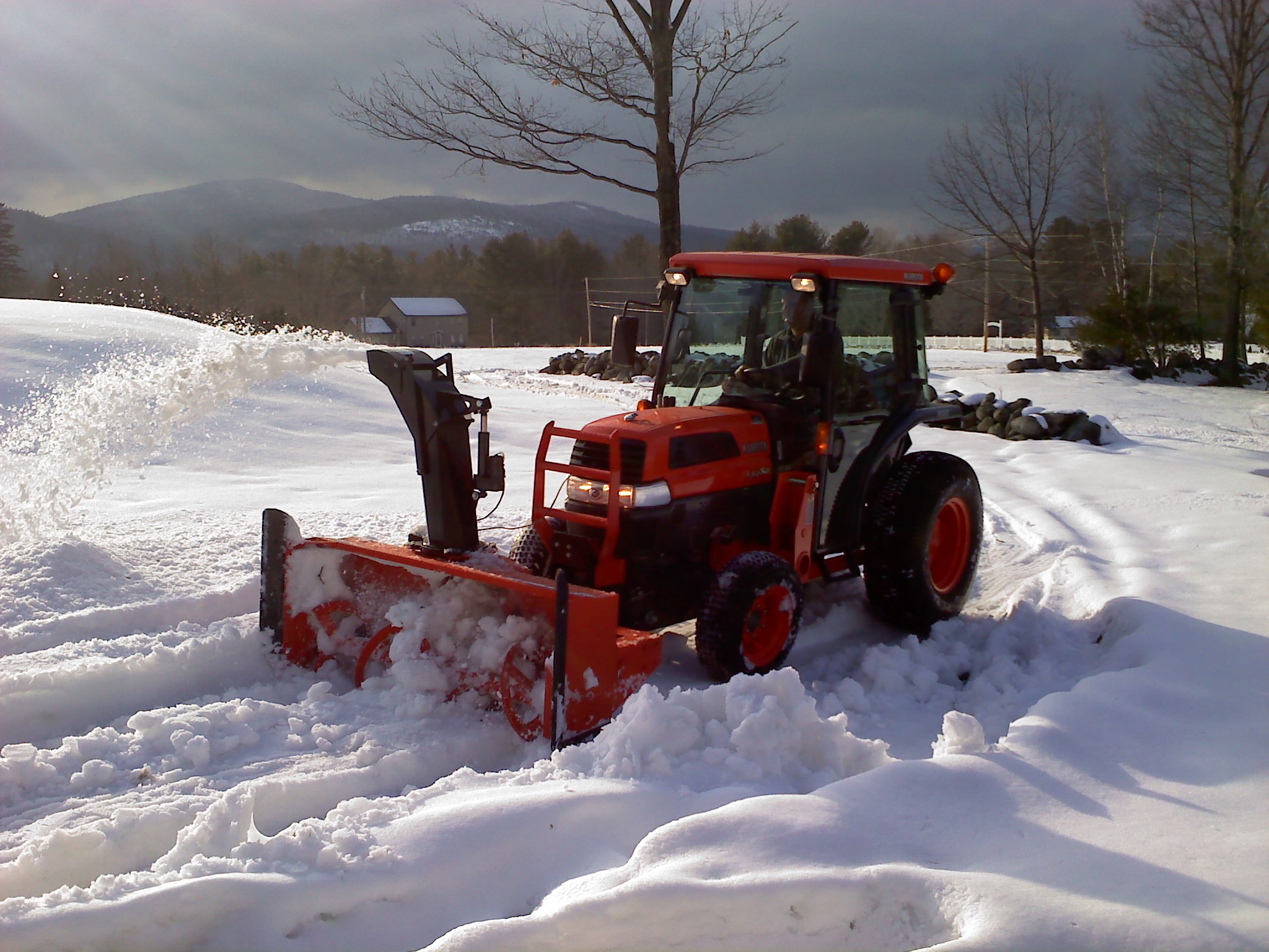

I have an 05 L3430 HSTC with a front mounted blower. It is a great tractor and real comfortable.
The blower mounts on a quick attach frame and uses the mid PTO, it throws snow a country mile because of higher RPMs on the mid PTO!
I just saw a great deal on a used one last week. I will see if I can find it again.

Can you or anyone confirm if the second stage is 1 to 1 with the input. What I mean by that is if the Mid PTO is 2000 RPM, then the second stage is spinning at 2000 rpm which is REALLY Fast. My current kubota blower is 1 to 1 therefore it spins at 540 RPM.
