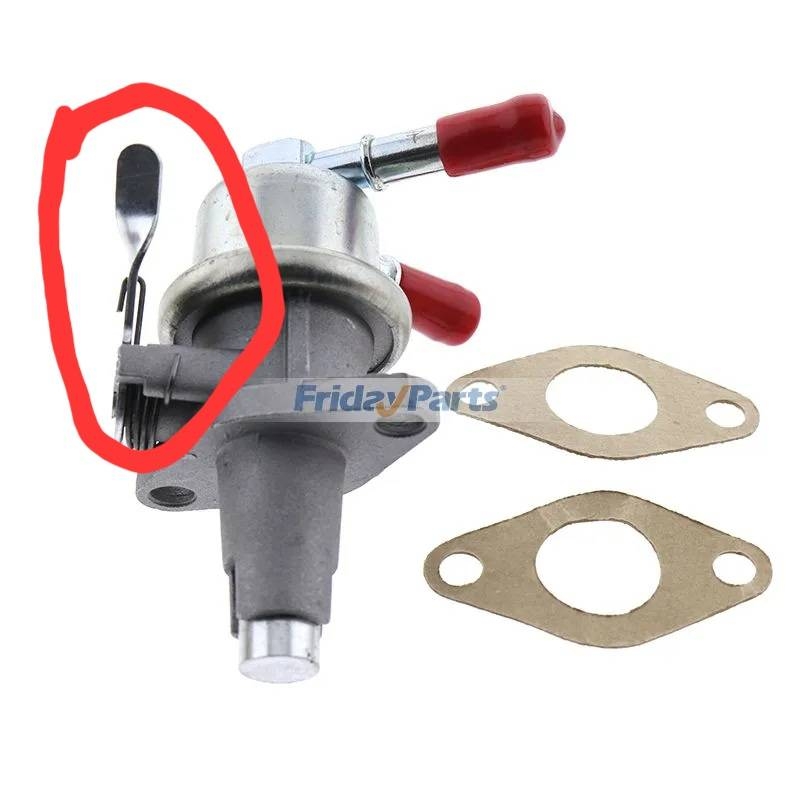

Do you have a lever on the lift pump to manually pump by hand? If so, open the bleeder and manually pump until you get a good clean flow of fuel out.
Then close the bleeder and crack all the hard line nuts at the injectors.
Crank until you have fuel coming out, then tighten the injector lines.
It should start.

No manual pump on filter, thanks for the thought
