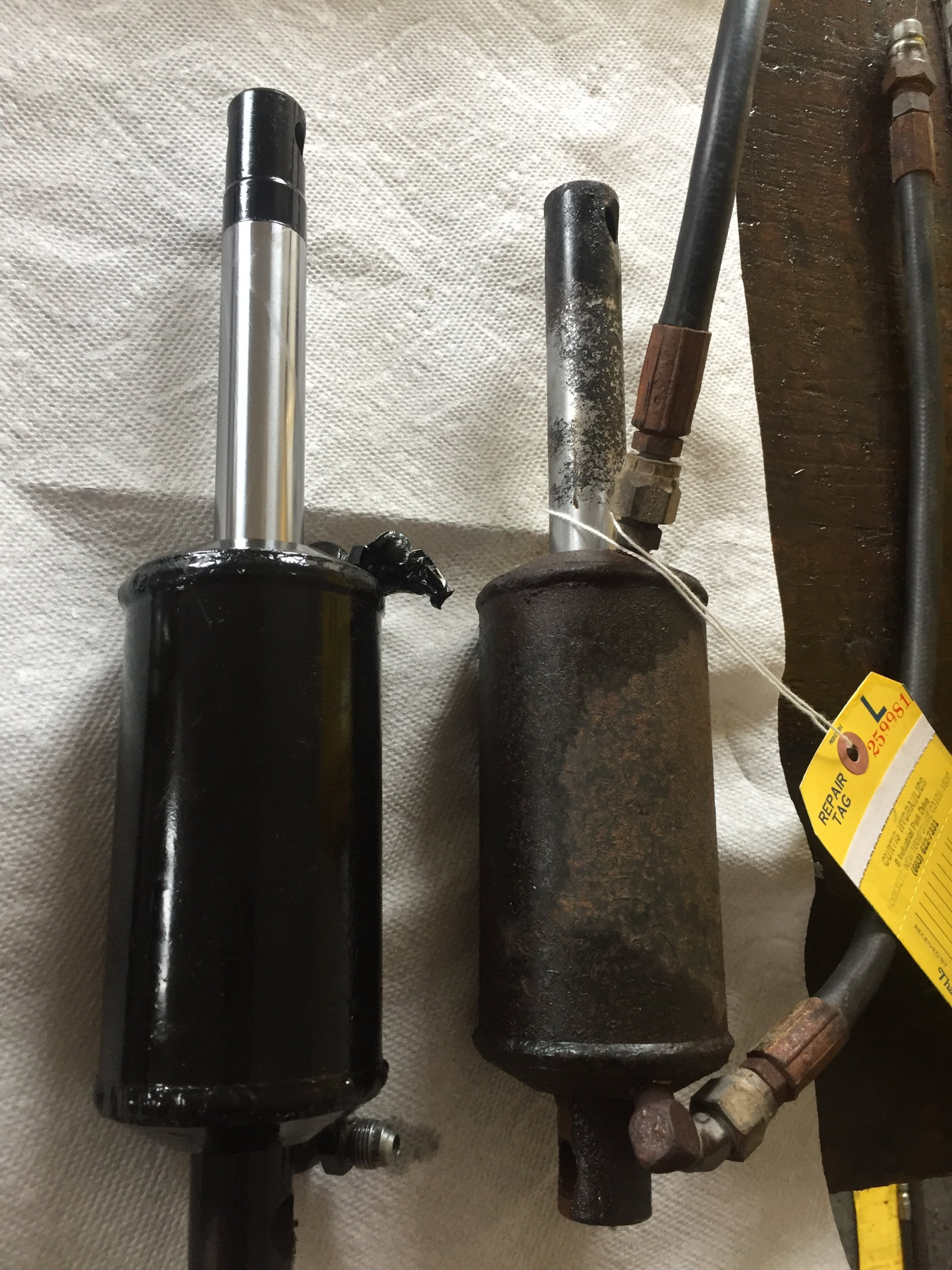

   / Kubota L3710 Steering Seal Fix? #7
The high price of replacement parts is what keeps independent hydraulic repair shops in business. I had a steering cylinder rebuilt about a year ago. I think it cost about $200.
   / Kubota L3710 Steering Seal Fix? #8
“I assume these cylinders can be repaired. Is that right? My little John Deere was made with a cylinder that was welded shut at both ends.”
Yes, assuming your local hyd shop is capable and ambitious
