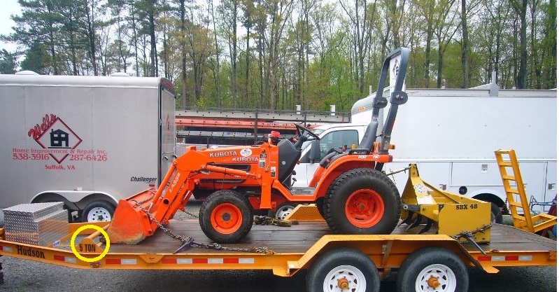

I could never figure out why Hudson put the 5 ton marking on the trailer. Most trailer manufacturers state their capacities as GVW.
See the yellow circle.
But it seems most troopers ignore my trailer. It's only 5 ton, says so right on the trailer :) Plus weighs 2,000 lbs.
When I first hauled it home it was with an '88 Ford F350 maxivan with 8,990 lb towing capacity, definitely not "legal".
