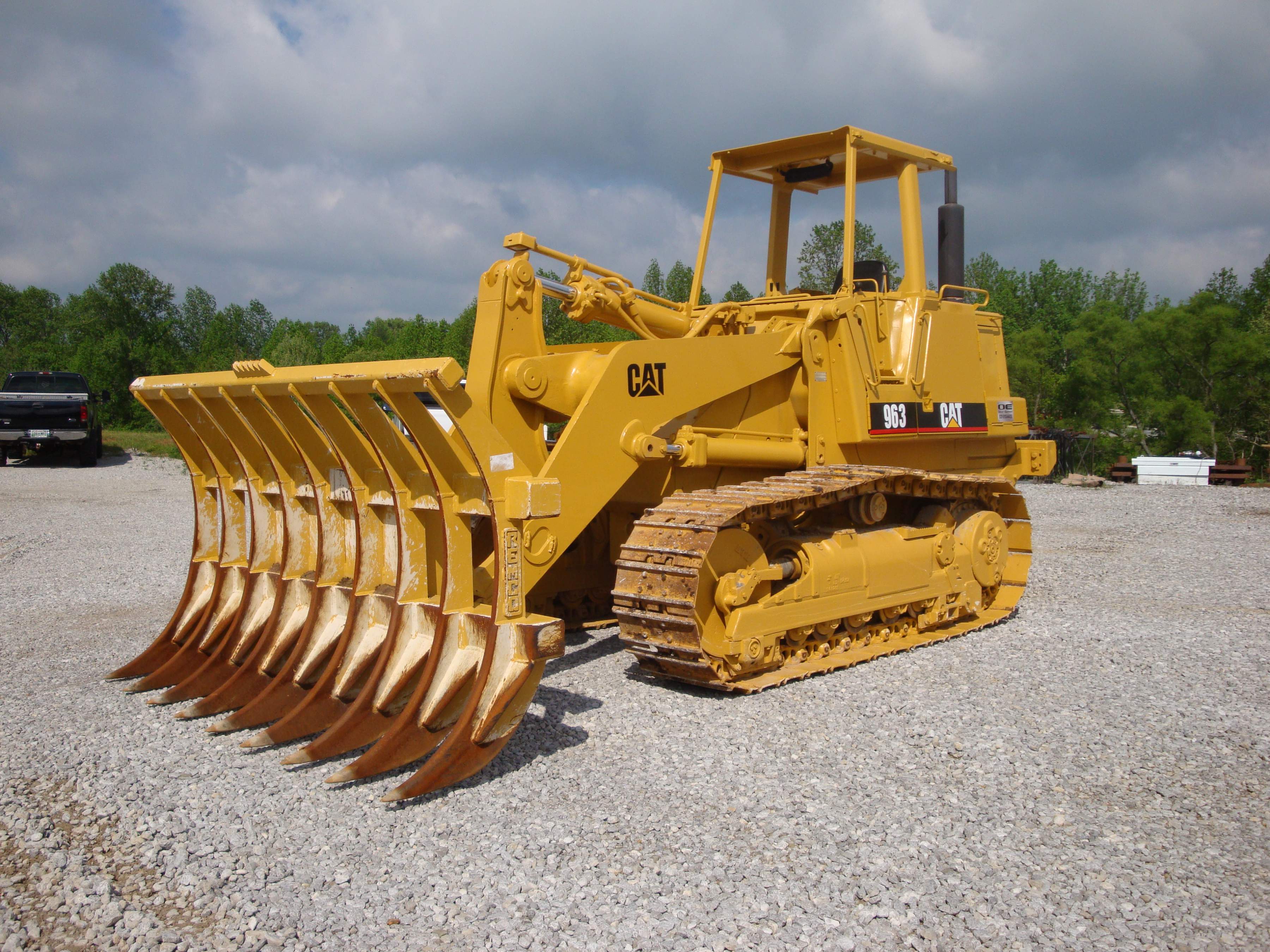

If it were me, I would rent a track loader and clear what you need...It may sound like fun and an easy task to clear land, but it becomes real old, real fast. Clearing brush and stumps take a lot of horsepower and traction....Butting trees with a Tonka toy that is not designed for such will be a nightmare and dangerous...Once the rough work is done, you can use your new tractor to clear the light leftovers. Some may say a dozer is better, but I can do what a dozer can do with my loader, its just a little less push

I post there to......I think we have some kind of dysfunctional affliction......Wife says I never grew up.. When I bought the track loader..first thing she said "What are you going to do with that thing",, She just doesn't understand. Wish I had some neighbors like you folks on here.. man could we make a mess real quick
