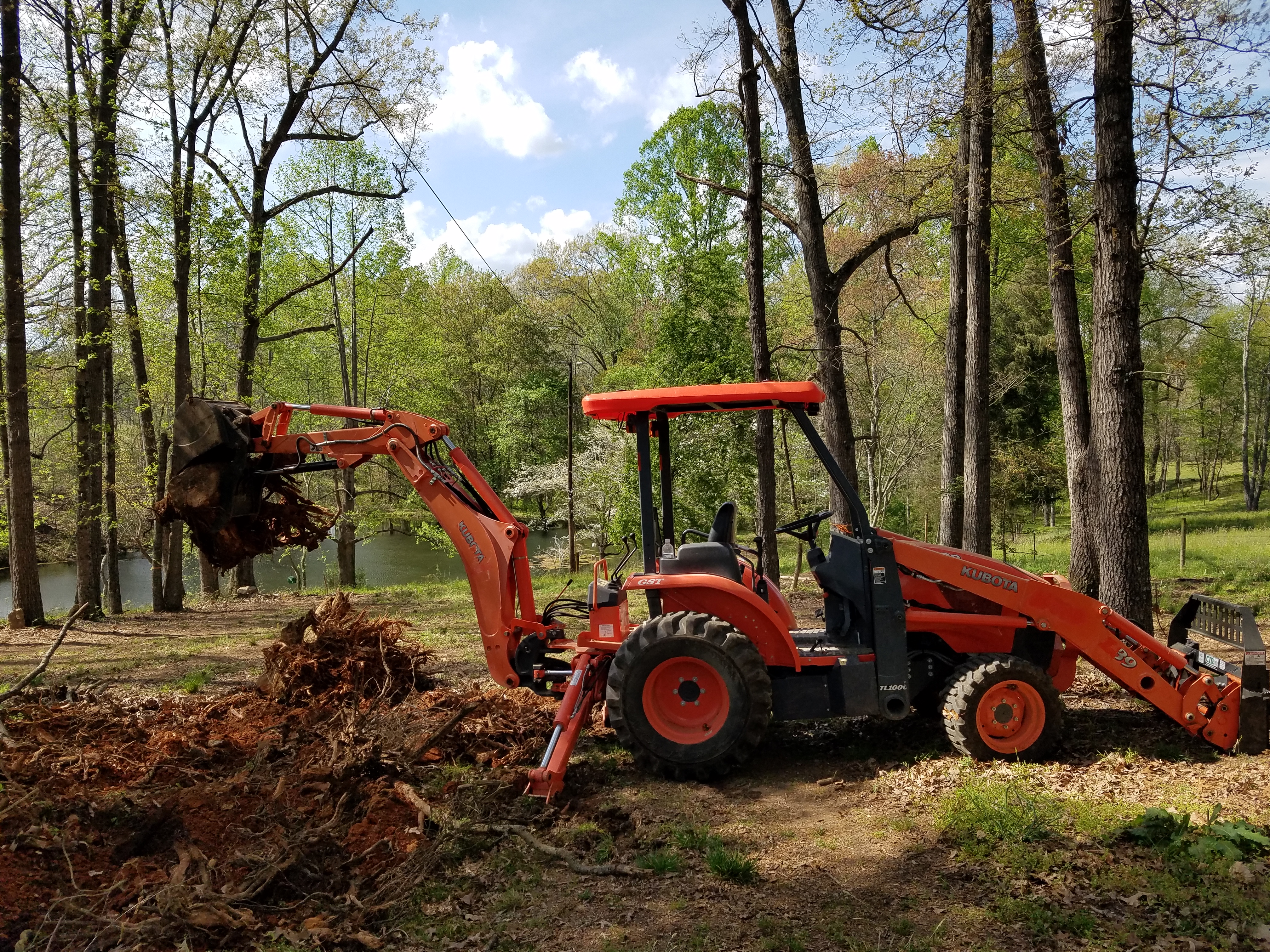

That looks like a nice machine.
I have it's slightly older/bigger brother 250 hr. L48 TLB
I bet that thing is a brute. L47 or L48 was my first interest, I wasn't able to find one.
Still payed out the a$s for my L39.
