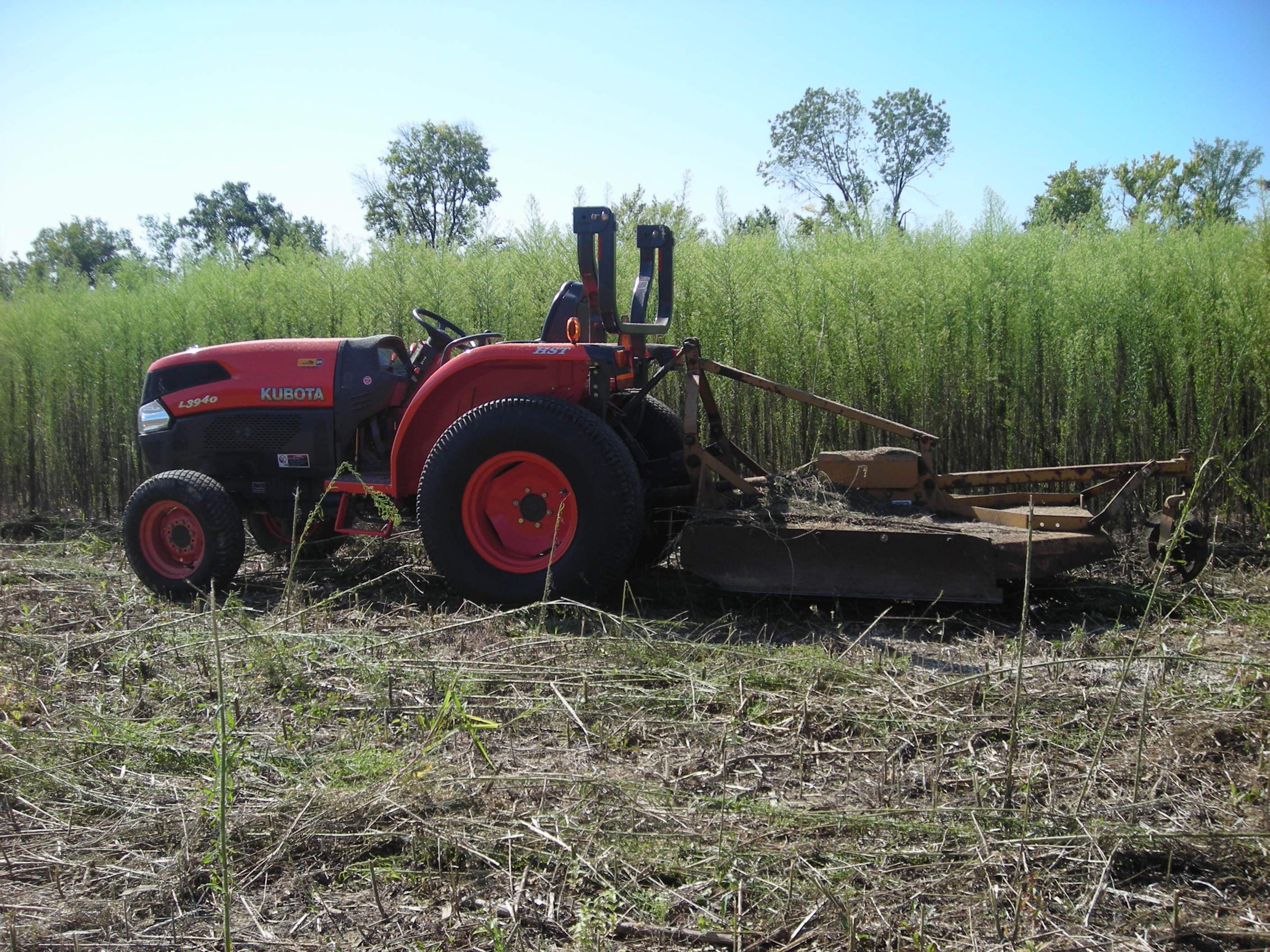

I am sorry to hear about your problems, but how did you over heat tractor? You have a temperature gauge, an idiot light, plus the screen on the intelli-panel that reads 'OVER HEAT - STOP ENGINE'. How could you miss all 3 things telling your engine was getting hot? I understand your problems. When I mow this on a 100F degree day I have to stop about every 30 minutes to blow my coolers and screen clean, plugs up in no time at all. I keep a close eye on the temperature gauge, don't want to overheat a good tractor. Good luck. Philip.
