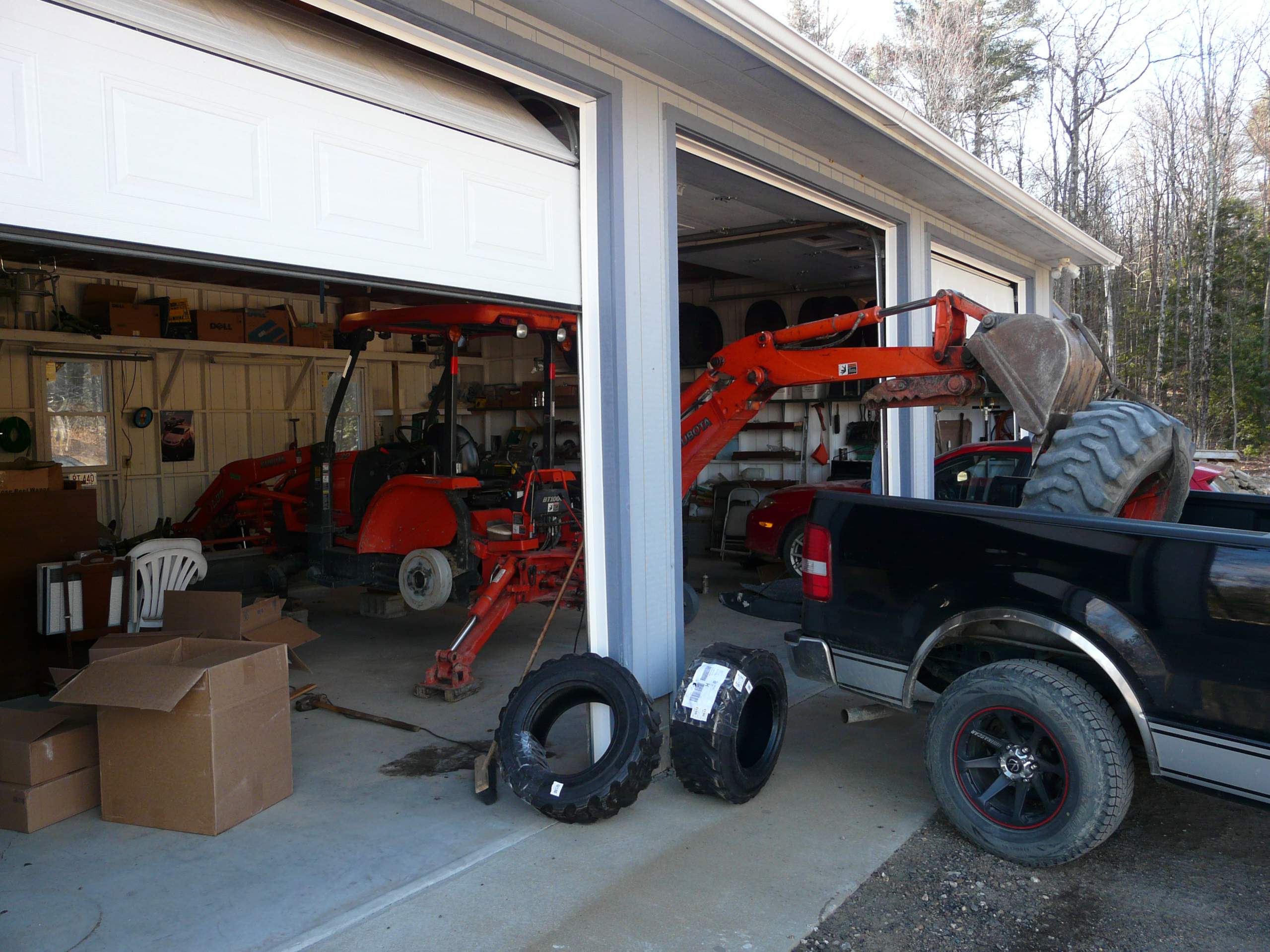

Mike,I am guessing you have wheel spacers on the rear axle.If so,how thick are they and what do you think the minimum thickness would be that would still allow chains?
   / Kubota L39TLB access #13
I have inner & outer wheel Wieghts to add another 750 Lbs to stablize the tractor.
1 inch spacers are enough, 1.25" would be better.

   / Kubota L39TLB access #14
Show off :)
Placing rocks in the L39 bucket with the excavator does not count as lifting them with the L39. But those are impressive pictures.
Granted it would be a we bit difficult to scoop up a pile of rocks that high in the bucket without loading in them in with the excavator, but what did you think I did with those rocks?
I picked them up and moved them 1/3 mile away.
