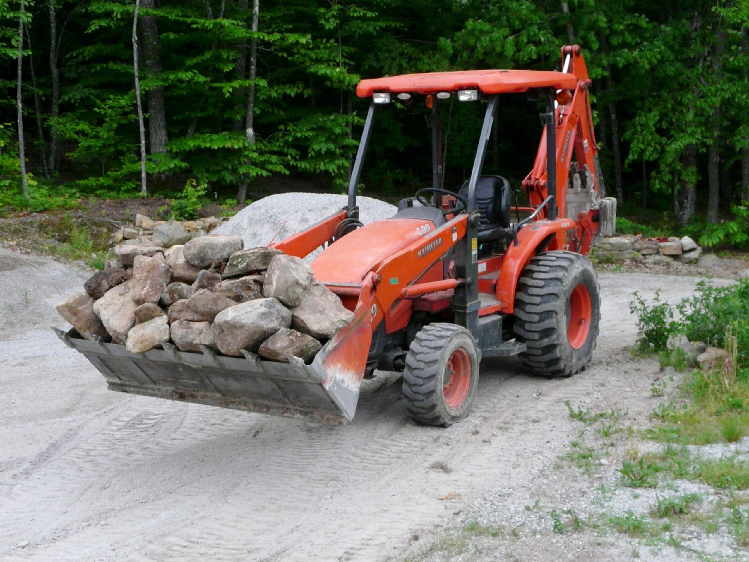

Or be patient and look for a L45 on even the M59. Excavator and tractor would be more efficient, but your not in a hurry? The TLB seines in not a real good farm tractor, but from you description of what you ant to do TLB's are the Swiss Army knife of CUTS.
Ag type CUTs don't move dirt really well.
