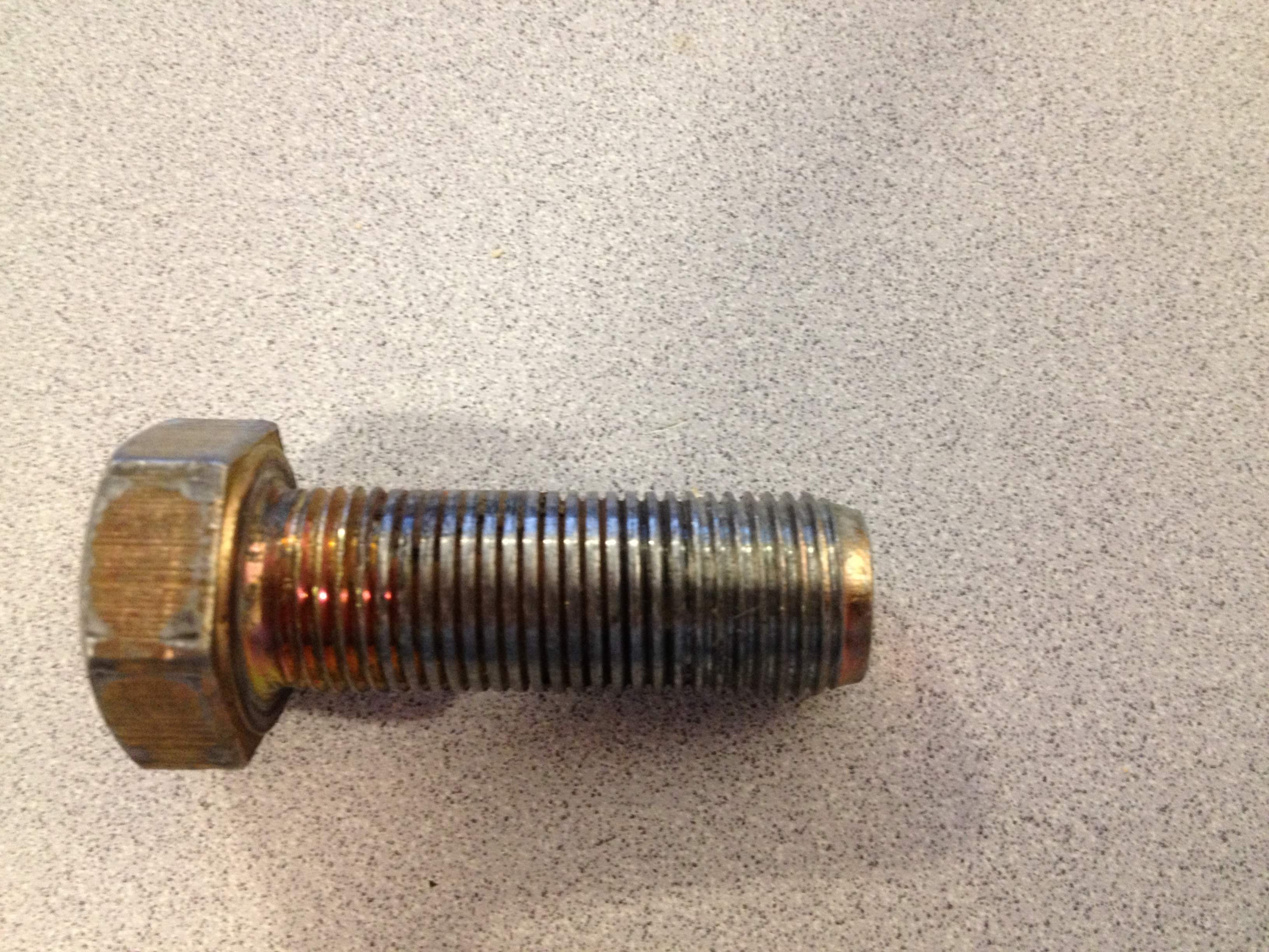

My bolts are only 1.75" long, I took a picture but at my work I am not allowed to access tinypic or sites to upload pictures. The threads in the center of the bolt are flattened.
The bolts are also 8.8 which I am told by my ex-kubota dealer are grade 5 bolts, not grade 8.
I agree with your comments, longer bolts could and should have been used from the start.
I will try the tap / hardened bolt idea first for the M16 by 1.5 and see if I can save what I have with out having to drill out to M18 size.
The holes are not thru holes, looks to me like the loader bolts to the engine or a large casting that is bolted to the engine.
I tried uploading picture of the bolt that I took out - this one is not as bad as the others.
New looking bolt with lots of motion. We really need to identify the problem with your loader setup. If it was only that it was never tightened then putting back everything truly tight will cure it unless parts have been bent because of it. If its poor fitment or missing braces it could be an entirely different or only a compounding problem source. Poor fitment adds up to the same thing as not tightening. The interfaces must fit to each other neutrally so that they are clamped by all the bolt tension rather than squeezed toward each other for the 1st portion of tension. Your assembly may have been hanging on the bolts instead of being clamped by them. -- It looks new. Who did the assembly and how many hrs is on it? If a dealer, or Kubota, did that a few hrs ago you should be dealing with them.
Much better than I'd hoped.... Movement of the loader mount but not much damage from the engaged portion of the thread. And it looks like the bolt didn't even back out much - which is what I'd feared. This is very good so far. From the looks of that bolt you may have caught the problem in time and maybe no lasting damage. If the others don't look too much work just clean out the threads in the block (see previous message), install new bolts, torque well, and continue.
