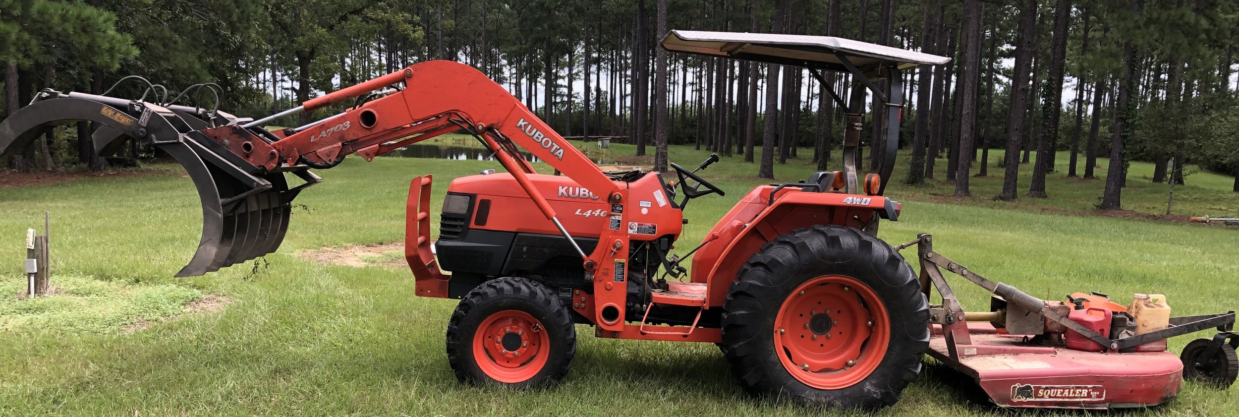

Can an old 06 L4400 be changed out from a manual transmission to a new style hydrostatic transmission?
A prior spinal cord injury, is acting up as I get older, imagine that, the manual clutch is more difficult to use for all day loading/unloading operations due to.... Timber cutters are coming in 6 months.
I checked the new 50 Hp and they will not fit the barn door frames, or about half of my tractor implements, like my 3 point hitch $6k back hoe.
So it is a new barn or barn face and several new implements VS maybe a tranny change out and keep the other stuff as is. Not to mention the catalytic converter crapola mess. Forgot the old has 900 hours on it and I own a tree farm.

Inform us of the width of your barn door frame.
What is the outside-to-outside measure of your tires?
You should be able to find a used L4400 without too much trouble. That is likely the only way you will be able to transfer your Backhoe.

It's certainly possible if you were able to source the right parts and you had the time, skills, and equipment to devote to it. But you told us you have a back issue and a time limit and you mentioned the backhoe price so it seems there's a budget as well; so it doesn't appear very feasible from limited information.
I would concur with the other folks to try to source a matching base unit tractor with a hydro, then sell the unit you've got. Kubota has a sizeable market share so there should be some availability in the market.

I'm sure it's possible with plenty of money but at what point is it worth it versus just getting another tractor?
For starters, you'll need at least the HST assembly and the middle transmission housing for the HST model, that alone is $10,700 for the HST and $1,200 for the middle case accordingly to Messicks. Then you all the little things like pedal linkages, input/output shafts, PTO input shats, damper plate. Probably another $5k to 7k?
Also, it's not uncommon for the range gears to be different on an HST compared to the Gear model. That only adds to the cost.
I'm guessing 20 to $25k in parts, not counting labor and that's just if there is everything you need still available.

I thought I missed something so I reread the previous posts several times. All I saw was assistance. Jeff showed you that the L4400 was offered with Hydro. Sell yours, buy a Hydro unit, problem solved.
As for spending money..... Contact your nearest Kubota dealer and price the parts required to swap your tractor to Hydro.
