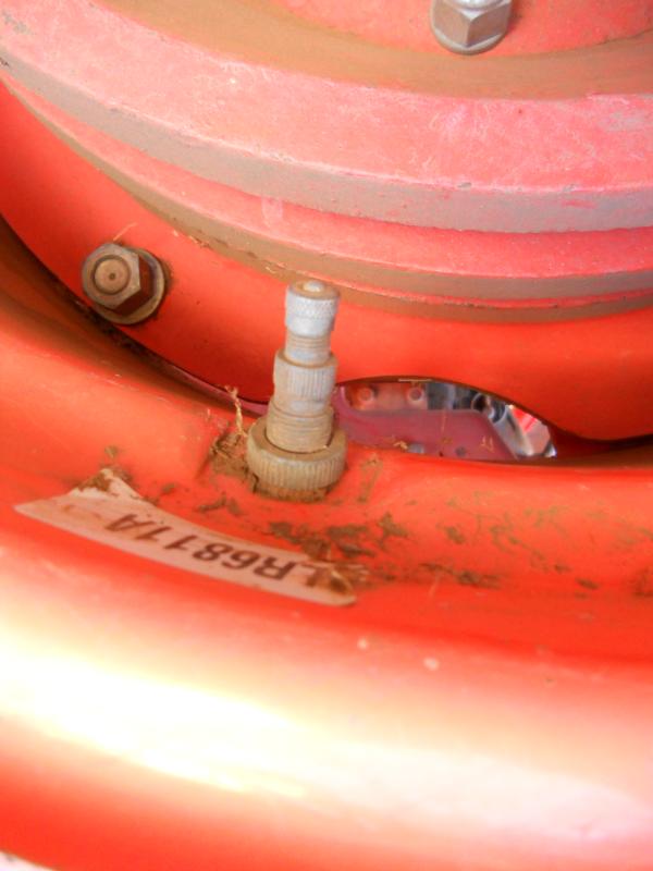

Interesting problem.
To answer the tube/tubeless question maybe you could go over to the other side. Put the valve stem at the top and loosen the nut pushing the valve stem in a little. You should get an answer real quick if it is tubeless.
I would think the plug might work weather it is tubed or not tubed since the tire is tubeless capable. Wouldn't the bead just seal on the rim with a hole in the tube and the tire plugged. The flat would be fixed but you might not want your ballast to escape the tube depending on what it is.

I like the idea, only to find out that the right tire has a different valve stem:
Comparing this one to the one in post 7, I would venture to guess that this is tubed while the problem tire in post 7 is tubeless. Anyways, I did the repair with a plug and it worked!! I waited until tonight and just checked it, and no leakage! I did trim the stubs, but I just wanted to show the repair in progress and the offending nail.
I definitely know more about ballasted tires today than I did 2 days ago. Thanks!

I have an L4400 Kubota with the R1 ag tires and it is a tubless tire. I have several plugs that have been in for a few years. when I plugged the tires it just rotated the hole to the top and plugged it. I did not remove the glycol/ water mix.
