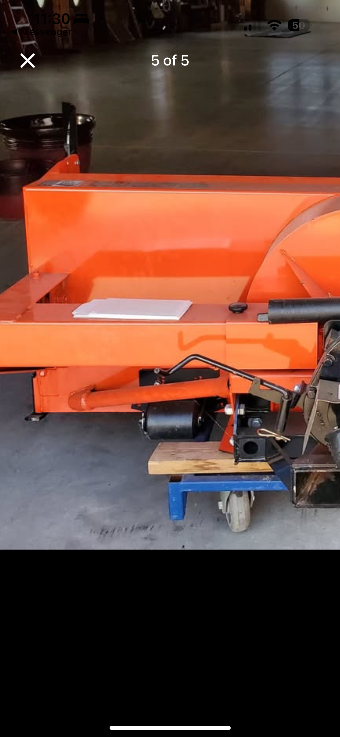

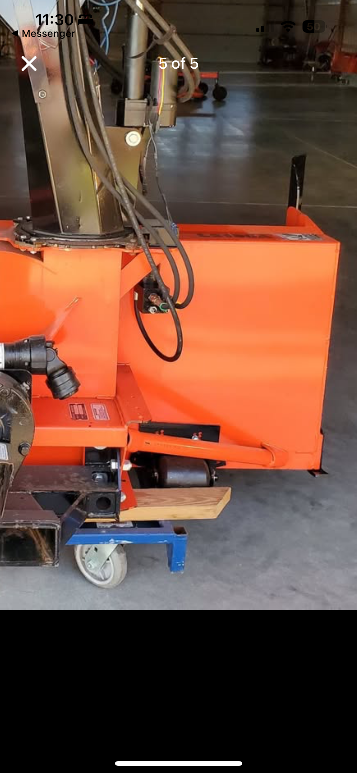

A little off topic, but related to the L4479/ L4474 Blowers -
I just picked up a used L4479 blower for my L5740. While searching for a pre-owned front mount blower, I came across a photo of this blower that someone had installed poly rollers on.
For the guys using these blowers on asphalt, do you run the blower without the skid shoes such that the blower scrapes with the cutting edge? Any issues, or is there any need for rollers like these to prevent from damaging the asphalt?

I don't have a kubota blower (have a pronovost) but i don't worry at all about it dragging on the pavement or the back blade i use. our driveway and shared private road is just that a road and everyone here scrapes with metal- otherwise you are wasting your time. I also run chains on all 4 and occasionally they eave a small mark- but it's NW Montana where ice can stay on roads and drives for months. Also commercial trucks often chain up and will occasionally spin and mark a drive- it's just the way it is
