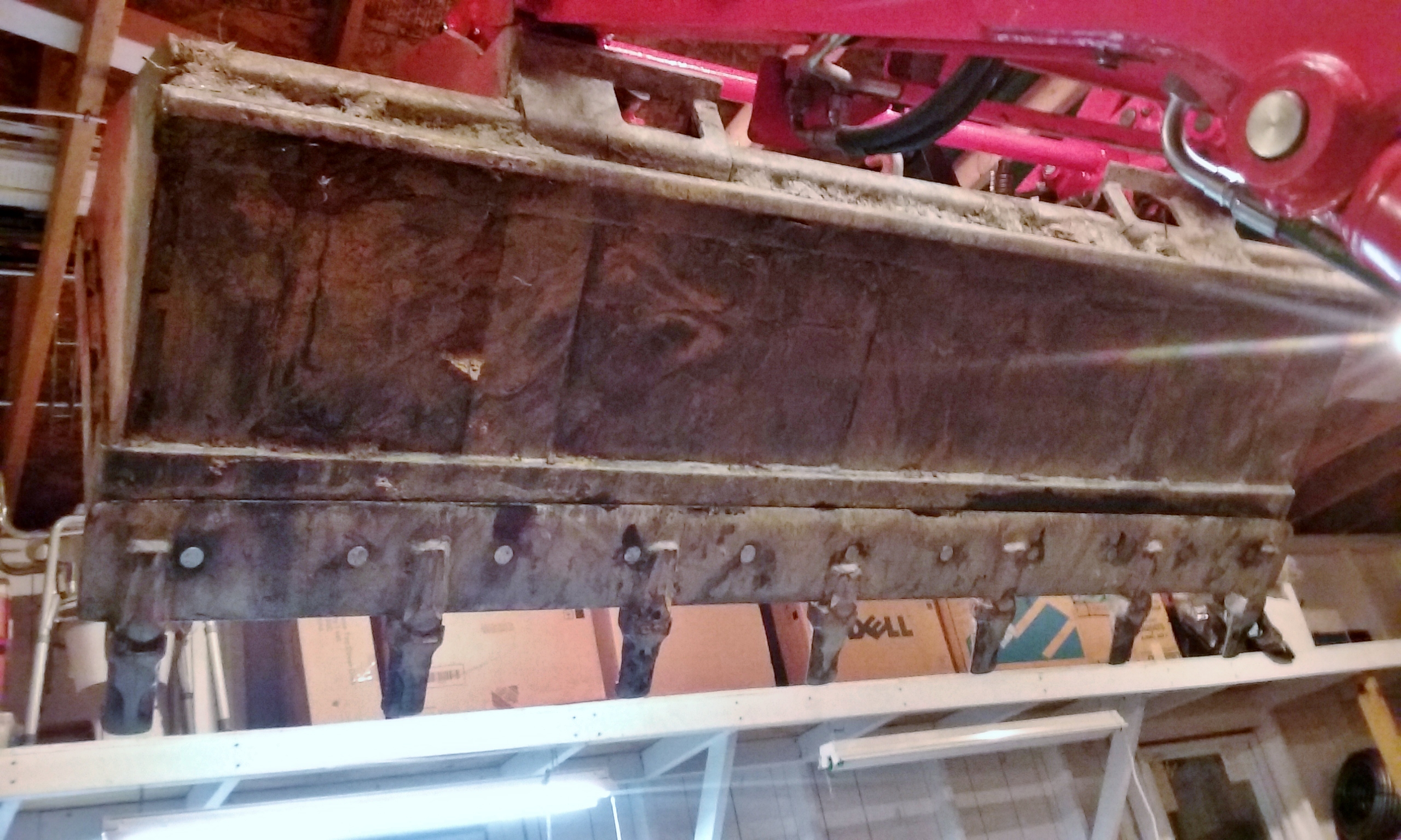

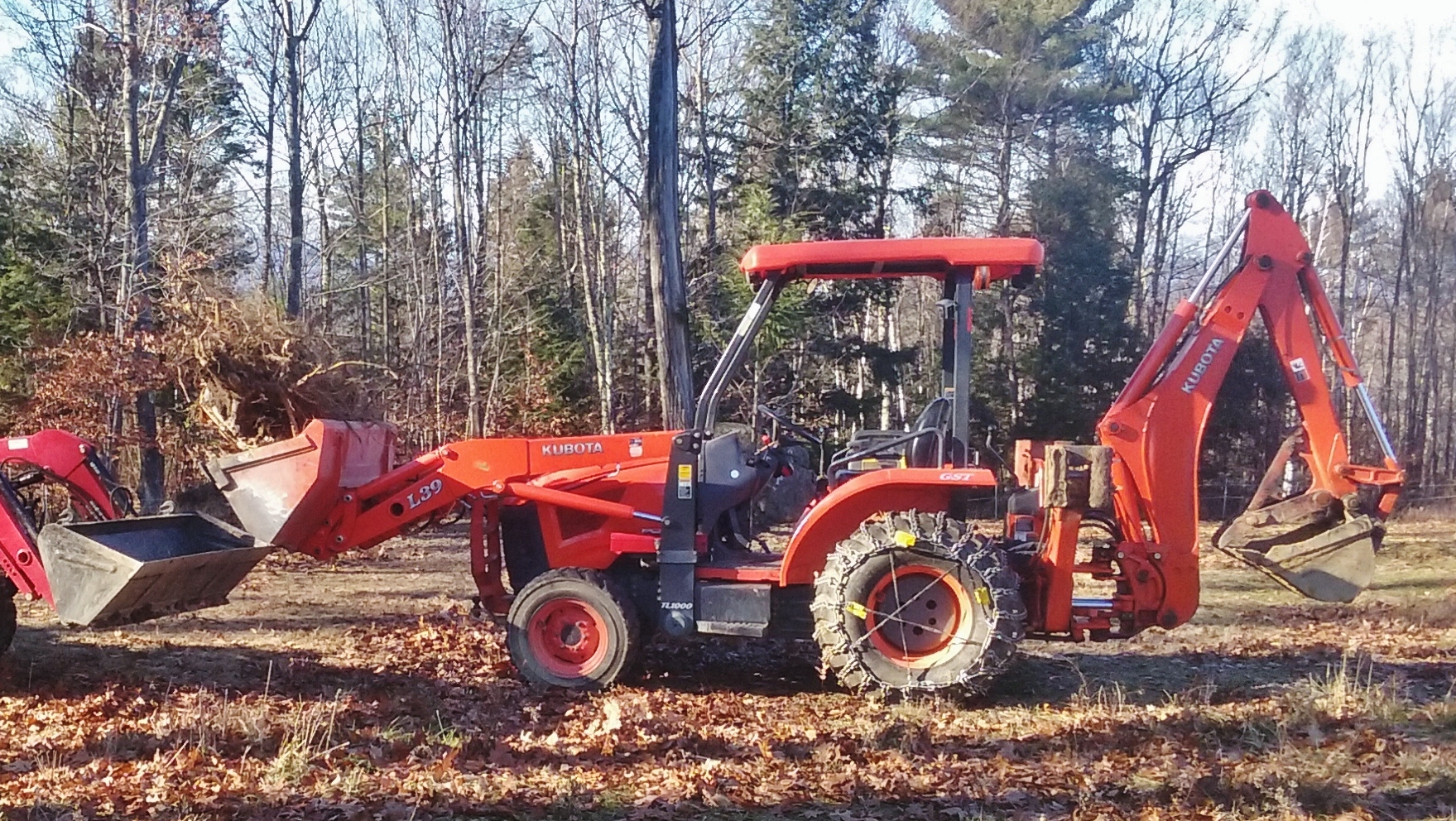

what did you use for the back scraper?
I used hard to find 2 x 2 x 1/2" thick angle and bolted to it a replaceable strip of 1-1/2 x 1/2 Steel. Decent for quickie grading, & Back Dragging, but a land plane is really much better. For the front I have a extra cuttng edge with ESCO teeth.

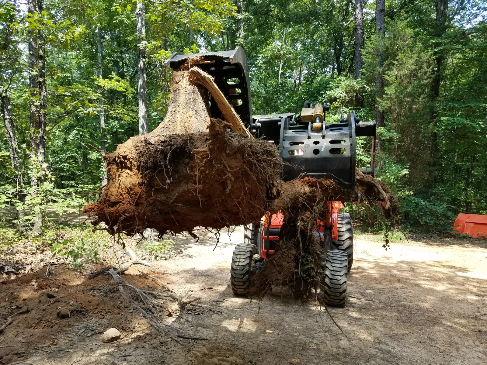

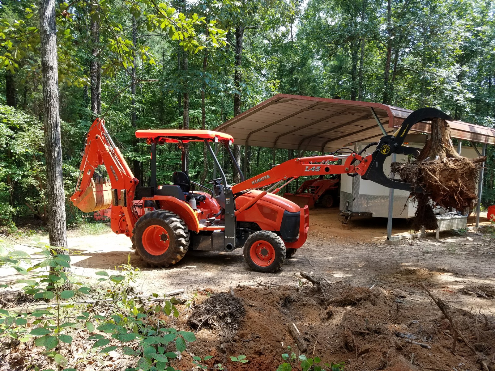

went out today to get rid of a recent dead tree.
   / Kubota L45 #17
L45 Is a great little mighty TLB, if serious 3 Pt Ag. type stuff in not your thing.
