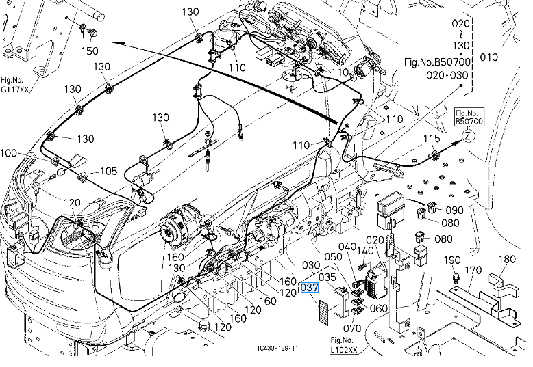

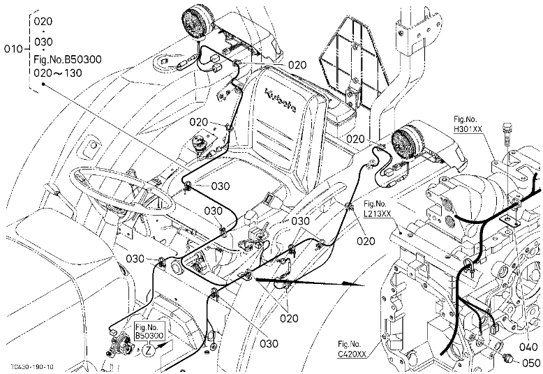

No I don't have a workshop manual, and our cheap multi-meter doesn't work on the setting to check conductivity. I looked at the wiring diagram on Kubota Parts Lookup PartsByNet.com but I couldn't follow it. It is on two pages split between front and back and I couldn't identify the key switch. It looked like the wiring from the neutral switch went to the back lights. So I'm hoping it does kill all power otherwise we still have a problem that could rear it's nasty head at the most inopportune time.

Sorry, I meant continuity not conductivity. Our multi-meter doesn't work on the Ohms setting or the setting specifically for continuity. The reading doesn't change between an open and a closed circuit. We need to get a new one or find the one my dad had.

   / Kubota L4600DT starting issue #20
Tammy,
What you have there is not wiring diagram but it is wiring harness layout. It is good info to have but does not identify how circuits are made. Additionally if you have a list of item designator then it is difficult to identify what that block without index. Like on first screen capture 040,050 and 070 are all fuses but you would not know the rating or what circuit it is protecting. I will look at my WSM to see if I can find some useful info. Do you know the model # of your multi meter? I yet to see any multi meter that does not read ohm. That is the very basic whether it is a $5 Harbour Freight meter or $1000 RMS Fluke meter. Once you have ohms reading it can be used for checking continuity as well. I suggest you take a look at the link below. It will be helpful to diagnose and understand what's going on.
