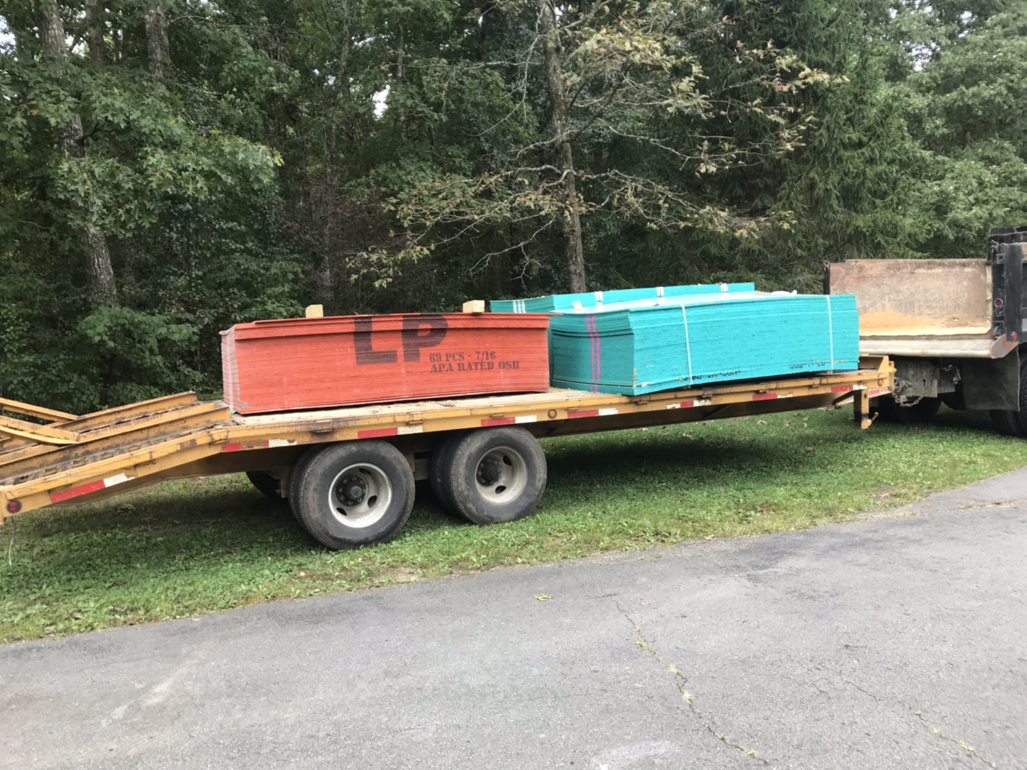

The Kubota TLBs are geared a little slower then the tractor cousins but it’s not really a problem. I hate bush hogging with a loader on and the TLB loaders aren’t removable so that would be a bigger concern for me. But as far as getting the job done there’s no reason a L47 can’t bushhog the field. I loaded these bundles with my M59 and they’re 3700 pounds each. A MX couldn’t come close. I’m pretty sure the M59 is the only one that has a swivel seat like the full size hoes so if you’re doing much backhoe work that would be a big advantage.
