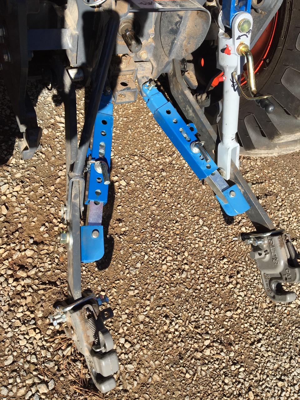

The right Lifting Rod threaded adjustment is primarily for leveling. Too much implement weight + tilt can strip right Lifting Rod threads. (Ask me how I know.)
To tilt an implement move the hair-clip secured pin through the Lower Link into lower paired holes on either the left or right Lifting Rod stirrup. (Left side in PHOTO.) You can see this "bulk" adjusts length of Lifting Rod 4" via stirrup without involving Lifting Rod threads. You can tilt implement either left or right.
Sometimes you have to move pins on both sides in order to get cultivator tines to penetrate ground.
Remember highest stirrup pin holes are the "normal" or default adjustment.
PHOTOS

The male threads on the right lifting rod are progressively less engaged with female threads as the rod lengthens, hence possibility of stripping increases with length. There is a tapered thread-stop inside on the male end warning adjustment is nearing an end. If you continue to lengthen with a cheater male thread portion will eventually come out, obliterating internal female threads in the process.
