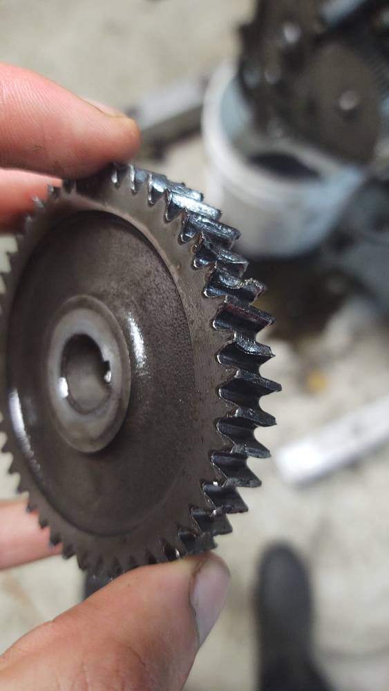

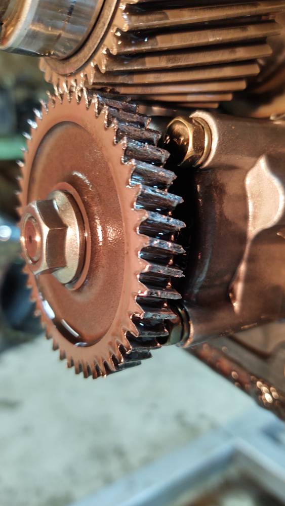

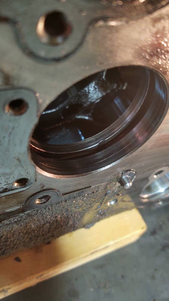

Well, we've found the problem.
Those metal bits were teeth from the oil pump gear, and a few on the crank gear. See pics.
The aluminum shards were the front crank bearing. See pic. It was completely loose. I just pulled it out with a pair of needlenose.
Remember back earlier in this thread I said I thought the crank pulley was vibrating? That's exactly what was happening. And that's why I had to replace the front crank seal.
My theory is that the bearing went bad, which caused the crank to start wobbling, which then damaged the gears. Not sure why the bearing went bad after only 350 hrs...
To me this also explains the knock that wasn't "typical". Every time that front cylinder fired, it applied extra pressure on the crank and knocked that loose bearing around. Also the crank gear teeth are only broken in one spot, so that likely added to the knock.
So next up is to pull the crank and see what kind of damage I have on the shaft.
Thoughts, ideas, recommendations welcome... IMG_20201023_181355159.jpegIMG_20201023_162334812_HDR.jpegIMG_20201023_181421575_HDR.jpegIMG_20201023_181432664_HDR.jpeg

My guess is the oil gallery leading to that front bearing is plugged. You may find that the rod on the #1 cylinder is also fed by that port and has some damage. The good news is that your engine may need a limited number of new parts. Things like the rods and pistons should be fine. I would tear it all the way down and have the block cleaned and then verify that all the oil galleries aren't restricted. Hopefully any plugs that were applied after machining the block can be removed and reinstalled. I know they make brushes for cleaning them out. A bore scope might be worthwhile to check them out.
   / Kubota L4740 Engine "knock" Help? #78
Unfortunately that front bearing spun, most likely the block will need to have that bearing bore oversized (if an oversize bearing is available) or bored and sleeved back to size.
Depending on what other damage there is, a reman short block or used takeout might be in order.
Of course, it had to be the one bearing bore that is integral to the block.

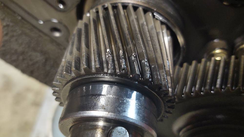

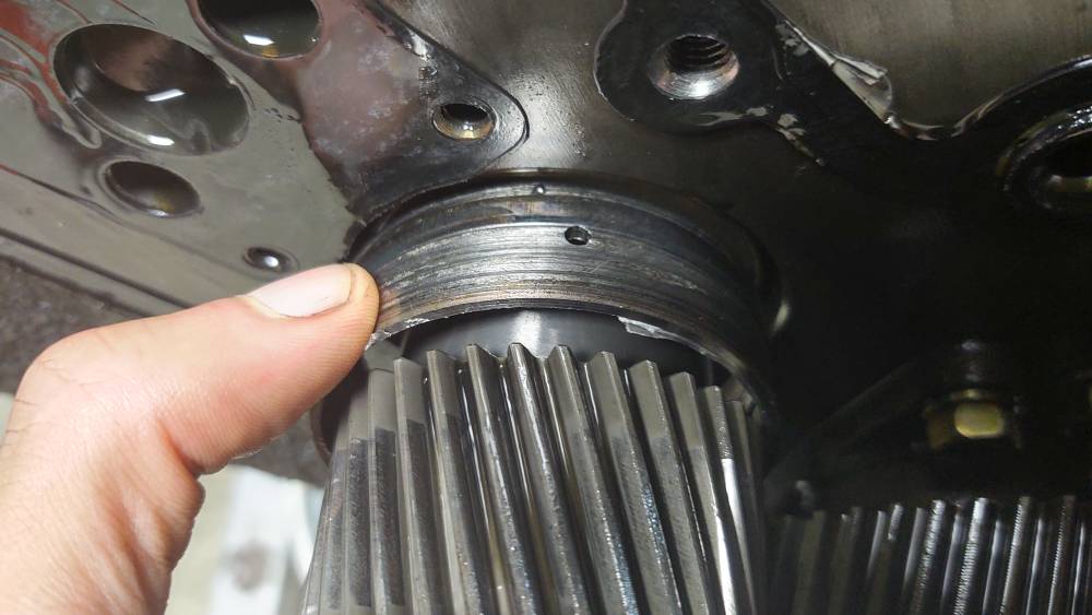

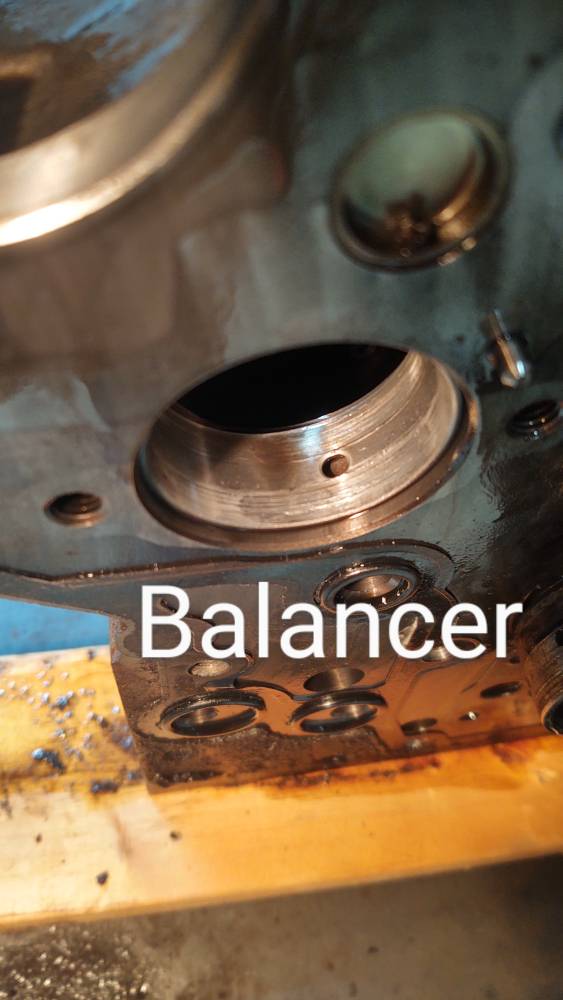

I got the engine tore down completely. The crank actually looks in pretty good shape, but the block is scored bad. See picture. Definitely will need bored.
The left balancer shaft front bearing was also very worn. Not completely spun, but the inside, and the shaft was scored. See pic. Since that's right beside the crank, I'm guessing it's the same oil supply passage? At least that's the theory I'm developing...
Rod bearings on cylinder #1 and 2 also a bit scored, but not bad. Just replacement should be fine on those. Also main crank bearing #2.
Long and short of it is I think at one point there was a significant oil shortage to the front of the engine. Some parts got hit worse than others.
Tomorrow I'll have a chat with the service guy at the Kubota dealer - he's very helpful. He also recommended what he said is "the best" machine shop in the area that he said they send all their work to. So I'll know more tomorrow. I do know Kubota offers oversize bearings, so hopefully that will be enough to fit with needing to bore the block. IMG_20201025_131546447_HDR.jpegIMG_20201025_121505248_HDR~2.jpeg
