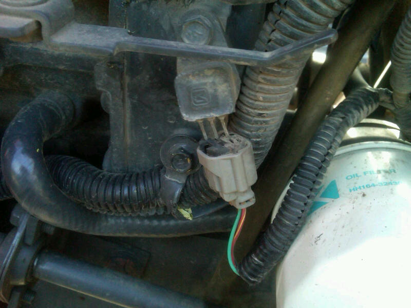

Is it item 50 or 90 in this drawing?
Item: 50
Part Number: T1060-32270 SENSOR,REVOLUTION
Item: 90
Part Number: T1060-18660 SENSOR,REVOLUTION
Or is it shown in this drawing?
Sorry my computer does not like your word file so I can't tell.
It is just ahead of the IP screwed into the block/gear case.
I would check the connection first. I have the service manual for my l5740 I will check it to see what it says.:)

Well after looking again, you have a good ?? there. I do know if one comes without a o ring and the same part comes with a o ring the part# well not be the same. I would think the last 5 numbers would not be that far apart. Maybe there is 2, one for the tach and one for the stall guard. One of us well have to check our tractor, I'm checking, just for my own info.

Found the problem!!! The electrical connection came unplugged. I cleaned, plugged it back in and the code went away and the tach started working again!
I appreciate all the help. This forum is great!

You got to love an easy fix!

Glad you found the problem and thanks for letting us know. One thing though, you never mentioned the tach was not working. You only mentioned the error code and said everything else was functioning. You had me a little confused about the problem. :thumbsup:

Sorry about that. I didn't notice the tach not working until I checked it this morning.
